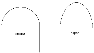

You might also want to try different shapes for the flare. I think they prefer elliptic vent flares over circular in industrial pipelines.

Later though, other shapes could be looked at such as Goodguys suggestion of elliptic cross section, and exponential flare profiles - any thoughts there?

I think the difference between flare profiles would be subtle, although I can see some benefit. As sound pressure moves out of the vent, there is inertia which restricts it from moving outward (normal to the length of the port). What you are trying to avoid is those nasty eddy currents that form when the fast moving wave moves past still air. Hence if you extend the flare out more along following the direction of the port, this gives the wave more chance to follow the profile around and "spread out" without separating. Very high velocity air has more inertia and tends to "shoot straight out" the port. This is the problem. If you can get the wave to exaxtly follow the flare profile there will be no eddy currents, no turbulence and if you can achieve this then the vent velocity is irrelevant. In practice there are limits.
The problem with elliptical flares is that they make the vent longer.

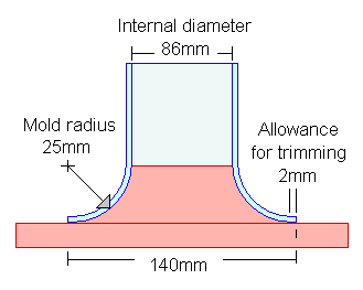

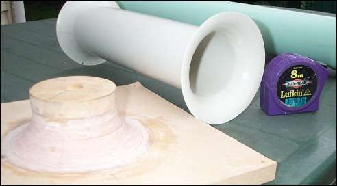

I finally got a chance to try some flares.
I used the same method as shown in the link Paul posted - A mold made from mdf rings of different sizes, covered with car body-filler and smothed with a circular scraper. The PVC pipe is heated and pushed onto the mold to form a flare.
My initial observations:
Using 90mm downpipe with a 2mm wall thickness, the best I could mange was a flare radius equivalent to 25mm.
The target was 36mm - the size the mold was designed for - but two factors limit how far you can go.
Firstly, the PVC will split at the outside edge. Taking care to evenly heat the edge can help a bit.
Secondly, the pipe will buckle futher up its length. This can be reduced by heating the pipe while it is actually on the former, but eventually the buckle happens.
After making a few test runs, I settled on an overall diameter for the flare of 140mm, which was achievable.
The next phase will be to produce a mold of 23mm so I can get a flare that will sit flat againts the box. Factoring in the wall thickness, this will mean the air will "see" a flare of 25mm.
Cleaning up the edge by 2mm with a circle jig will give a port mounting diameter of 136mm
After that, I will see how far 100mm sewer pipe (wall thickness 3.5mm) can be pushed.
