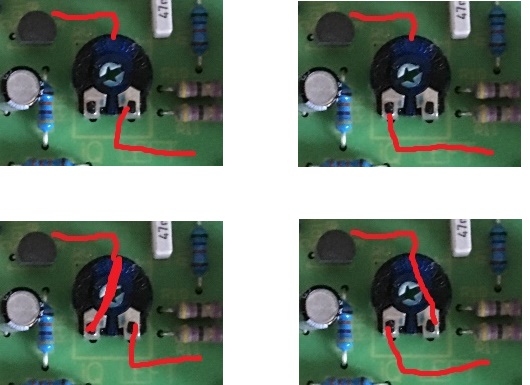

To get the preset at the correct end just put your meter on ohms and measure between B and E of Q15. You want the preset turned to the end that gives the highest resistance. Swap the leads around and just check that the result is the same even though the actual readings will differ wildly.
2.3mv is a current of 20 milliamps which is obviously its target value. Theory and practice offer differ in commercial designs due to constraints of heat sinking and ensuring cool running and so on.
just checked Q15 and circuit tracks, from the picture pov Bottom left leg and middle leg connected and go up B of Q15, bottom right to E of Q15 and did continuity test and verify this.

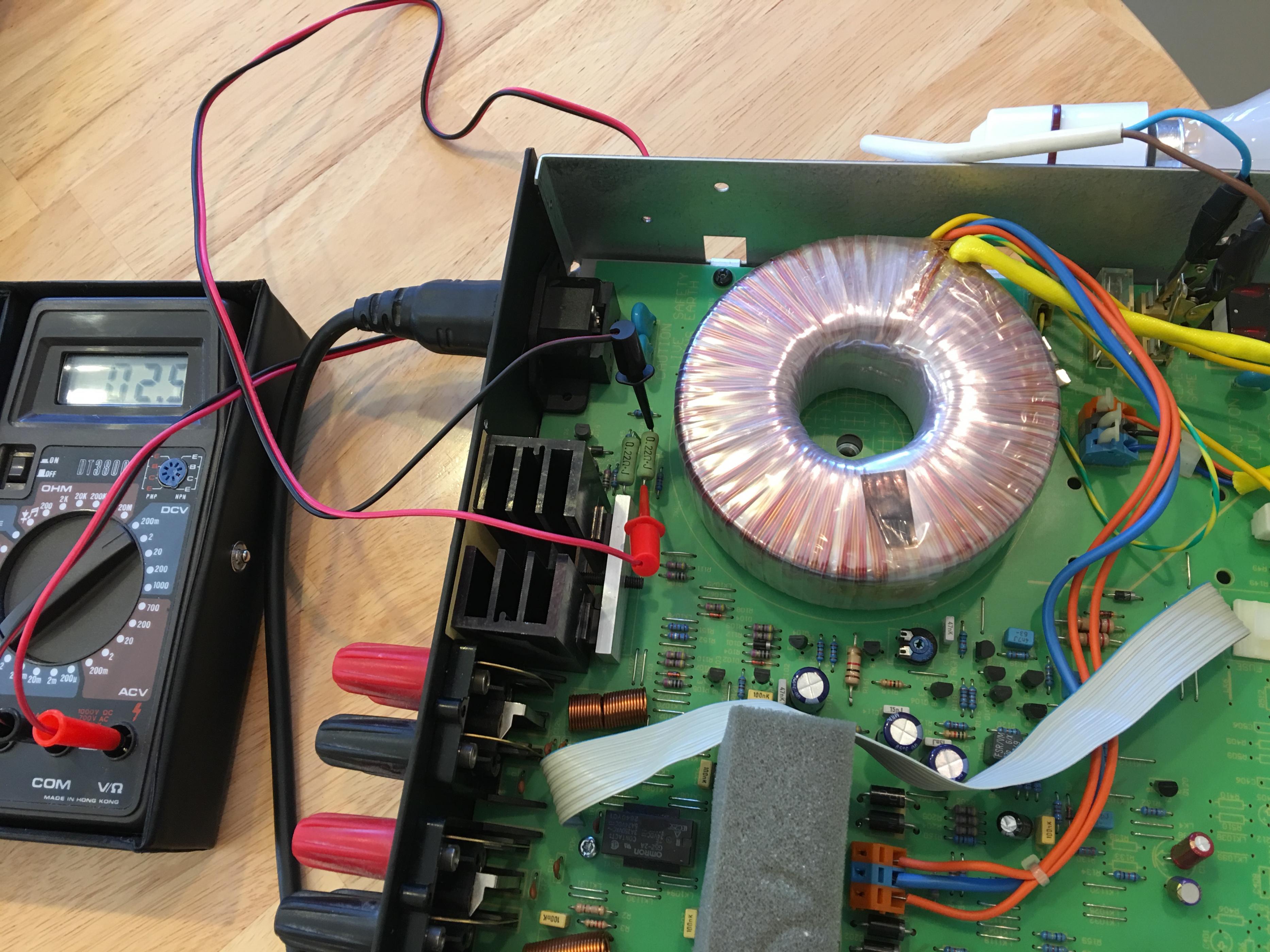

Have completed the work on the Alpha 8P, took it very carefully. Did the bias checks, first setting the resistance across Q15's B & E to an approx 10K having removed the short across it first. Tested and let the Amp settle for 5 mins (no load) at 2.5mV across R1, did the same procedure RH stage and for R101.
Replaced the bulb with a the correct fuse and retested both R1 and R101, everything looked good, left it like that for 5 mins and did final DMM checks. Fitted the case and have tested the Amp at low volume output and all is working as expected. I will be gentle to the Amp for a few more days running it up for couple of hrs at the time.
Many thanks for your great help !!!, can not thank you enough as I was about to give up with this Amp. I feel I have come to know my Alpha 8P a whole lot better !! However I do wonder why the diode failed in the first place?
For those interested here is a picture of the Amp with bulb in place and testing R101 with DMM for bias set up of the RH stage before full mains testing.

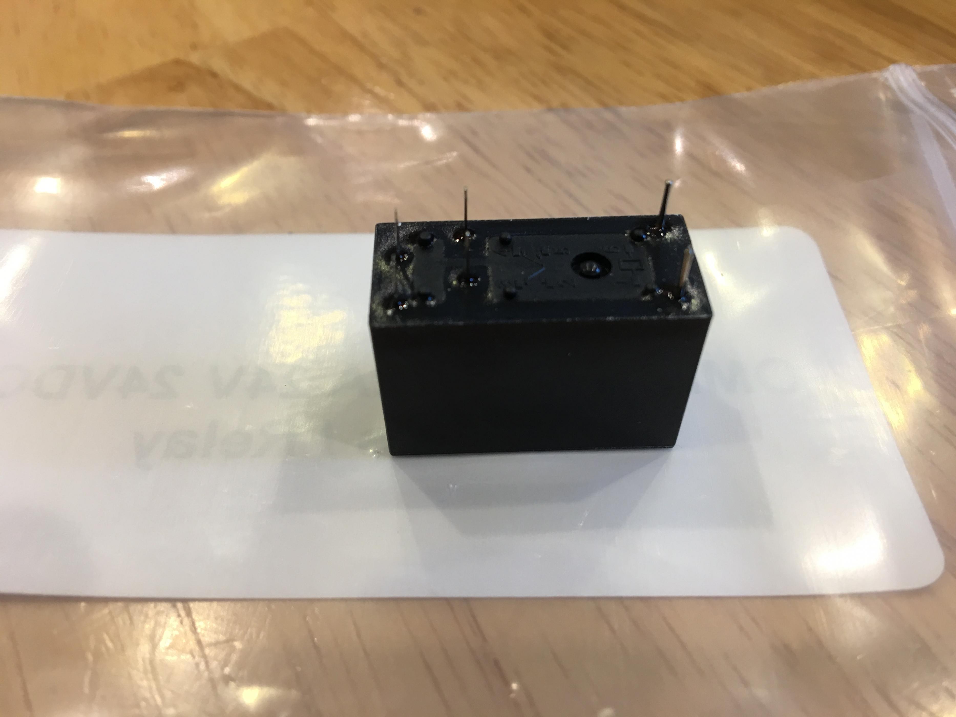

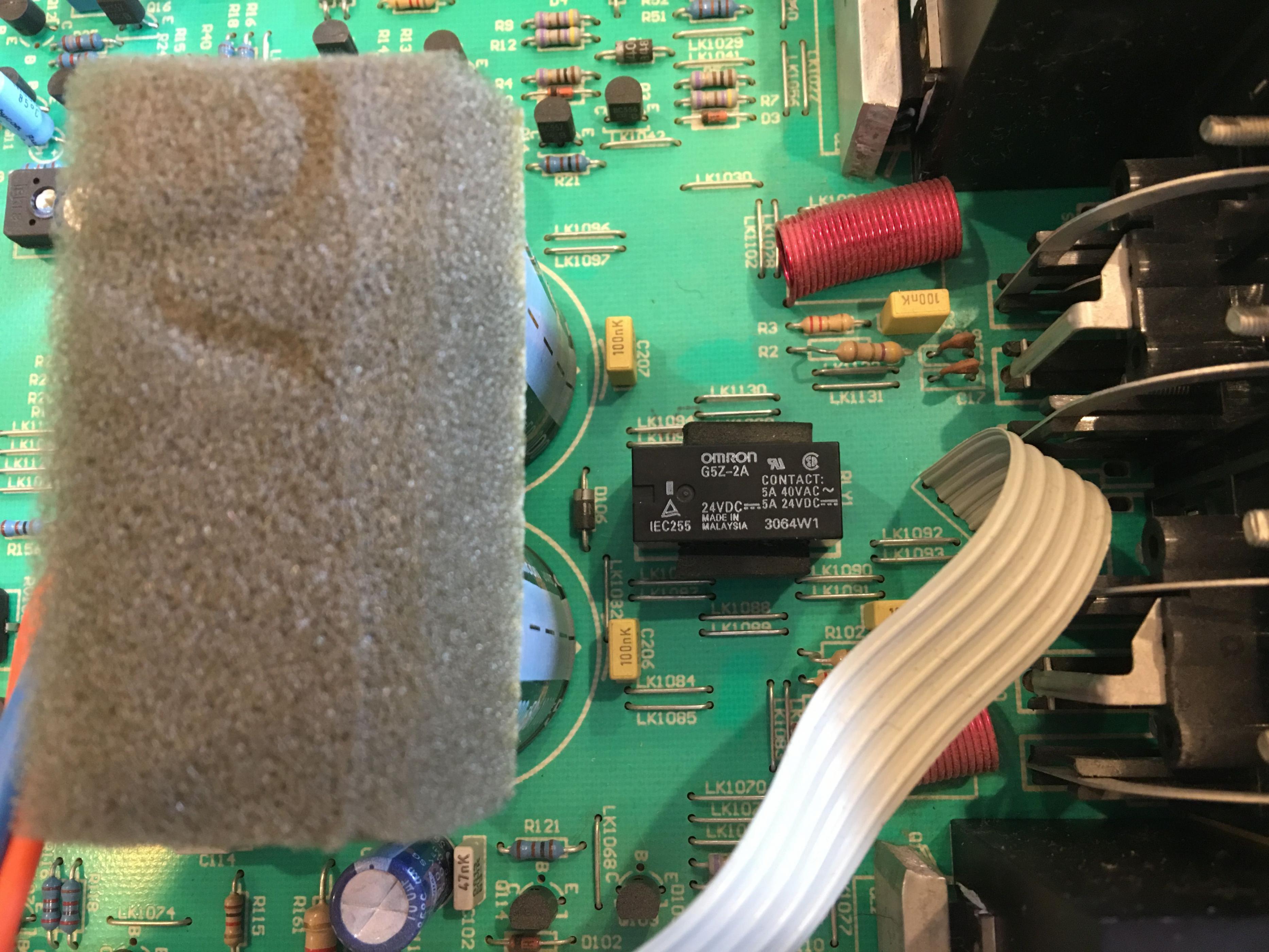

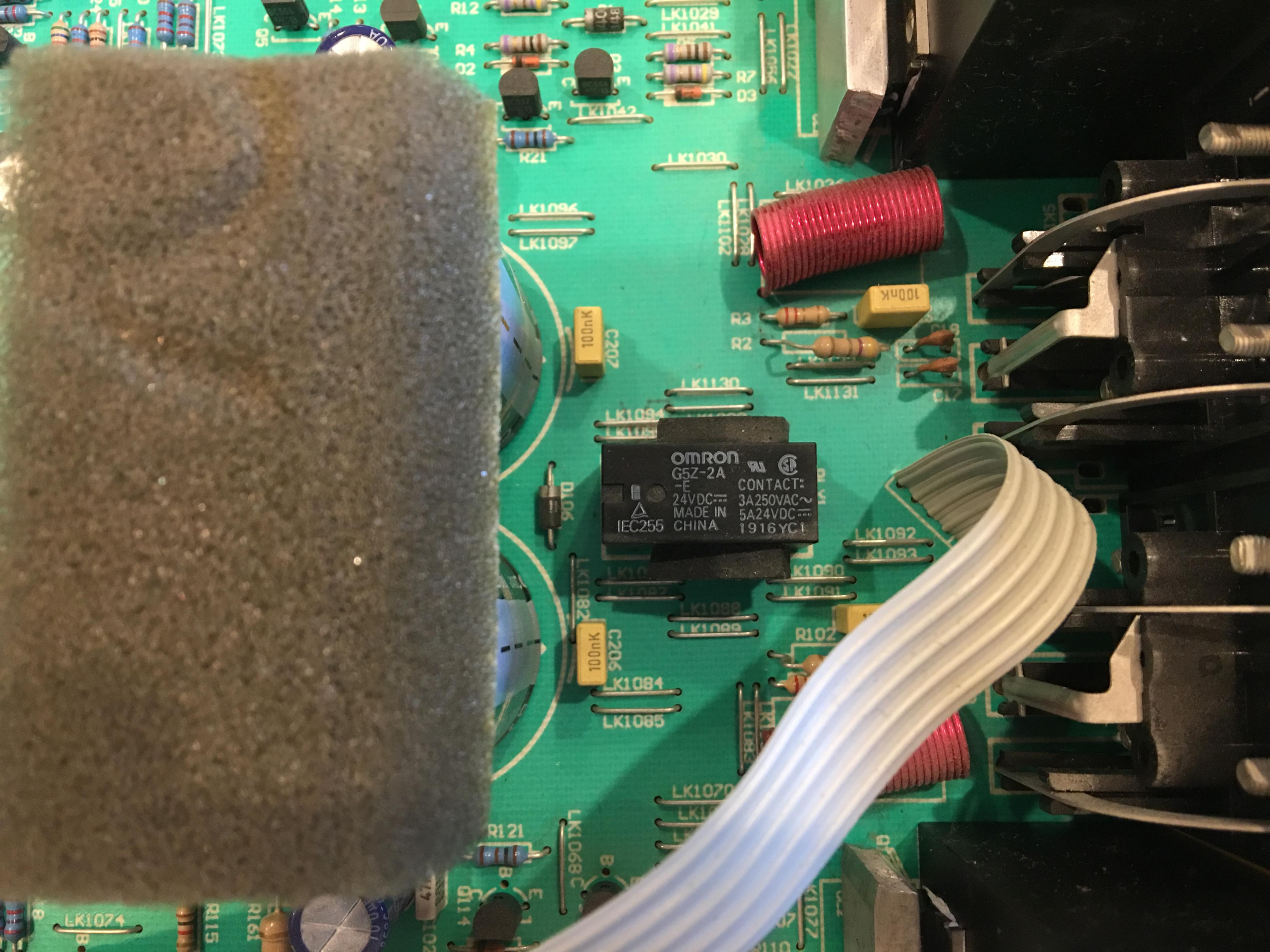

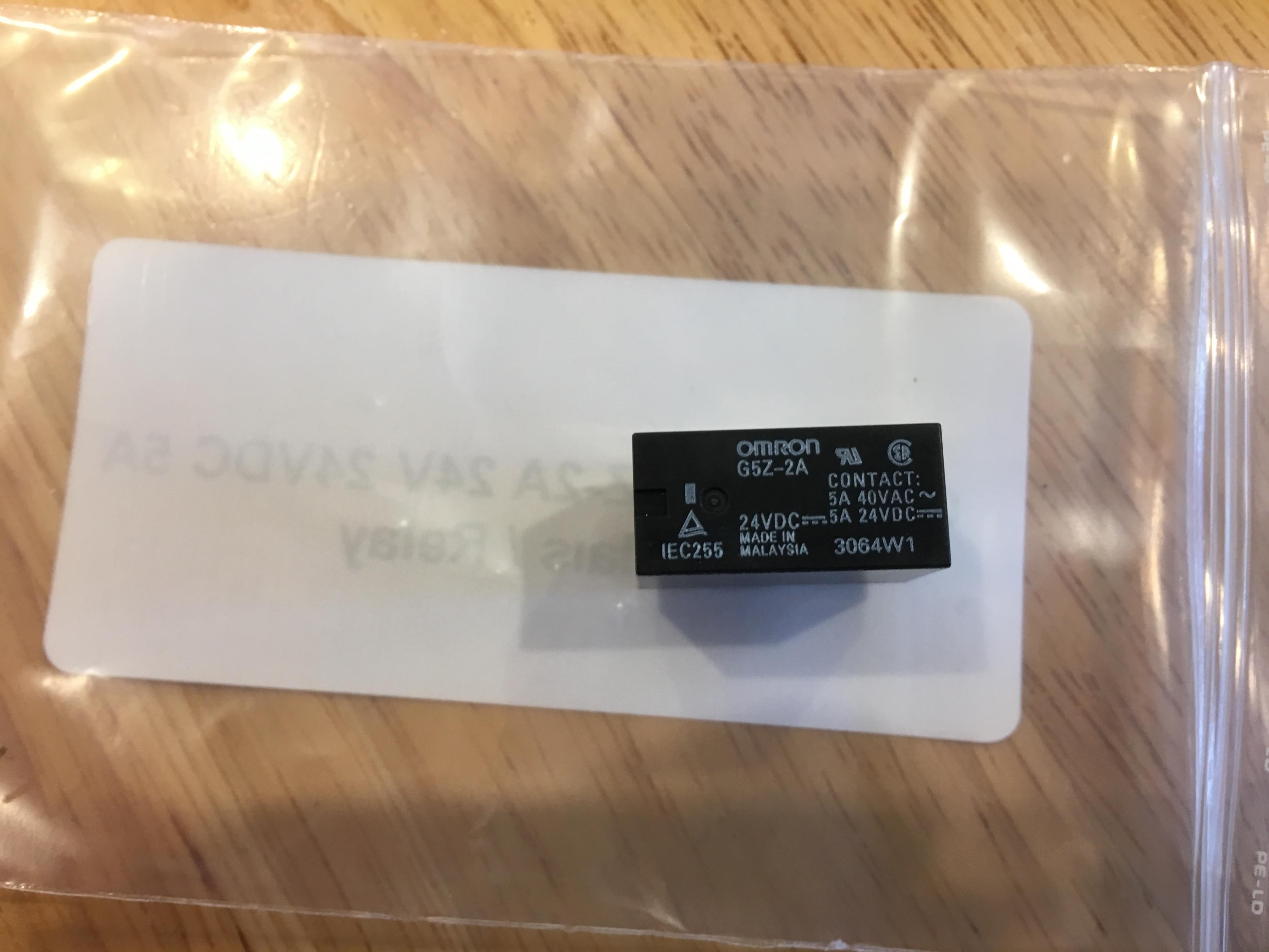

Hi Ian and Mooly,
It was some while ago I posted on the issue of the LH speaker not coming up when the relay clicked, reason being is the Alpha 7 has been working OK since I posted until 1 wk ago when the issue returned.
I did speak to ARCAM support about sourcing a replacement part as this relay is obsolete but without success as they were unwilling to recommend a replacement part due to Health and Safety of self repair (?!) and insisted I contact one of their recommended repairers (I did not take them up on this offer). But I did research the web at the time to see if this part is still stocked by someone, it was so ordered the part new.
Yesterday evening I replaced the relay and can report that both speakers are working again. Looking at the failed relay it is a sealed unit so no way to remove the cover without breaking the casing. So cleaning the contacts is not a viable option.
I enclose some pictures of the part and the before/after of new relay replacement.
Hope this helps others.
Thanks for your help guys.

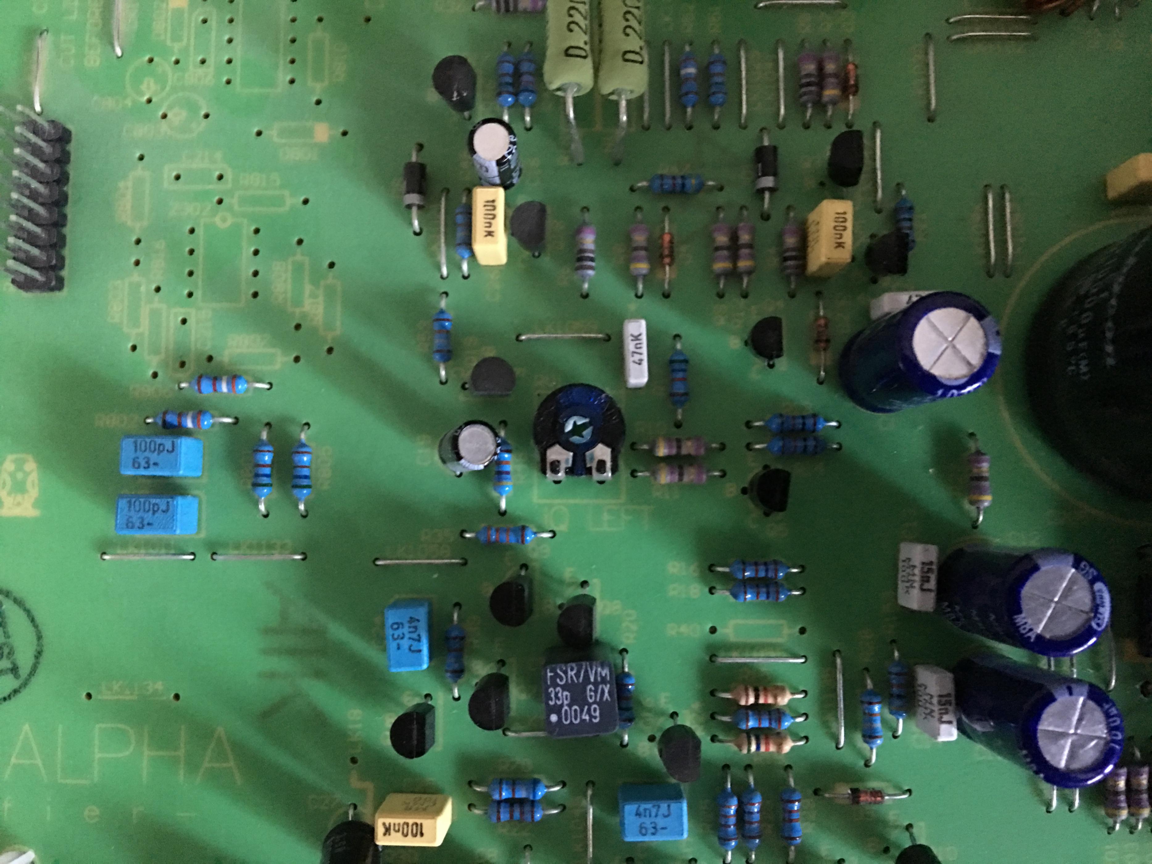

Got this from a dude who after putting in new caps gave up on it.
2 big Mundorfs, 6 Tonerex and the Elna Silmic marked with green. Elnas are all 25v 100uf, I can´t confirm if they are all correct. Scematic is listed as 7r and this is a 8p poweramp. There are 3 rubycon 10ufs still sitting, originals I presume.
Started it up, amber light, relay click and no green light. It stayed amber. Procedeed to set bias when the fuse blew, repeated and it blew immediately on startup again.
MOSFETS at Q1,2 measured strange so I removed them and ordered new ones.
LK between Q1 and R1 was burnt black so there´s another clue as what up; marked red in pic 1 and a closer look in pic 2. I cleaned it up though
Unsure about measuring the transistors, I have new ones around though. Except that 2240 one at Q120
So yeah, maybe you guys have some tips, I am very much a beginner at this.
