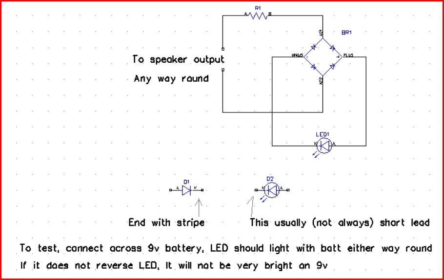

Dare you try it with speaker, just to make sure it is O.K. You might hear crossover distortion with no bias but thats fine. Then rig up the LED's and go through the set up again, don't leave it unattended keep watching that current. Another thought, the bulb is needed at first really, it can save problems, but it will drop the mains voltage a bit even if appears not lit, and when you put full mains back the current in the outputs will increase again. Just something to watch.
I intend to reserve a few hours to try to sit down and work through this as methodically as I can - the quick test may have pointed at the RV problem, but unfortunately not.
Let me make up that IEC cable with the light in series with it, and the LEDs... and away I can go with a bit more safety and ease.

Further thought's, but first, are you O.K. unsoldering components using braid ? Don't try and wiggle them out while heating. And pull the plug out as well. Earthed amp, earthed iron, charged up caps-BANG or unnoticed damage to a transistor
Right, we know the quiescent current set by RV1 was much to high- 90mv I think you said across RV41/2. Now we don't know for sure if this is the only problem, it may or may not be ! Setting RV1 on minimum should allow the outputs to run cold. The LED's will show if a fault still occurrs, and, if it does, it seems the setting of RV1 while incorrect was a red herring. The outputs should stay cold even under fault condition provided no load is connected. Did you swap the FET, if you have you need two sets of LED monitors, one on each channel. Cheapskate method follows , one monitor between both positive speaker outputs (remember to replace fuse). This will show fault has occured but not on which channel.
To help show up the fault can you heat the PCB with a hairdryer while it is on and see if this causes fault, in particular those transistors I mentioned. If you can get it in it's faulty state measure and note voltages on Q7 and Q8 collectors, then measure base/ emmiter volt drops on those drivers first, then others. Any over 0.7/8 ish are faulty.

Leave the FET then, let's try and be sure and get it in it's faulty state. Any diodes OK (IN4001) , a separate bridge is less messy to wire up . Worth trying braid, you need a good hot iron with a decent sized poker on the end (it's much easier working with a large bit on stuff like this) and well tinned, just lay braid over component, and apply iron, the solder will instantly flow to the braid and the part will lift cleanly out. Million time better than a sucker.
And try the hairdryer, it's a recognised technique, it works.

Thanks for that. That's pretty much what I thought, although I would have put the resistor on the other side of the bridge. Makes more sense where you have it though, to limit the current through the bridge itself.
And yes, a 9V battery directly to an LED isn't a great idea. A typical LED is 3V or 5V max operating voltage usually, as far as I remember.

Ah yes.. 1N4001 is the number I was thinking of.

Had some time to play with this this evening...
Wired up the 60W lamp again, switched amp on, tested speaker outputs. After a while, it went into the faulty state and measured -36.1V on the output. Great.
Left multimeter probes connected to the output - twiddled RV1 from max to min - not a jot of difference. Still -36.1V on the output.
Measured the voltage on the collector of Q7 and Q8, which was -37.1V (yes, slightly lower than the output on the speaker - I double-checked that).
Haven't got the b/e voltage drops again yet - the amp has reverted to it's non-faulty state before I got to testing those. Had the hairdryer on it, but no luck yet - it hasn't reverted to the faulty state yet.
