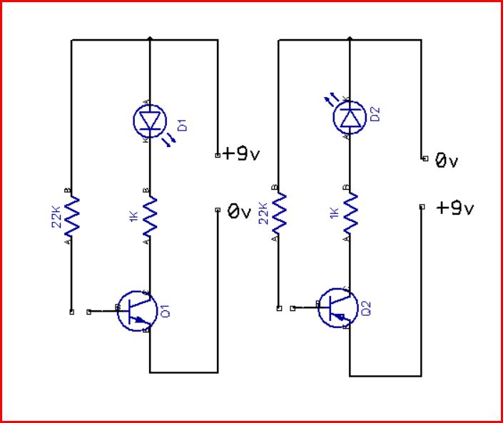

This is going to be a bit of an anti-climax I think. I tend to take nothing on trust, and it's nice to be able to identify an unknown part connection wise. Data sheets are fine 95% of the time, but I have come across replacement parts with different pin outs to the originals on rare occasions (still the same type no).
So, meters first, I take it it's a digital meter your using. You know, you just can't beat an AVO 8 for checking transistors, the 15 volt battery showed up leaky parts that DVM's fail to show. Back to the DVM, when you put it on diode test, the meter lets a small current flow through the test leads and the meter actually shows the volt drop across the meter leads which in this case is the semiconductor junction you are measuring. So you measure a diode and it show 645, thats 645 mv, about right for a silicon junction, with the leads reversed the reading will be whatever that particular meter happens to show with nothing connected to the test leads. Mine shows 3154 which just means the voltage at the probes is 3.154 volts. The red lead is also the "positve" potential of the test current. (AVO's and many other analogue meters are the reverse).
So we have a 3 legged thing on the bench which we need to identify. With our meter on diode test we need to find the leg that, when we connect one of our meter leads to it, it reads as a diode (the 650mv drop) to each of the others. If the "common" lead is the red one it is an N.P.N if the black is the common, it is P.N.P. and this commom connection is the Base. So far so good, but how do you identify the emmiter and collector ? A PP3, a couple of resistors and an LED is as good as anything, and if the transistor were slightly leakey it shows up.
So here it is, the LED is unlit until you touch the 22k resistor to the base. If the device is leakey the LED will glow with no base current. Note the polarity of the battery and LED for PNP.

That does look like a pretty simple test for the transistors, Mooly - probably slightly more complex than I first imagined, but still pretty simple.
