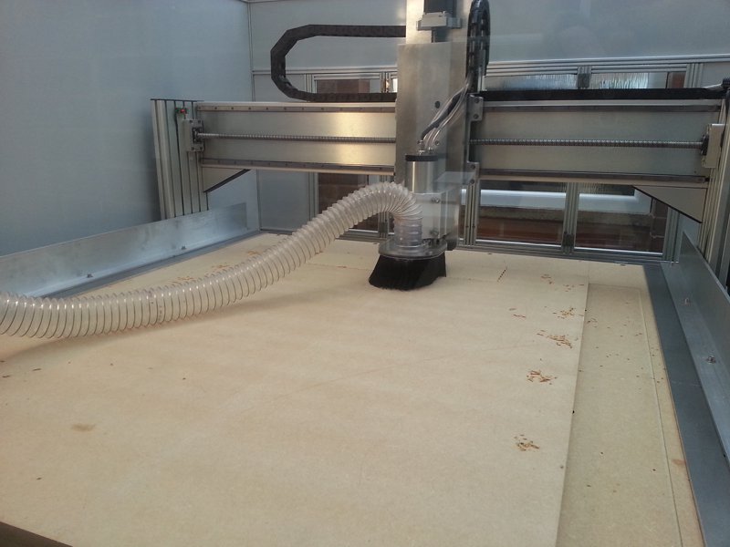

'tis a lot of dust though, no?
I still think the better idea is a continuous stream(s) of compressed air at the bit/work area scattering the debris to the edges of the work surface (..with a vacuum pick-up from there). And though speculative, I'd still imagine that compressed air streams would cool the bit (a "bit") and prolong bit-life. (..again, similar to what heavy industry machines use with liquid for metal milling.)
My understanding is that the chips created by the cutter actually take away a fair bit of heat (which is why you want to create chips rather than dust). However, I have seen compressed air used to clear debris and cool a cutter - especially for hobbist metal mills where liquid jets aren't practical.

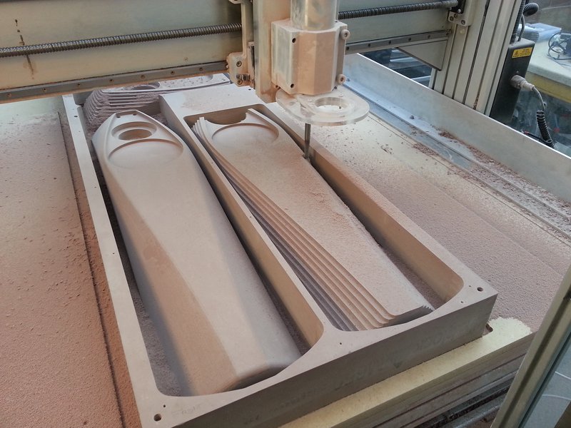

That's the ramping moves I think your talking about. I've started playing around with helical and angular Z entry and it works a bit differently to straight plunging. I didn't realise that these are vector based and so you have to set your feed rate higher to get the speed as if you were straight up plunging. That wasn't what burned the cutters though. I'll explain more about that later in this post!
That 105mm cutter is a monster. I'll bet the deflection problems were interesting.
Yup. In my initial set of toolpaths I naively thought using the long cutting to get through the whole material was a great idea - save time changing bits, keeps the code simple and smaller. Wrong! You really only wanted to be doing the bare minimum with those massive cutters, just the parts where only they can reach. Anything else, use something smaller! In the end I broke it up into three tool lengths, one at 40mm another at 75mm and the 105mm. That worked but for the profile around each part there simply wasn't enough room to clear the chips when that valley got deep and it start burning cutters within minutes due to massive rubbing and recutting of chips. In the end I had to flip the part over and come at it with the 40mm cutter from both sides leaving only 20mm right in the middle for the long cutter to get at.
In hindsight there would be a couple of things I'd do differently. The most important being to size the stock to just over the size of the part and that'd do away with the deep profile problem I had. I didn't have the most optimised g-code ever either and was running back and forth between the PC making iterations to the code whilst cutting.

Rear side took the longest and that's simply because that was the side I did first and bumped into all the problems there. By the time I'd flipped it over onto the front I'd got it figured out and things went like clockwork.
So for the rear side it was an entire day but only a couple of those hours were spent cutting. The rest was head scratching and making changes. The front side was 6 hours from start to finish including tool changes and pausing the machine occasionally to vacuum the chips.
If I did it again I think I could have it done within 8 hours quite easily, probably less because I was on the conservative side with speeds. I'll be doing some more two sided parts in the future such as wave guides but I want to make a permanent jig setup for those as its something I need to be able to do over and over rather than just a one off like these.
Yeah, it's just a guess on my part.
I've not heard of debris sinking heat before.. seems strange to me. I tend to think of it causing added friction (with resulting heat) where it might contact during a pass-through or cause dust to pile-up during cutting.

It does happen. The flutes on the cutter heat as they slice away a chip out of material but because the chip is in full contact with the knife on the flute then some of that heat is transferred into it.
The effect is at its best in metals since they have a much higher thermal conductivity than wood and plastics etc. But I can attest that when you have you have your speed and rpm set correctly in wood and your making chips and not dust then if you pick up freshly cut chips they're warm.

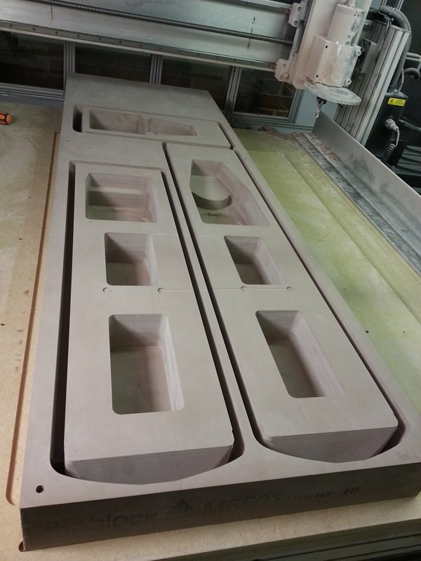

Here's the pics.

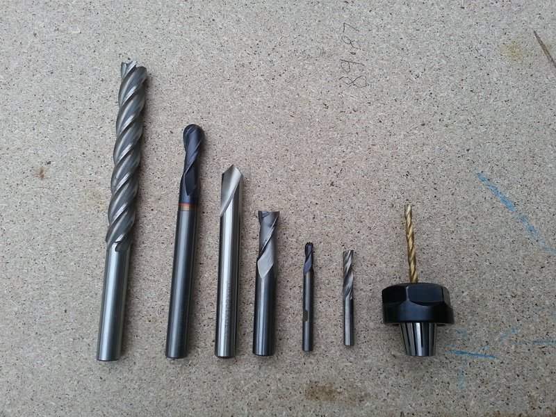

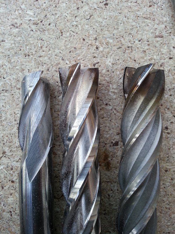

Cutters used for this job

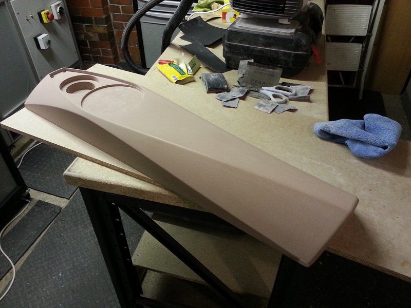

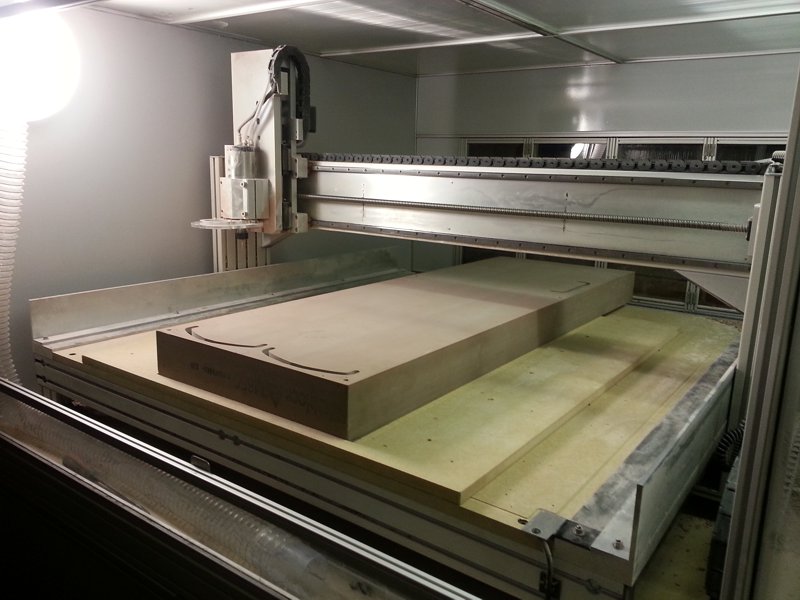

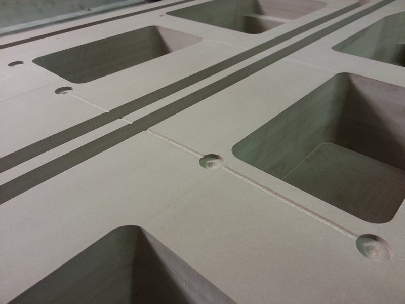

Levelling the sacrificial board flat and cutting reference edges and dowel holes used when flipping the block over.

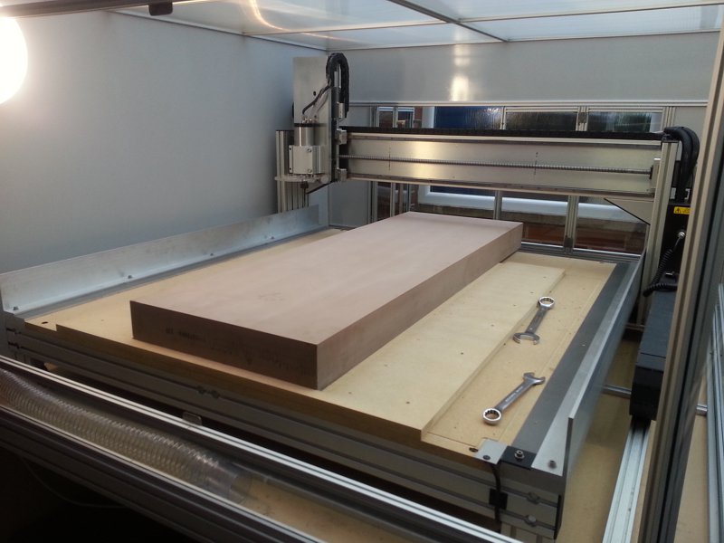

Modelling board in place. Not easy picking this up by yourself!

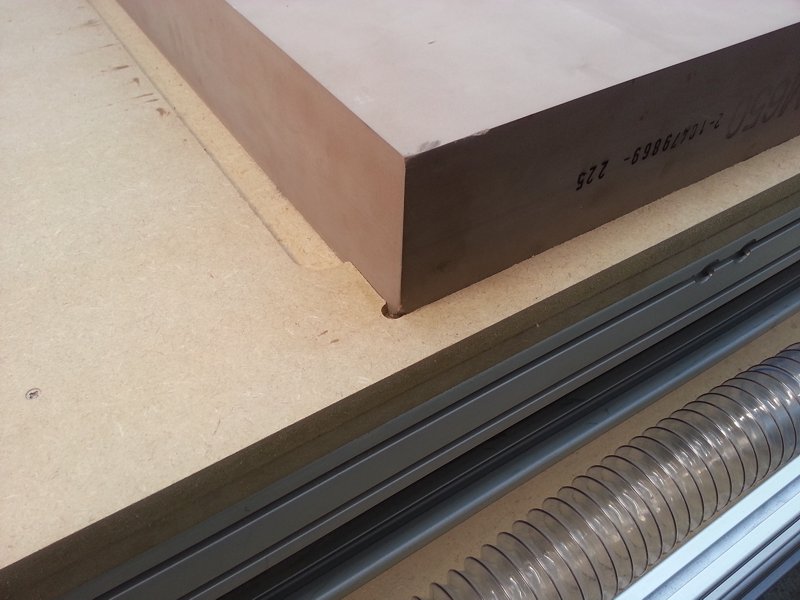

Reference edges used for alignment(parallel to the X and Y axis)

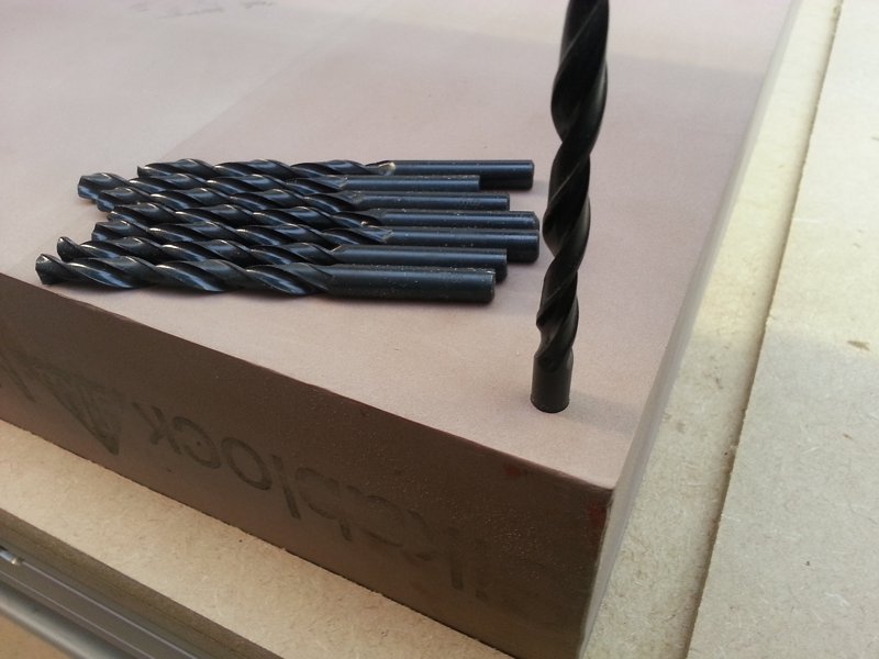

I bought a pack of cheap drill bits, used one of them to cut the dowel holes and then cut the rest down to serve as the dowels.

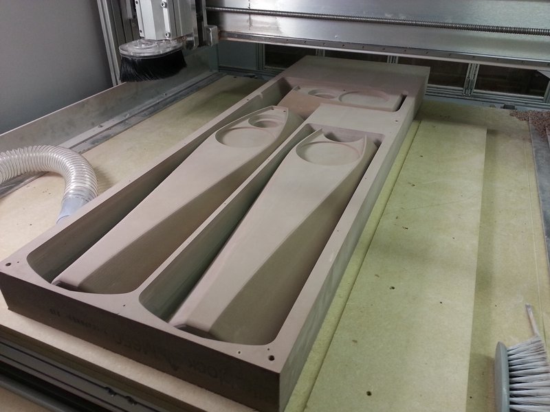

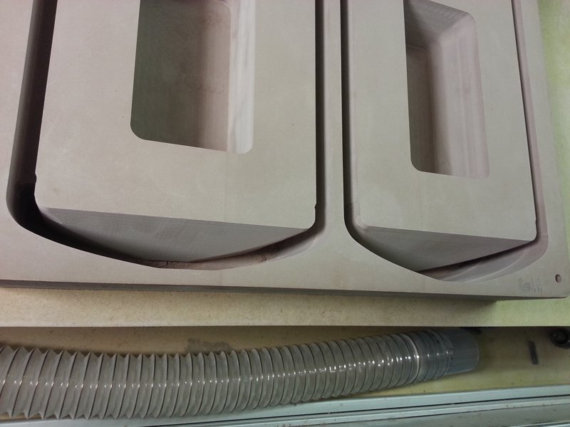

Rear side complete.
Shot showing the bottom of the baffles from the rear

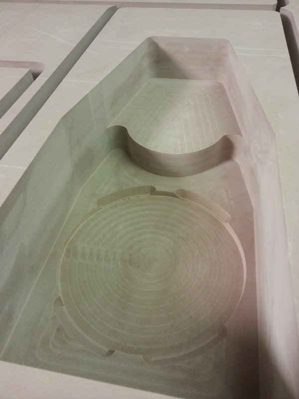

Rear of driver details
The only bit that didn't go to plan. I entered the clearance height wrong on a drilling operation. Luckily didn't snap my expensive drill bit! Did scar the baffles though but since these are used for the mould I can go ahead and fill/sand.

Flipped over and ready to do the fronts
Machining the fronts
Front side complete

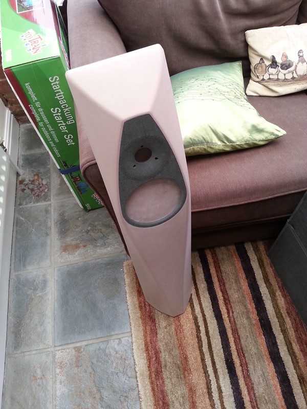

Here's a shot showing the superiority of carbide vs. highspeed steel. These stay sharp, don't blunt and overheat.

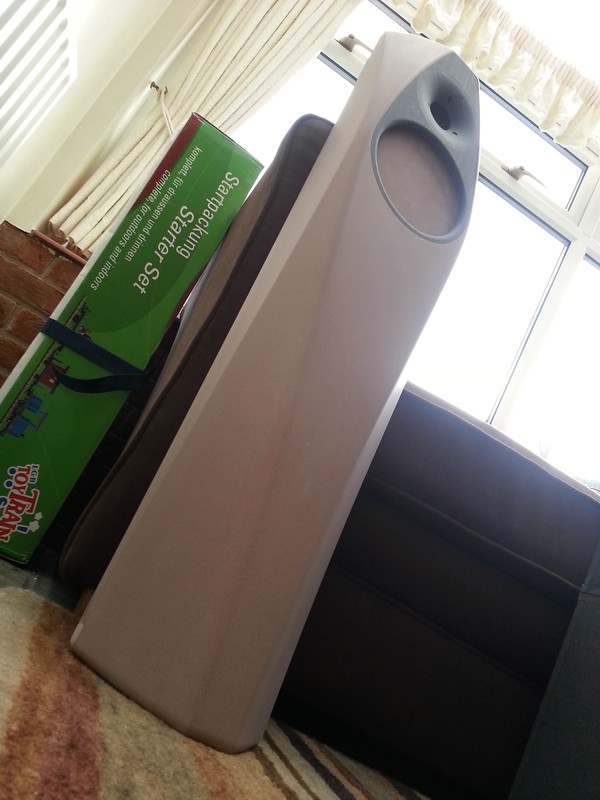

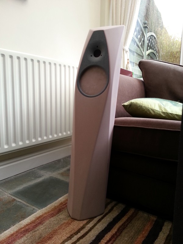

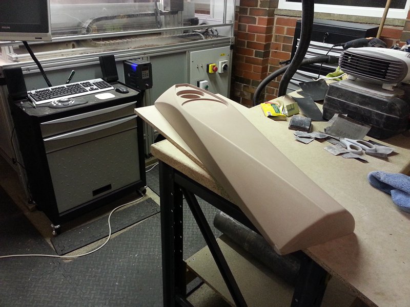

The finished article after some light sanding to remove tooling marks.

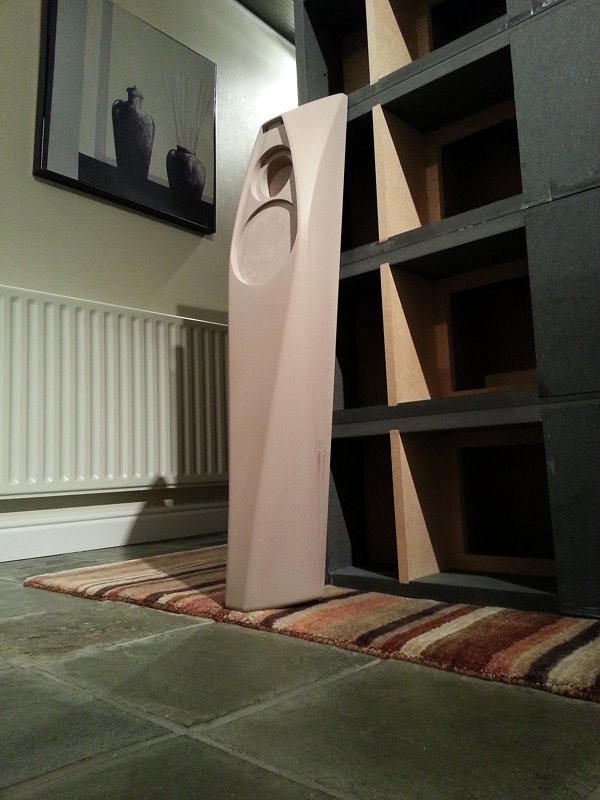

And against a stack of Apollo cabinets for scale

Agreed on the long cutters - you really have to be careful with them and go pretty light.

Ant - when I read the image title "The finished article after some light sanding to remove tooling marks" I can't help thinking if I'd done that the caption would've read "The finished article after some light sanding to remove tooling marks oh b*ll*cks I've dropped it"
Lol! I did whack it.
Dinged the bottom corner against the workbench whilst lifting it on. I filled the small dent with filler which you can see in the photo's. I won't repeat what I said at the time.
