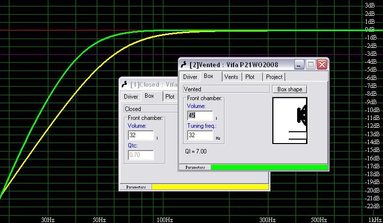

I'd guess with any ribbon hybrid you are going to think the cone
drivers are rubbish and "why didn't they use a better driver".
The crossover schematic shown does not make a great deal of sense.
The Vifa is not a poor driver.
http://www.partsexpress.com/pe/showdetl.cfm?&Partnumber=297-310
It is designed to be reflexed, but this depends on the
Centaur internal volume whether this would work well.
As it stands you are looking at a light cone (for an 8") bass / mid,
around 91 dB sensistivity, with no midband peaking, equivalent
parameters suitable for said box.
Not many of the above around now, most would have been paper drivers.
The Scanspeaks are not suitable. Audax aerogels ?
or possibly - chucking money at it : (very low distortion driver)
http://seas.no/PDF data excel 05-06/W22NY001E0045.pdf
Need to add a port for the above.
:)/sreten.
(Shown are alignments for the Vifa)
Seems the Centaur Major only has around 30L internal volume,
the Minor has 16L so presumably we are looking at in between,
I'm guessing 22L, q=0.8 which is a fairly workable alignment.
For an 8" you are looking at a sealed box, basically too low for venting.
Really it seems on paper the original woofers are the best choice.
But it seems they are not liked by owners .....
So you could try similar Audax Aerogel or Seas paper drivers.
But given around 91dB 8 ohm driver and 20L good low bass is not going to be possible.
If anything Id go for a lower Q alignment and add stereo subwoofers for the low bass.
(This could be one amplifier but two boxes)
However ......
If you are prepared to bi-amplify with say double the power in the bass and
adjust amplifier gains to suit then a lower sensitivity driver could be used,
with better bass, but then single amplifier working would not work well.
:)/sreten.
