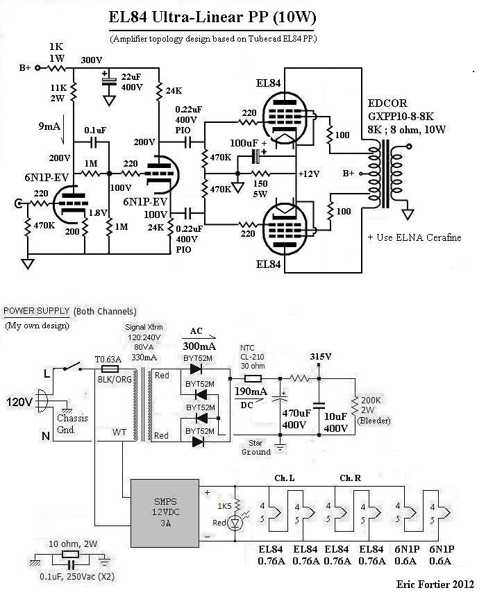

Sorry to open an old thread but from the comments this sounds like a great simple amp to build. I have built many SE and SET but this will be my first PP.
I had a question regarding the bias current for the concertina...
For the first stage using the 6N1P-EV, I really enjoy the sound (from a SE amp) when the cathode bias is set to 9mA (Vplate of 200V, Vk of 1.8V using Rk of 200 ohm) how about the concertina Ra and Rk values..., do the concertina has to be bias at a certain value in order to optimise it ? My biggest concern is : will the overall sound be different if I choose 4-5mA vs 9mA in the concertina section ?
Please verify my proposed value. Feel free to comments of the overall schematics before I start punching holes..

Looks OK, I went with the 30K plate load for both sections and Rk and it works good for other tubes like 6cg7 and 6dj8, although 6n1p is my favorite.
150ohm on the EL84 cathodes seems a little "hot"
I would also suggest a couple mods
1. Balance pot on the EL84's (10-25 ohm depends how well matched your tubes are)
2. CCS on the EL84 cathodes
3. Red LED on the front section of the input tube.
Cheap red LED for cathode bias, and a current source for the load. Make the current source adjustable with a pot, and you can tinker with distortion vs cathode to anode voltage.
My experience with the 6N1P-EV is that it produces the least distortion at about 105V anode to cathode. Since that is about the voltage you are shooting for at the grid of the second triode, direct connect them without a divider. Better frequency response.
