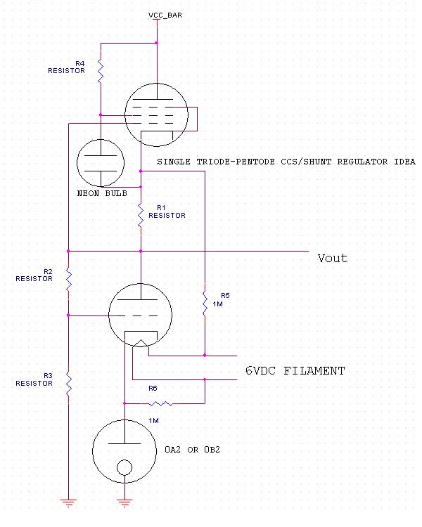

all tube ccs/shunt regulator
I was thinkulating about the subject of combining ccs/shunt regulators, and wondered why it couldn't be done with all tubes. There's plenty of unwanted miniature triode-pentodes that might work fine for this application when combined with a voltage reference tube, as shown in the conceptual schematic I attached. The OA2 or OB2 and 1M safety resistors minimize and equalize the filament/cathode potentials to allow regulated voltages of up to over 300V safely. Some standard measures may be helpful to reduce any noise from voltage reference elements.
Btw, that grid #2 bias sort of hurts the CCS regulation, but there's compactrons out there that have a second triode which can be used as a follower or used inverting tapped off the existing triode grid divider, possibly ditching the neon bulb in the process, in a scheme to separately sink that current path:) The latter scheme may even allow a trim adjustment to maximize the CCS impedance; just thoughtubrating here.
Btw, it's surprising what can be accomplished with a couple of trim circuits. I have designed a more conventional series pass tube regulator using a single miniature dual element triode and 0A2 that, with fixed resistive compensation & a simple potentiometer trim circuit to optimize input noise rejection, has over 60db of AC input noise rejection and about a 10 ohm output impedance.

all tube ccs/shunt tube regulator
Hi Thoriated,
I can vouch that your conceptual circuit will work quite well, because with the exception of a very large zener instead of the gas tube and some other trivial differences I used just about this topology in one of my early pre-amplifier designs. (About 1990)
Unlike many here I am not convinced that it is inherently superior to any other well executed and designed topologies, however I do prefer all tube implementations for a variety of reasons including robustness in the face of line transients, tube failures, and the like. (Sound quality as well.)
I will note that my target was not really minimal reactance at all, but for some reason at the time I thought a supply with reasonable source/sink capabilities might just sound better. It worked well with very small amounts of capacitance, but I was in a phase where I liked and used lots of capacitance, that it didn't make any difference to the performance of the powered circuit as long as good small film cap remained on the output was an indication of its good performance.
Note that I never adequately proved my conjecture that this topology was any better than a really good tube based series pass regulator in class a applications.
