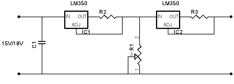

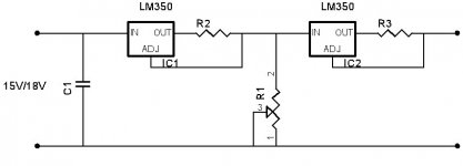

Hi All,
I encourage anybody who builds a minimal reactance psu (or any other CCS - shunt reg - CCS psu for that matter) to try a shunt where the AC duties are carried out by the tube element (the AC output is fed back to the tube grid via a capacitor). See http://www.tubecad.com/july99/page13.html for details.
I found this to be a rather large improvement on the topology with the TL431 carrying out AC duties, which sounded somewhat congested and overly 'tight' rather like a high nfb amp.
Use a really good cap for the AC feedback (say Auricap or better) and cathode bypass (Black gate was best by a mile here I'm sorry to say), and you may get quite a surprise.
CCS - shunt - CCS has been around for a while, being championed recently by Gary Pimm in his designs. The only new concept in the minimal reactance topology is taking psu capacitor size to the smallest practical value.
