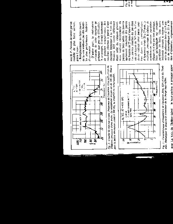

Hello again:
You said that the port size was modified to decrease the first peak..I assume you are talking about the famous double hump imp. curve of the typical ported speaker? What sonic benefit does this give? I always thought the port was adjusted until the two peaks were approximately the same...or is the altec's first hump to large? I have heard that while a decrease in port size was advantagous with some of the older A-7 woofs, The 515 -8G was a different animal. [please elaborate...I just know this port of mine looks too large!
Thanks,
Russellc
Disabled Account
Joined 2002
Hello Russell,
There was no information why they did do it. Maybe to give an easier load for the amplifier. I did join an attacment in French language. With the 416 it did change from 68 into 47 ohm. I am sure that there are people out here who can predict the sonic benefits. This are and will stay my first diy-speakers. Kind greetings, Ed
