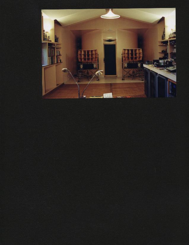

Hello,
It is true that a good horn system will need a very good amplifier but it can be a small one. I have been using a single-ended el-84 amplifier designed with a symmetrical output transformer designed to be used as a line amplifier so a preamplifier to drive a poweramp which did have a transformer at its input for the French broadcasting system in 1961. But most electrostatics will need a lot more power and more power is usually less musical. In France they say you cannot compensate low efficiency by just adding more watts. In the end you have the same sound pressure level but it will sounds most of the times just loud but not alive. Kind regards, Ed
Hello,
Maybe my story was not 100% clear. So i am using a line-amplifier to drive my Vot's. In the near future i want to add a single-ended vt-25a to drive the Tad-2001. The amplifiers will be used with a passive 12 db crossover at their inputs. Still the best according to my friend in France. However still looking for a schematic for the vt-25a using a choke-load for the input tube and Tamura permalloy for the output. It has to be perfect above a few hundred Hertz Kind regards, Ed
P.s. Jean Hiraga did allready write in 1980 that there were 15000 users of a Vot system in Japan.

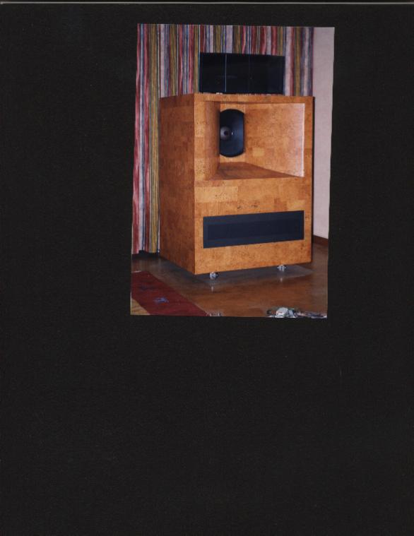

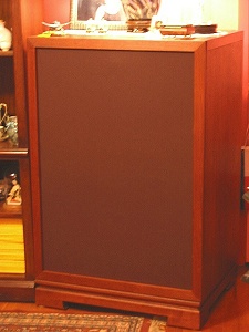

Albert said:...How do they compare with the theater model with the horn on top? Is the 825 a ported cab? ...
I don't know if I could bring myself to cover up that battleship grey paint though ...
did you keep the allignment of the VC's the same for the bass and the horn driver or did you have to fudge a little?
Thanks,
Albert
It is my understanding that this is a factory cabinet in it's original factory setup. This was the commercial version of the A7-500W Magnificents. The bass port is where the horn hangs. This version having more of an opening than the actual A7-500W. I veneered them in walnut and added the pedestals to blend with my other living room furniture and deal with the WAF. The drivers are in original mounting positions as designed and delivered by Altec

Hello again:
You said that the port size was modified to decrease the first peak..I assume you are talking about the famous double hump imp. curve of the typical ported speaker? What sonic benefit does this give? I always thought the port was adjusted until the two peaks were approximately the same...or is the altec's first hump to large? I have heard that while a decrease in port size was advantagous with some of the older A-7 woofs, The 515 -8G was a different animal. [please elaborate...I just know this port of mine looks too large!
Thanks,
Russellc
Hello again:
Thanks,
Russellc
Hello Russell,
There was no information why they did do it. Maybe to give an easier load for the amplifier. I did join an attacment in French language. With the 416 it did change from 68 into 47 ohm. I am sure that there are people out here who can predict the sonic benefits. This are and will stay my first diy-speakers. Kind greetings, Ed
