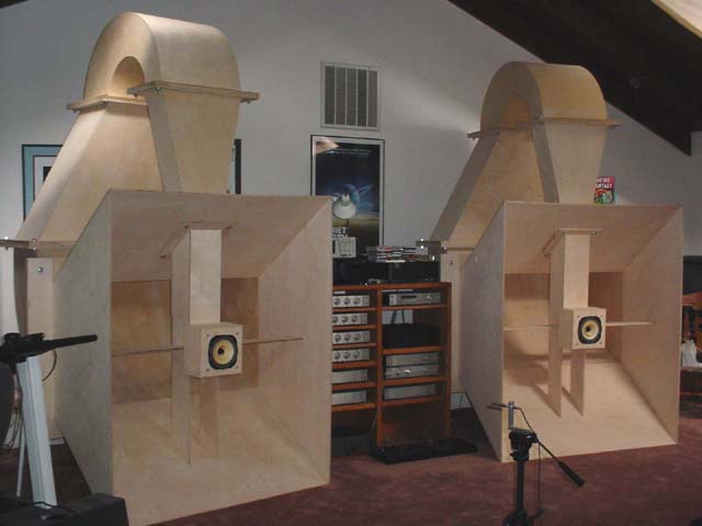

Nelson Pass said:This is what you do with 10 watts.
Not bad. Not quite as elegant as the originals (Be Yamamura's Dionisio 27s), but not bad.
se
woody said:But why didn`t you mirror immige them ?
I don't get it. Far as I can see, they are mirror images of each other. Where's the asymmetry I'm missing?
