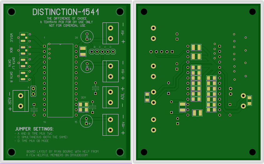

- the smd caps used by AMR (don't know the type, any AMR owner reader here with a usefull input ?)
Hi Damien,
SMD Panasonic PPS, same as Audial.
Shane

Back to your original question about AMR - they've made it public that they use SMD PPS as well for decoupling, although the (physical) size and value aren't mentioned.
In short, I'm confident that the PPS caps are a good fit.. and the 1206 size will fit AYA's pads perfectly.

Result is not guaranted as I don't believe in an absolute best cap : depends on the layout and your own populated pcb and whole devices hifi system but I will do test on the Distinctive board as I have all the polymer of the marbet in 470 uf but the R7 of Panasonic (but which don't please me in a lower value). My thinking it plays very well in a particular layout : the subbu DAC with some caps and coils and ldo regs before !
But as the result was particulary better with this LE serie (constructor ref in my pdf page 37 on the Modyfing Subbu DAc thread) : you may test it, try to stay very close to the voltage needed : 6.3 V for 5 V rails and 16 or 25 V for 16 V rails of the TDA !

My understanding is most of the input daughter board with high frequencies generate glitch because of the low NOS speed needed at the end for the TDA chip : 6.4xx fhz: (input of John in him ultimate TDA1541 thread)?! But I didn't find input with such standalone frequencies ! In anaother way, Andrea fellow has designed a clock board at 12.xxx :
What to do here ? My understanding is most of the famous designer like Pedja or Thorsten seems to agree of a very near Crystal or fhz repeater (AMR?) to the dac-chip, but IanCanada FIFO seems to be a new paradigm as well and in the same time agree to follow I2S to PCM & simultanous feed after the call of some fellows....
"Few fellows" who participate to the rock'roll surealism and good adventure of the collaborative development of the "Distinctive-1541 coreboard", what do you think now I open a specific thread to talk about input/output, share shematic, help.... as we know now the date of boards printing ?
Or someone of us open one for input and another for output to make more easy the readings ? I can open one of the both (will prefer the output daughterboard for technical understanding
