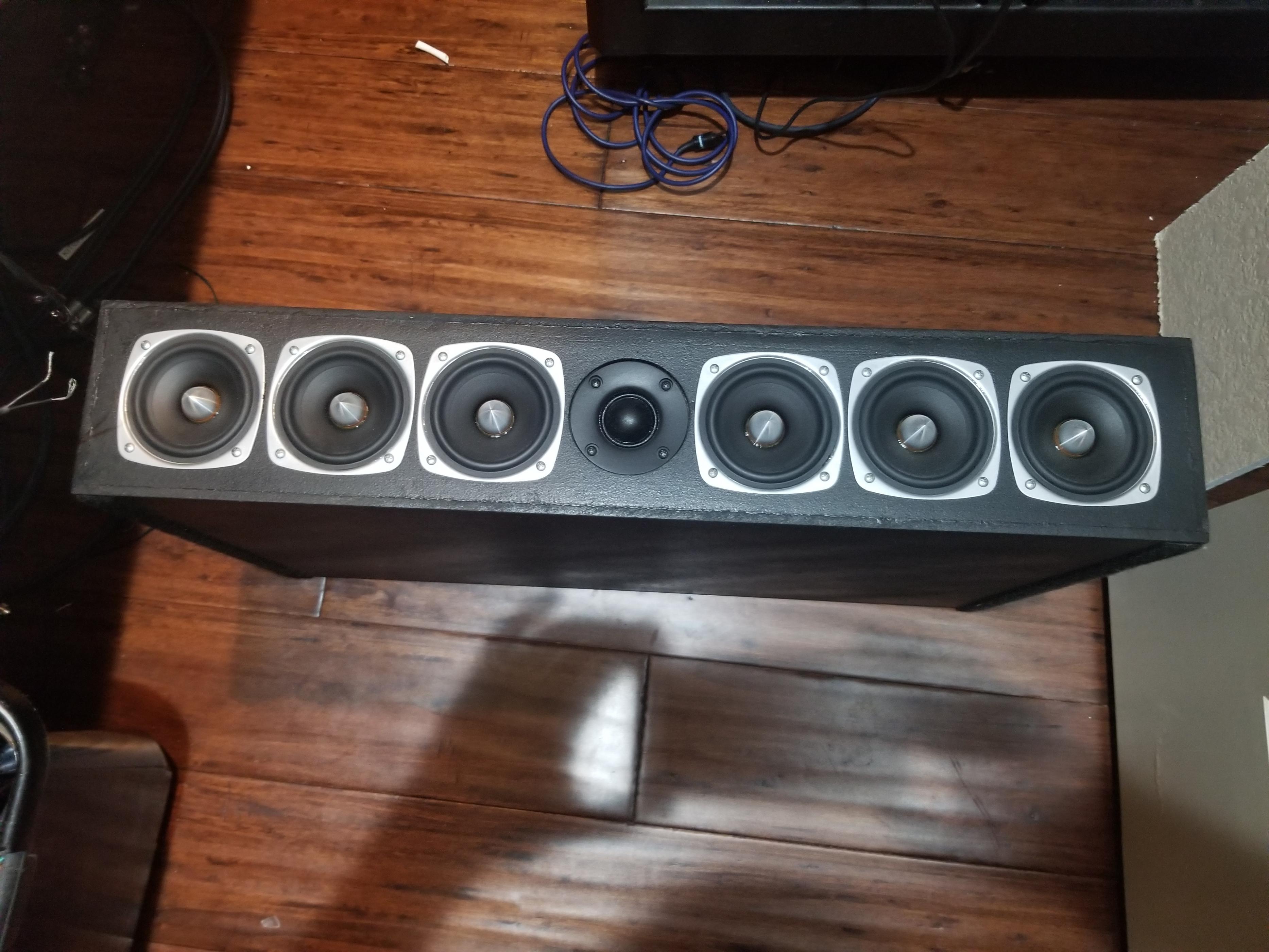

Reviving an old thread. Tang Band W3 526S ?
Howdy all!
Digging this gem out of the past, instead of starting a new thread. Used to build speakers but haven't in a long time.
I have a garage-sale find of a DIY center channel with six TB 526S's and a tweeter (haven't pulled it yet). The guy said it's a proven design, but I can't find anything that looks like it.
The problem is, it's a big deep box, to sit on a cabinet or whatever. But our TVs are wall-mounted, no cabinet. So I want to rebuild it for wall mounting. I thought about a sound-bar kind of thing - match the interior volume of the existing - but I'm not sure that's the best approach.
It is vented with four ports, each about 1.5" dia - I have not pulled them to see if they're different lengths. Crossover is inside, I'd probably move it out. No polyfill, which surprised me.
Has anybody ever seen this before? Plans? Suggestions for re-making as a wall-mount?

Thank you!
Wow, this site is amazing! Thank you so much for the info! The designer's write-up makes me think a skinny box, front- or maybe down-ported, would work for my application. Some other folks weren't so thrilled with its performance, but since I have all the parts, what the heck. I'll take pics as I go...
