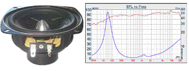

I checked the Parts Express Web site two days ago and they now have test results for the W4-1052SA posted. The sample they tested appears to have a greater response variance than the two I tested. I also checked Tang Band’s Web site and found no listing for the W4-1052SA. Earlier in this thread, there was what appears to be a copy of a Tang Band W4-1052SA Web site page attached to a post. If that was from the Tang Band site, it is now gone.
Tang Band still has a page for their structured PP diaphragm listed with the model number W4-927SA. The 927 and the 1052 appear identical except for the mounting lip on the basket. I was interested to see that their response graph for the 927 looks much more like mine and Parts Express’ testing of the 1052 than the 1052 did.
If Tang Band has posted a more representative frequency response graph of one of their driver’s performance, then I commend them. If we want manufacturers to publish accurate and detailed performance evaluations, then we must buy drivers so represented. The question is, with the performance shown in the W4-927SA graph attached to this post, would you be as interested in the driver as you were when you saw Tang Band’s original page for the 1052? What manufacturer wants to go first and publish high definition test results that make their drivers look worse than their competitors even if they are acoustically better?

http://www.partsexpress.com/pdf/264-828g.pdf
I don't know about you, guys, but those breakups are not my taste...
Yes amazing what 1-10 smoothing can do. A TON
Look at the 30 off .Talk about dive city
This is one of the issues with the new XBL 4" CSS is doing that I have told Bob and Dan is a issue.
The 4" drivers from TB all are done before 12K none of them really go past that then the off axis on the drops at 10K no higher.
XBL on the photo type that was at CES has more upper end over the rest but not to the 18-20 k that is possible.
Low end well XBL talks.
The upper end and mids better with XBL as these harmonic distortion from XBL is very very low.
So the XBL will work on the 4" just a matter of a few other issues that are being looked at now.

MarkMcK said:I checked the Parts Express Web site two days ago and they now have test results for the W4-1052SA posted. The sample they tested appears to have a greater response variance than the two I tested. I also checked Tang Band’s Web site and found no listing for the W4-1052SA. Earlier in this thread, there was what appears to be a copy of a Tang Band W4-1052SA Web site page attached to a post. If that was from the Tang Band site, it is now gone.
Mark
Mark;
That 1st graph on the TB W4-1052SA that I posted earlier in this
thread was not from a TB web page but was rather emailed to
me by request from TB. Seeing that Parts Express had no specs
posted at the time & TB had not even a posting of the driver let alone specs I simply emailed TB asking if specs were available & about a day later I received a courteous reply with that spec
sheet. Seems that 1st graph though may have been more of a prediction or wishful thinking on their part at the time than an actual measured response. Who knows?
I've come across another rather interesting spec sheet discrepancy for a TB driver. For the W69-1042 (6x9 woofer), the graph & the TS parameters posted at TB are in total disagreement with those posted at Nuera. I emailed Neura about 1 & 1/2 months ago questioning the discrepancy & they promptly replied thanking me for pointing it out & that they would question TB & get back to me as soon as they found out but I've not heard from them since. I suppose I'll email TB. I suspect the Nuera posted specs for that driver are an early out dated release & in greater error as for one thing The "EFFECTIVE PISTON AREA" spec of 0.014 M sq., (shown by Nuera's data sheet) is of particular suspect to me since that would be a value more typical of a 6" than a 6"x9" speaker. The value of 0.0226 M sq. (shown by the data sheet on Tang Bands website) makes more sense.
It sucks not being able to trust published specs.
