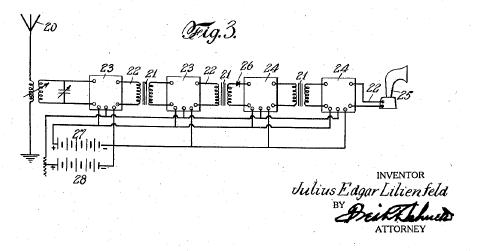

Transformers and JFETs...
...are "old school" so to speak.
From the original 1930 JFET patent. The boxes represent JFETs. Looks like ZFB to me.
Also, for those that think that today's patent process is slow, it was filed in Oct. 1926 and granted in Jan. 1930. That is about the duration these days.

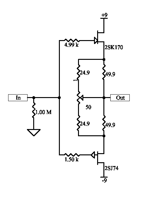

Charles,
regarding to your headamp schematic with 2SK170 & 2SJ74, did you chose the Rg regarding to the Nf for respective FET?

Ultima Thule said:just wanted to ask your opinion wether you think an input FET transistor should be cascoded with same type of transistor or a BJT instead, pros and cons?
It depends on what you are trying to do. A cascode will offer two benefits:
- Elimination of Miller capacitance on the input device. (standard or folded cascode)
- Ability to use a low-voltage input device in a high voltage circuit. (standard cascode only)
Unless I really needed one or both of these advantages, I would keep the circuit simple and omit a cascode. If you need a cascode, you would probably want to try a couple of different configurations and see which works best in your application.

Hi Charles, don't you think that a 30 ohm load would be a bit compromising for this simple complementary follower? Were you thinking about 600 ohms?
It is a shame that it is so difficult to get high current complementary jfets in a decent power package. This follower is just about perfect in most other ways.

john curl said:Hi Charles, don't you think that a 30 ohm load would be a bit compromising for this simple complementary follower? Were you thinking about 600 ohms?
Hello John,
Earlier in this thread John Ferrier had noted that he was using 300 ohm headphones. The output impedance of the circuit I drew is about 25 to 30 ohms. I've tried it before with headphones of several hundred ohms impedance using two 9V batteries for the supplies and it sounded quite good.
Is this the ultimate headphone amp? Probably not. It was just intended as a suggestion for a proven circuit to get John Ferrier started. The best way to learn is to try different things, but it's also nice to have a starting place.
I agree about the device selections that are available. It really is a shame, because I'm sure the entire audio community could make even better stuff if we could also design the semiconductors. It's nice that Semelab stepped in to fill the void left by Hitachi with their lateral power MOSFETs, and I'm glad that Toshiba is still making nice small-signal JFETs. But I could really use a few other nice parts....
Best regards,
Charles Hansen
johnferrier said:The headphones I have in mind are a 300 ohm load and the plan is to use four complementary JFET pairs in parallel (Idss matching amongst all pairs to < 2%). Should idle at just over 40mA per channel.
If your devices have an Idss of 10 mA and you skip the source resistors, the total output impedance will be around 3 or 4 ohms. Whether or not it will improve the sound can be quickly determined with a listening test. I would expect that it would, but have never tried it and don't know.
The difficulty with your approach will be to keep the DC offset to a reasonable level. If you have enough FETs you might be able to manage by simply matching all 8 parts together. But speaking from experience, this could be tricky to pull off.
