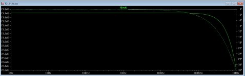

Attached my current amplifiers open loop response.
Sajti

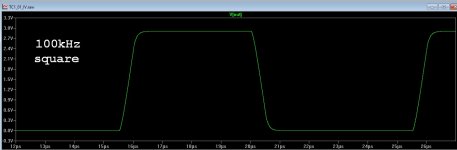

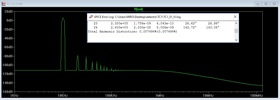

I tested something ... and is working ...
