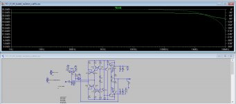

here is AC analysis of my original tested concept:
attachment.php

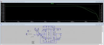

and this is with diamond input
attachment.php
both on the same scale ...
