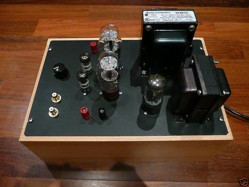

Wood/Steel Chassis
I used to use Hammond steel or aluminum chassis, but found that it was difficult to get a high WAF (wife acceptance factor) with a naked chassis, so I have taken to splitting the difference:
I now use steel Hammond cover plates (the black powder coated ones, in order to save a step) mounted on top of solid wood chassis. This works esp. well with the EDCOR OPTs which aren't very presentable, so need to go under the chassis.
Here's a Darling amp on a maple base, for example.
(this one's on email right now; search "darling amp" for more photos)
This works really well, as (a) you have your steel chassis to ground-to (b) the plates are pretty cheap, so if you screw-up it isn't tragic, and (c) the system is pretty flexible; I have made one amp with different plates for Power Supply, amplifier section and OPTs, so I can pop different "modules" in and out at will. I use terminal strips like George at tubelab to join the modules together.
The only downside is that you lose about 3/8" all the way round, but I think the advantages make up for the loss of real estate; besides, you're not limited to 2" or 3" deep any more.

I have used this technique for the first two Simple SE boards I did; use the 17 x 10 inch Hammond cover plate.
Note that if you use heavy iron, you will need to stiffen the cover plate some. You can use 1"x 1" angle from Home Depot, or say a 1" wooden cross brace (although that eats up volume).
I used the 1x1 angle as a transverse brace under the iron, and secured it with the PST & choke mounting bolts.
This gives quite a large SimpleSE amp, but there's lots of room to mount EDCORS upside down underneath, plus room topsides to convert to Transcendars or James or OneElectron OPTs if you later feel the desire.
