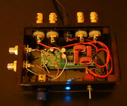

I am a complete newbie in DIY and AMP3 was the first attempt at assembling a kit.
Respect!
Here is a pic of my assembled amp3 in an acrylic/Ebony casing.
Forgive the mess with the wires and of course the pot is dirty cheap.
I wanted to use a good pot/stepped attenuator but there's none here and unfortunately I can't use paypal, so I haven't been able to get someone sell me one with alternative payment method.
Ikobo, credit card...
If someone wants to sell me a good pot like Noble, Alps Blue or even better Stepped Att. kit like the one on ebay by kuo kyc, that would be nice.

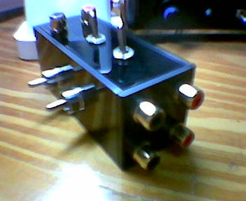

Here's also a pic of my expander that allows me to connect three source to the amp3.
Again made with acrylic, easy to work with and Ebony.
Please forgive the verrrry low resolution, pic taken by phone camera.
I originally wanted to put a pot in it, that would have made it a passive pre-amp, but again no good pot...
