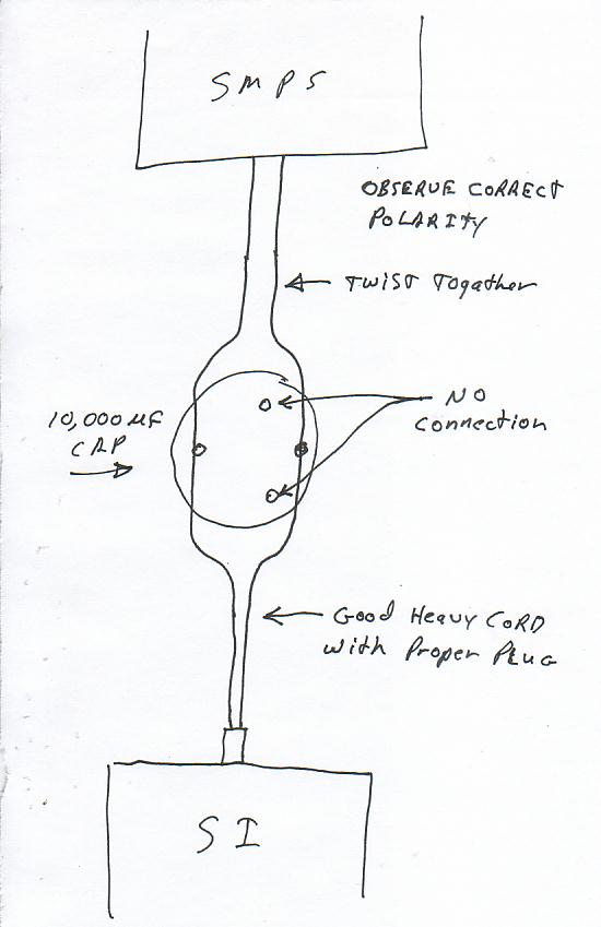

Did the snubber make much difference?
I don't know Phil. It was on the 10K cap and I couldn't be bothered to take it off and try without!

I did compare the cap with and without snubber on the Amp3, it does make a difference so give it a try and see which you prefer.
I can't make my mind up if I like it better with or without
The snubber seems to alter the tone
All the guys who prefer a pre-amp with the T-amps all seem to be using a tube based one, I guess an active pre helps if you have a slightly bright cdp, I've not tried it yet so can't comment
The best set-up I've had with the Amp3 so far is
NUUKs smps
10k Siemans sikoral cap (didn't like 20k)
Snubber (not sure yet)
2 x 680uf BG NX for the vd decoupling on the pcb
1uf Multicap RTX input coupling caps
Panasonic for audio pot
