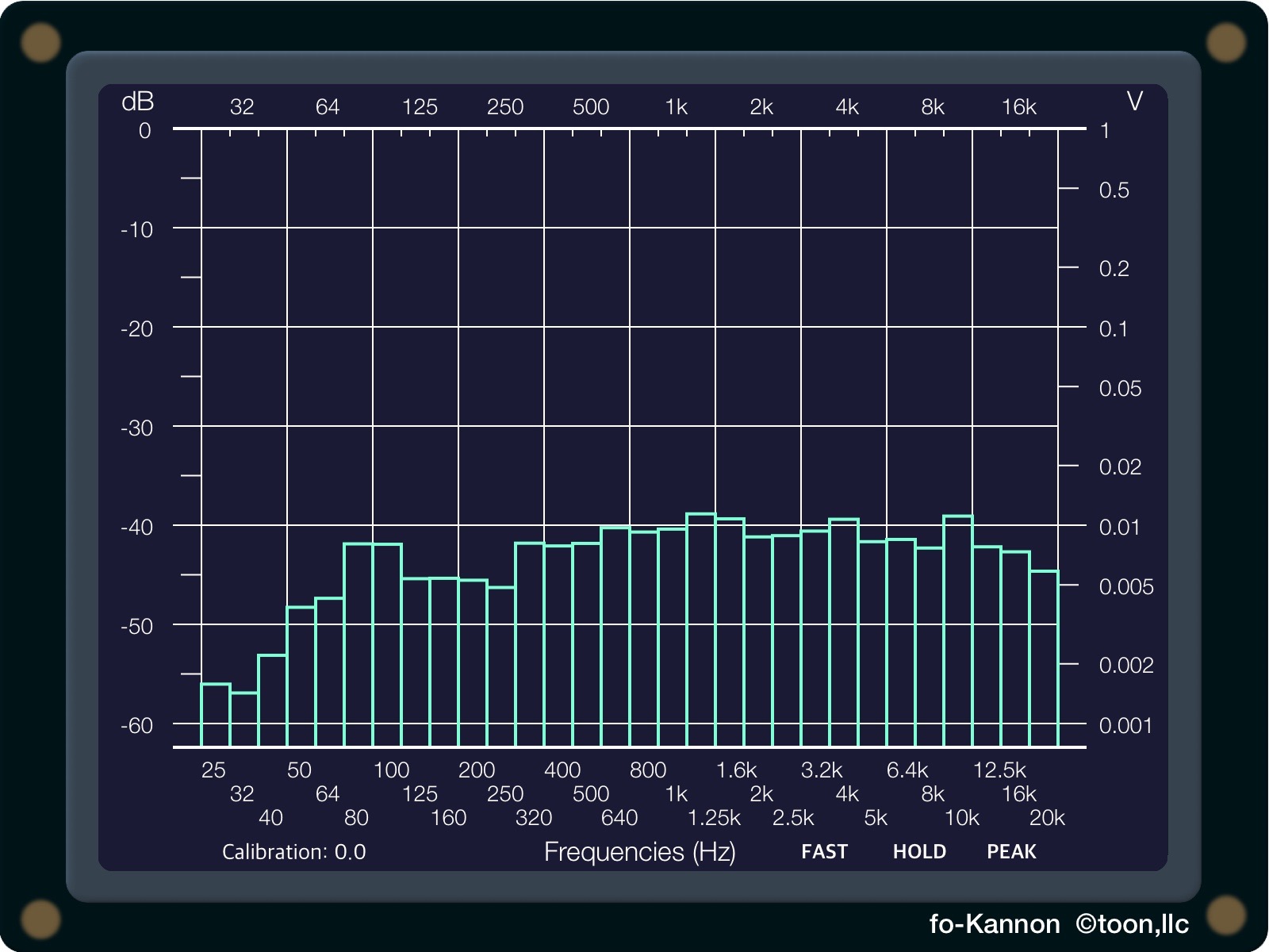

Hi ENCR,

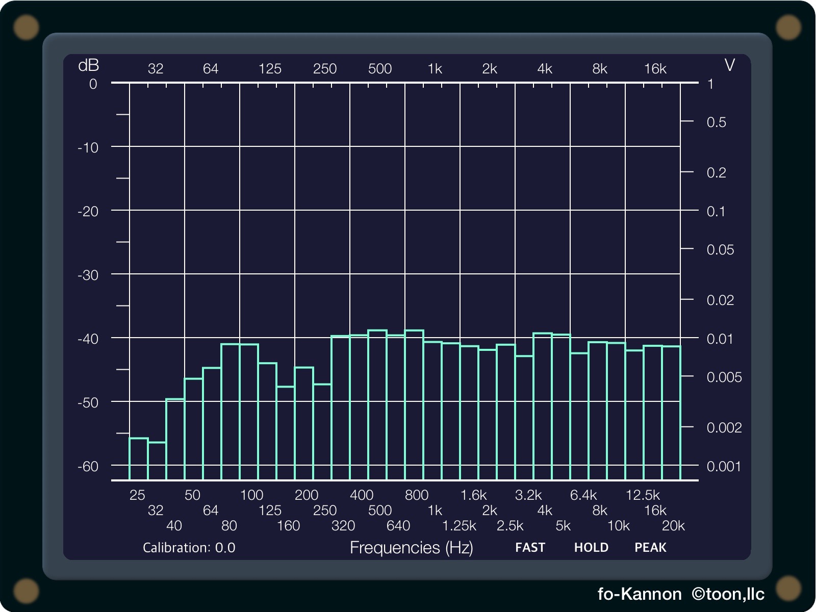

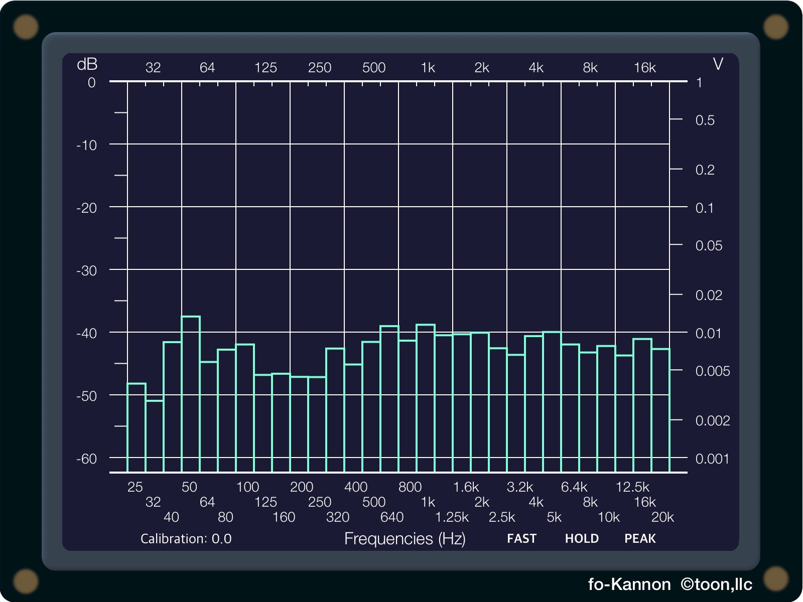

I was having a heck of a time with the bass response of my stats; terrible booming that overshadowed whatever else bass the speaker was trying to reproduce. And as a visual bonus, they displayed a fairly entertaining light show during the evening hours.

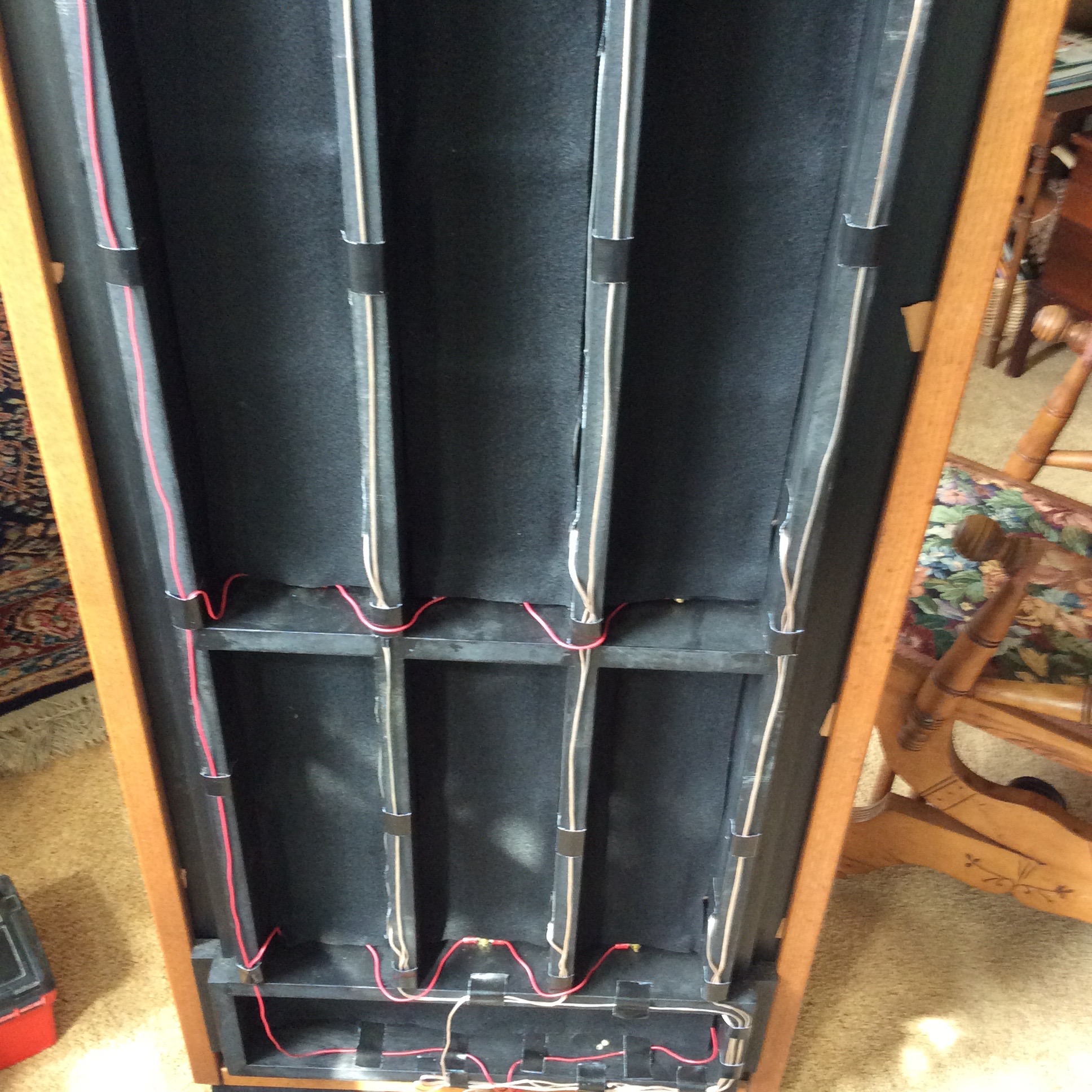

I was extremely disappointed until Sy and Bolserst suggested applying inexpensive craft felt to the back stators. Hmmm. Tried the felt and it worked wonders. The bass is now clean, tight, and distinguishable, at least down to their workable frequencies. By damping the diaphragm, the felt also resolved almost all the the arcing and bottoming out issues. Bolserst can explain this much better in a technical manner.
The felt does dampen the rear sound very slightly, but as mentioned, probably no worse than a grill cloth or a little dampening if there is sound absorbing material on the rear wall. Lately I've been experimenting with removing sections of the felt from my top three panels. So far I can't decide whether with or without sounds better. Perhaps a tad bit brighter without the felt, but nothing to ponder on.
The first attachment below is the response of the speaker without felt. For an ESL the bass actually goes down fairly low, however that 50 hz peak adds a heck of a lot more bass that the music calls for. Boom town.
The second attachment is the response with felt. Except for the dip in the 100 to 250 range, the speaker has a more normal response, and a gradual decrease in the lower frequencies. The felt makes them sound much smoother too.
The third shows the felt applied to the back. I just used some tacky material spray my wife uses on her quilting projects. It is sticky but the felt can be removed easily if you don't like it. Ha, with the holidays, maybe I'll switch the black felt with some red.
Have fun whichever route you take.

Hi tyu,

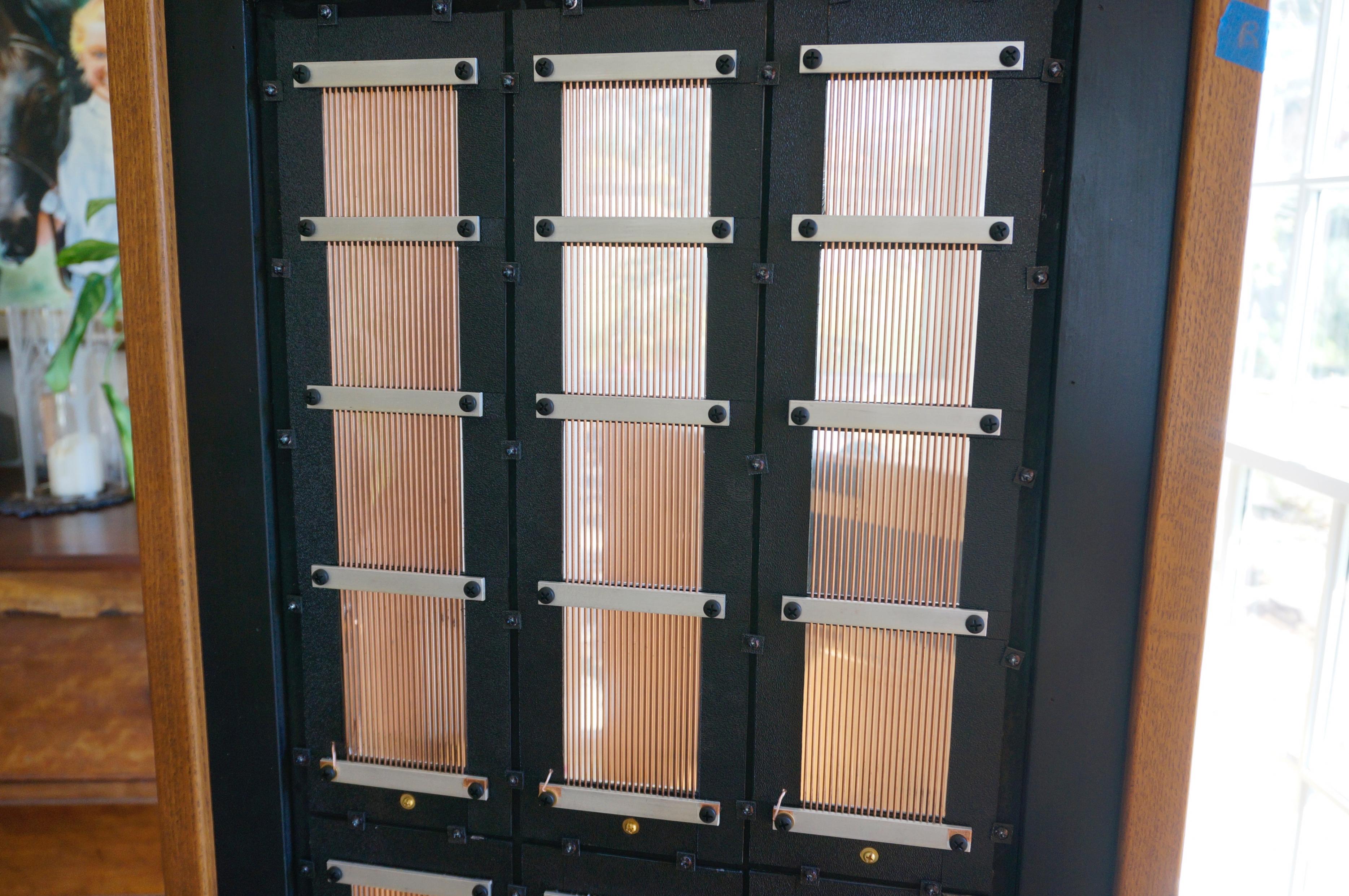

These are the same speakers in the 'progressively sized' thread. Below is a picture of the top three panels so you don't have search for them.
Just for the fun of it, I turned the speaker around and measured the felt side. The mic position was exactly the same; centered about half way up, three feet back. There is a slight roll off on the highs, but not sure how many people could hear it. My old ears have a hard time. Have know idea if this has any validity.
