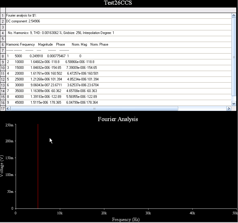

here is my Fourier transform output.
What it say ?

Hi Boxedin,
congratulations, you've got a sym to produce numbers and a pair of plots. Well done. More than I have ever achieved.
Can you redo the last pair of plots with the frequency on a log scale from 1Hz to 100kHz?
and if possible the voltage also on a log scale giving a log log plot.
Then the picture will be more familiar to my inexperienced eyes.

boxedin said:
Ac analysis
Greetings from Norfolk
We have had a number of posts from boxedin, together with a number of simulation results, but he has not said what software he is using.
Further, if the plot that accompanied the quote is based upon points indicated (triangles on plot) then the simulation has, to my mind, missed the points where harmonic distortion will be indicated, i.e. multiples of the fundamental.
Also, as the levels of the harmonics should be low, a linear plot of on the 'Y' axis is very un-informative. This needs to be a log plot, preferably over at least 3 decades (60 dB).
Happy New Year
Richard
Boxedin,
As I read the figures in the table you gave, I find 48% 2nd harmonic, 11% 3rd; 0.4% 5th and 2,7% 7th harmonics. I am sure this is wrong - how do you get 48% 2nd harmonic distortion? If so, WAY too high, but I leave room for error in interpretation on my side. Read on...
