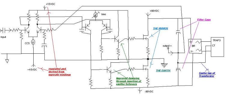

Hi Quasi,
I have an upgrade sort of thing for your amp.
1. Supply Requirements +-15VDC regulated for Driver stage & +-90VDC unregulated for output Mosfets..
2. Reversed output type i.e. output node of mosfets acts as an earth reference and center tap of caps+trafo acts as an output...
3. Additional damping factor improved by using emitter followers prior to mosfets yet Maintaining R2R operation...
If you are interested than i could post the layout.....

Ok Quasi,
Here it Goes...............
Though a rough layout yet!
kindly post your comments ....
K a n w a r

Hi Kanwar,
You must know that the second diff'l pair is not having the good behaviour as one half will have twice the Pd so will drift, also no emitter degeneration. This also is slowed with C and placing more demand on first stage current.
Oh, goodness me, you have floating PS and grounded output - so both your output stages can be, seemingly, 'grounded' output but supply is now floating and not bypassed with big C to ground - I think you are swapping halves for problem.
Greg
Hi Greg,
The emitter degeneration are must for there...only emitted in layout due to simplycity....
The first differential current is set at 3mA per device and second differential is at 8mA per device sothere would be no problem regarding drifting as long as the devices are mounted on heatsink..
Secondly to EF stage is at idle current of about 20mA and thus drives the output mosfets well enough with good damping due to increased current gain from the previous version....
Regarding grounded output, it simply doesn't pose a problem because the driver stage is well regulated and isolated and its earth reference is just connected to the output well enough and I have used this circuit for powering the subwoofers 2 years ago without any problem regarding filteration ....
Damping was excellent enough to restrict the woofers within their limits of XMAX[excursion].....
Meanwhile QSC also uses grounded output node and Crown also uses grounded bridge which have same operation basic grounding principle and have no ill-effect on the performance...
regards,
K a n w a r
Hi Kanwar,
I have also tried the emitter followers on this amp with a few hundred milliamps running through these. This provided for a very low impedance drive to the output stage. But this stage ran really hot.
Instead of this I opted for the cascode second stage as posted in the high power version. There is no reason why this stage can't run at say 100mA or more as there is only a couple of volts across the driver transistors.
I like the idea of the regulated power supply to the input stage.
Eventually though the other amp I posted in "power amp under development" continues to be superior.
