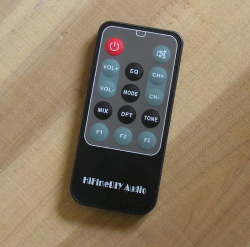

remote
At last we make a remote and here it is.

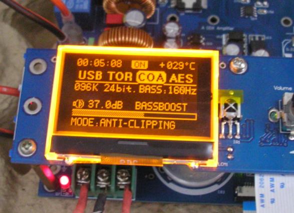

Nice hifimediy, but be careful you don't clutter the display with too much info. When do you really need to see the Xover frequency? Only when setting it.
In my oppinion it should not be displayed when you are not in "settings" to keep a clean display with only the relevant info.
On another note, is it possible to change the LCD to VFD without much hassle or is a major rework needed (not that you should include VFD in your kit as it is too expensive, but is it possible to swap the LCD for a VFD myself?)
They need different driver in program, so may be not easy to use both LCD an VFD.
