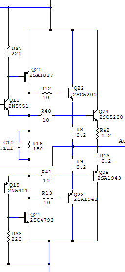

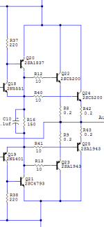

Since I found out how to set bias current everything that confused me makes sense now. This is so embarrassing. :eek:
A.H. recommends to set the bias that there's a 18mV voltage drop across each resistor. With 0R22 resistors this gives 82mA through each pair of output transistors, right? So the total idle power loss with 10 pairs is around 150W??? :eek:
Setting the bias made me think about the potentiometer. Given the case the wiper loses contact with the resistor the base / gate of the bias transistor is floating. With a BJT in place it stops conducting and bias current increases till the output stage dies. With a FET in place anything may happen, most likely the same. Right? In most amps I've seen the wiper of the potentiometer is connected to one of the resistor terminals and the potentiometer is located on the sinking side of the base / gate. Wiper failure in this case decreases bias current to save levels.
The downside is that the total resistance of the bias setting resistors+potentiometer circuit varies with bias settings since the resistance of the potentiometer itself is varied instead of just picking a voltage from the potentiometer.
In simulation the safe solution sometimes caused strange problems. I haven't figured out yet what makes spice go mad. :confused:

Substitution
Hi Lee,
I would suggest to replace Q13/14 and Q8 with small TO-92 transistors, you don't need a high power TO-126 device. The 2SC2240 would perfectly fit the current mirror.
I you want a fixed voltage drop over R17 replace it by a zener diode, you could onmit the capacitor. (C12)
regards,
Piersma
Hi Piersma
Thanks for your suggestions.
I spent some time thinking about them and also spiced a bit.
I'm not sure about this but from what I read about current mirrors I don't think it is a good idea to use dissimilar transistors in a mirror. I think the pairs Q8 + Q9 and Q13 + Q14 should be same type, preferably matched ones. I admit I haven't simulated this yet. But I will do later and also do some more research.
I'm curious how the swapped Wilson current mirror will perform in this amp. I read it doesn't improve anything drastically. It's just there because I fell in love with it on the first glimpse. It's so symmetric, nice to look at and mirrors currents perfectly.
What I like about the TO-126 is that they don't require more space than a TO-92 and are easy to couple thermally. I already updated layout and placed the current source transistors back to back. I will put a mica insulator between them and couple them with a plastic screw. For the mirror I'm not sure yet whether this is a good idea.
To change the circuit around R17 was a great idea! The Zener doesn't change performance considerably but putting the weird pnp transistor with base to ground like in the SymAsym in this palace drops thd from 0.006% to 0.0025%. :) :) :)
The transistor has to dissipate ~0.5W. Do you think the SA1381 will do the job? Maybe the SA1837 is better there?

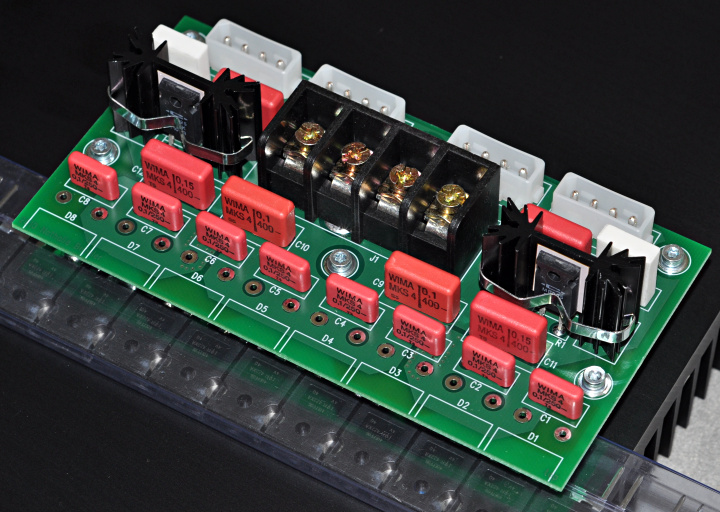

P.S.: Last weekend I already started assembly of the rectifier pcb.
Just imagine the diodes connected and everything mounted to the heat sink.
