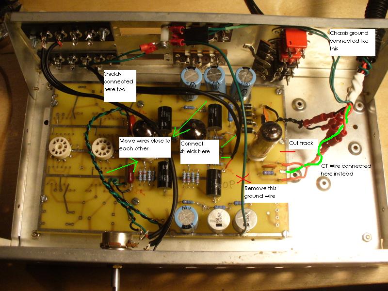

Hi megajocke,
I think that the easiest and best way to describe what you think should be changed, in the grounding scheme on the PCB, might be to indicate it on the following PCB Layout diagram (and/or some of the other diagrams and photos):
http://home.comcast.net/~garyworld/pcblayout.jpg

Hmm that layout has its problems. The worst one is probably how the heater circuit is connected - the rectifier connection and that the heater return is shared with signal returns.
The rectifier bit is probably worse, I'd start with cutting the track as indicated in the picture and do the grounding changes. Cutting the track will keep the rectifier current out of sensitive areas at least.
I'd start with doing these modifications and then see how much it helps. If it still hums without power then something is fishy but we shouldn't be far from finding what causes it in that case. After these modifications hum when powered is quite possible though.

thanks for bearing with me. So I have made the changes megajocke detailed. I took a picture of the current state and inserted some comments. Please find it here:
http://home.comcast.net/~garyworld/preampfeb29.jpg
I had already scratched out both sections of the pcb ground around the filter caps when I saw megajocke's very nicely detailed picture. (I was inspired to do some photoshopping of my own.) I assume this necessitates a separate ground returning from this section to the star ground. Notice I put one in. I checked to make sure that there was no continuity between it and the rest of the pcb ground scheme before making the one pcb connection to star ground, (see pic above.) If this doesn't look right I can always tin in the cut section at C300. Also notice I connnected the CT at the first filter cap ground, attached the output ground/shield to the pcb, moved outputs up next to inputs, and bundled signal leads to be closer together. Let me know what else I can do to complete the starground and other grounding issues so that we may move on.

For what it's worth, with the changes I made today the preamp hum continues. Mark, the .33uF 400V caps arrived today, I will try to put them in tonight and report back.

OK. Here is a post that looks like it contains some new ideas, which was posted in the sci.electronics.design group thread (by user 'legg', signed 'RL'). Maybe some of the experts, here, will see some good clues, in this:
----- quote:
Sounds (reads) like you've tackled a lot of issues, so far. There's always a problem with iterations, that makes it possible to accidentally pass over or defeat solutions.
First thing to fix is hum when off. Ignore all other issues.
With hum present, disconnect all other equipment. Leave disconnected until powered-off hum is solved. This includes your 'computer scope'.
These connections will just complicate things. Use your ears to measure the hum. When you can't hear objectionable levels, the problem is on the road to being solved.
trannybox - the orange wire should follow the brown wire from the AC line socket to the switch. Twisting uses the least hardware. You are switching the neutral wire in this photo. This could explain a 60Hz hum when the preamp is off.
You said that you reversed wires going to the switch. This wording is subject to misinterpretation. The live terminal of the IEC inlet (brown wire in your trannybox photo) should go through the fuse, to the switch. From the switched terminal the returning connection should run to the transformer primary.I am surprised that both transformer primary wires are colour-coded brown. The orange wire on the polarized neutral of the IEC inlet should follow the brown wire to the switch and return unbroken to the transformer primary. Twisting it around the live wire uses less hardware to accomplish this routing.
This is actually how the wiring is laid out in the 'preamp1' photo,
using printed wiring, but without the polarized inlet. The 2-pin 120V hardware can also be polarized - the wider blade is supposed to be neutral. Old Dynaco hardware may predate this convention.
There is no ground wire connection. Assuming plastic hardware, this would still have connected to the transformer case, followed by a lead to the chassis of the target load, to allow for leakage current return to safety earth. If not present, connect the transformer case to the chassis, anyways, even from a remote plastic box.
Check the line cord phasing of the power amplifier, it should match that of the preamp, even if line and neutral are not properly wired into your wall socket.
The power supply schematic does not use the same transformer you are using. The original has a colour-coded primary, a grounded core/screen. If you have an isolation transformer, use this temporarily for the preamp, power amp and combined set to see if there's a difference one way or another.
Ignore other issues until powered-off hum is defeated.
RL
----- end quote
----- quote:
RL
----- end quote
Yes, like gootee says, does it still hum when unplugged and/or turned off? That should be solved first and then we can try to find the source of the hum when it's powered.
Could you check if it hums with the rectifier tube pulled? If it does that then it's definitely the heater return current. If it doesn't it could still be. In that case check if there is hum if you short the black and green twisted wires together where they connect to the board. If it still does then I'd guess heater return current or ripple on anode voltage.
The new connection looks better but I think it actually might better to bridge the lower cut and use that trace for power supply return. I'd connect the ground isolator to the jacks but I doubt it will make any difference. The heater circuit looks suspicious though.
I just read the newsgroup posts, and some interesting points are made. Especially the one about hum when turned off and high impedance state. If it is due to the high impedance and electrostatic coupling then this hum should not matter as off state performance is quite unimportant as was pointed out. It should diminish in strength greatly though by putting the cover on. But if it is magnetic coupling into loops in the circuit then it will probably not change much when turned on. It will be easier to find the problem though if it doesn't hum when switched off.
Assuming the circuit isn't defective (no open/loose connections, etc.):
1) Make a separate power supply and keep it at least a couple feet away from the preamp. Connect the power supply to the preamp by a length of cable long enough so you can keep the power supply far enough away from the preamp. Don't use and/or remove the power supply from the preamp.
