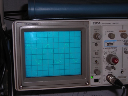

Hi William,
I have one photo of my distortion, I hope that you can see samething.
Yes the photo is quite bad.
Xavier,
I tried without McMillan resistor (with 40R to ground), but I foud a residual of distortion (and the time to stabilize the DC off-set is too long) so at the and I decide for 4k74 value.
Paolo
wuffwaff said:
are we really talking about the same distortion seen here?
http://www.diyaudio.com/forums/showthread.php?threadid=98763&pagenumber=5
This starts at around 22V although the amp only starts clipping at 29V.
William
William,
I would say so, but in my case everything happens at less voltage since my rails are about +/- 17.5v
The latest images I post shows only the remaining of the initial distortion after some changes (Cap, McMillans, etc), but my initial pictures were quite similar to yours. In my case, I got a similar waveform to the one you posted whenever I used bigger caps for B-C of Q3 and Q8 (more than 1nF).
I also detected after removing the McMillan resistors that the behavior was better after the amp had been switched on for a while, having the offset to ground at about -3.5v. If you compare pictures 5 and 6 from my previous post, the only diference is that picture 6 was taken 30 minutes later, with more negative offset to ground.
Paolo,
You are right, removing the McMillans improved things only apparently but did not removed the distortion. It is not the solution, but helps to identify the causes of the problem.
I am not sure yet about it but, could you guys check if you have some improvement in your wave by adjusting the offset to ground to, lets say about -4v instead of near to 0? (only as a test, I am not saying that you leave your amps with this offset as a solution).

Stefanoo said:
Xavier...have you figured your problem with distortion on your Aleph X out?
Hi Stefanoo,
I am quite busy and I haven't much time to test. I just reverted to the previous stable situation to be able to listen music. Anyway the distortion only occurs just before clipping and only for frequencies above 10KHz, so I don't think it is a problem for me for listening music at a normal level.
