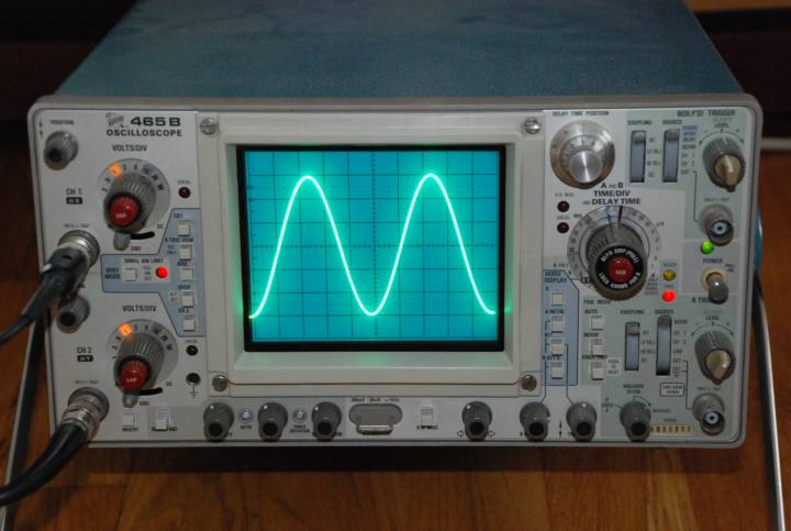

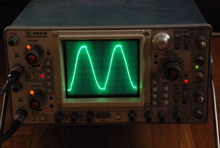

And finally the same wave after adding both signals. Here we can see the strange shape at the output.
The asymetrical clipping that can be seen in the previous picture could be causing this behavior but then, why is only happening with high frequencies (10-20KHz) and not for 1KHz?
Thanks for your help.
Xavier
Xavier

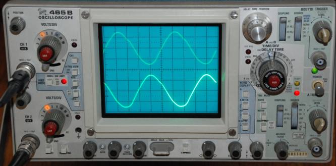

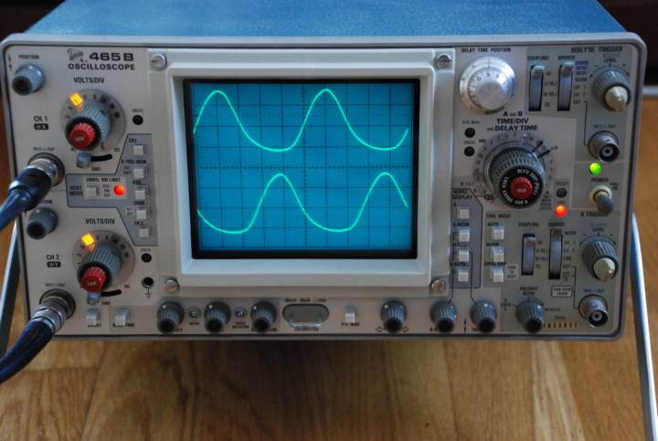

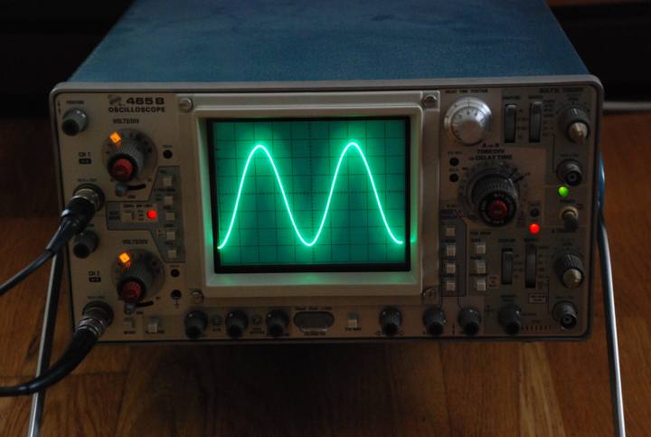

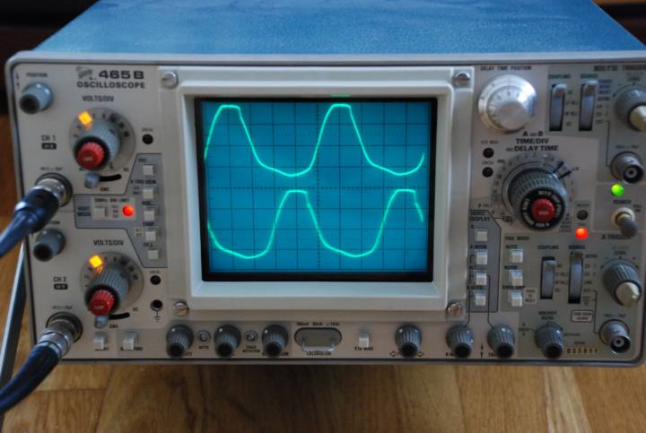

The following image summarizes three cases (1KHz, 20KHz and 20KHz. All measured using an 8R wirewoud resistor between
out- and out+, but was the same for 4R and without load)
1 and 2: Normal behaviour
3 and 4: for high frequencies, the positive part of the wave is thiner and taller than the negative. This gets hidden in pict 4 since one side compensates the other.
5 and 6: If we increase the output level, the amp goes into clipping at the positive way before than the negative since the wave is much taller at the positive.
So the problem seems to be the behavior in high frequencies.
Xavier

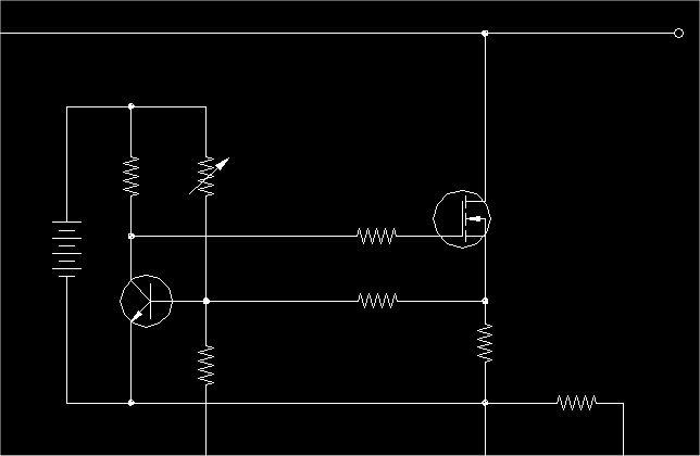

William,
May I suggest you try taking out the 2 resistor and replace the cap with a 9V battery ? The experiment will cost you 2.50 Euros at most (and an hour or so for testing).
You would probably need to trim the CCS again because of the difference in voltage (across what was the cap).

Some progress
Today, while I was I checking this ...
Today I checked this and I found that the wave was not OK from the first second. So, it seems to be a different problem.
But, while I was checking with the scope I discovered a 2MHz/100mV amplitude oscillation. The attached image shows this wave when connecting the probes between the 100k feedback resistor and gnd.
So, the problem I am facing could be produced by an oscillation. This could explain why Sinosuko, who is using the same PCB, is facing the same problem.
I did the following:
1- I moved the 68R resistors to ground from the back of the pcb to the output connectors to minimize loops at the output. No changes
2- I increased the feedback caps from 10pf to 20pf by adding one 10 pf cap in parallel. I could not detect any change
3- I added one 2.2n cap between base and collector of each CCS bjt (BC550C). Bingo! Now the wave at 20KHz has improved a lot. The shape is normal until Vpk=30v. The oscillation has been reduced about 25%, but it is still there.
One thing that I detected from step 2 (I didn't checked before) is that the oscillation is not present immediately when I switch on the amplifier. It starts after about 15min suddenly.
I might try with a bigger cap tomorrow.
Xavier

I've been doing some more testing to remove the 500KHz oscillation (yesterday I mentioned 2MHz by mistake):
1- First of all I removed all the compensation caps I added yesterday and changed the two drain resistors from 520R+1k to 1k+1.5k. This should decrease the current going through the bjt and change the frequency characteristics. It might get rid of the oscillation without any additional cap.
The result: the oscillation was there and the shape of the 20KHz wave was bad again.
2- Added a 10n compensation cap between emitter and collector of the two bjt's. Result: same as before.
3- Removed the 10n caps and I put 1n cap between base and collector. Results: great improvement in the 20KHz sinus wave but the oscillation was still there.
4- I tried with 2.2n and 4.4n and the sinus wave was getting worse and the oscillation was still there.
5- Then, tried 150p. This got rid of the oscillation and the 20KHz is like case 3. It is almost perfect until an amplitude of 30v
So I will leave this channel with this configuration for some days to check how it sounds.
BTW I had to readjust everything, even the AC Gain (now it's 50,4%)
Xavier
