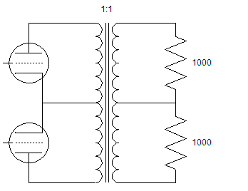

You are talking about a method for PP analysis though, and I would like to learn more. I'm having trouble following why the impedance changes. You are talking about the effects of primaries driven simultaneously and a non superposition way of looking at the circuit?
If you look at class A PP as a balanced source then it might make sense. jlsem is right; it's not really that simple because rp varies with signal, so they don't make a truly balanced source. But it's a good simplification because it makes the analysis A LOT simpler.
Anyway, consider a 1:1 PP transformer. Put 1000 ohm resistors across each half of the secondary. Since it's a 1:1 transformer the plate to plate load seen at the primary is 2000 ohms.
Now ask yourself the question: what load is seen across each half of the primary? Seems obvious by inspection that it must be 1000 ohms. It's a 1:1 transformer; the same load that's across each half of the secondary must appear across each half of the primary. That's 1/2 the plate to plate load.
If you drive only one side of the primary then you have a 1:2 voltage ratio which is a 1:4 impedance ratio. In that case the load seen would be 1/4 * 2000 ohms = 500 ohms. 1/4 plate to plate.
Incidentally, it's not hard to prove using conservation of energy. Since it's a 1:1 transformer the same currents and voltages must exist at both the primary and secondary. If the tubes each saw 1/4 the plate to plate load in class A then there would be a different amount of power going into the transformer than coming out. In fact, IIRC (it's been a while since I proved it to myself) you'll get different calculated powers depending on whether you use i*v, v^2/R, or i^2*R.
OTOH, when driving only one side (pure class B, if such a thing existed) then the power calculations work out ok at 1/4 plate to plate load.
-- Dave

Thanks Dave,
We were really talking apples and oranges... I didn't realize at first they we were talking about an "effective impedance" as a result of a compound analysis rather than a superposition type.
I'm itching to build a PP tube rig... if I can design or purchase OPT's that truely thrill me.
Funny you mention energy calcs... I am always using energy calcs to solve stuff. Crunch tricky stuff in a hurry and avoid all that Simulation and Laplace ****. One of these days I'll fork out for Mathematica and let it crunch instead... in the meantime, spreadsheets...
Effective impedance is the same as the impedance seen by each tube in a push-pull scheme, which is the term I used in my post, for which I got hammered. Not apples and oranges.
