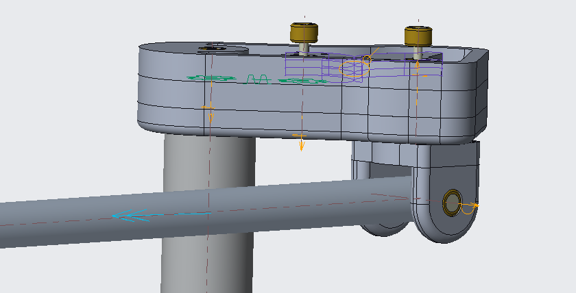

The jewels are fascinating, but even if the 3DTOY of a toy has only the color, I do not think they are suitable. First because jewels are high precision mechanisms and here instead loads are not in axis, and second because when the arm is handled the stresses can be harsh.
In this new arm I use a threaded rivet as seat of the cup grain, and this because threaded plastic can not withstand continuous adjustments (normally unuseful, just set up the grain and brake it with a drop of loctite)

With your arm the main load, the mass of the arm, WILL mainly be axially aligned with the bearings. There will be a torsional element due to the cantilevered style of construction. Stylus drag will be insignificant. With my arm the load is almost exactly at 90° to the axis of the bearings and yet they still function flawlessly. I have had no issues regarding the ruggedness of the bearings during normal use or set up/alignment. Many manufacturers use jewelled bearings with tungsten carbide pivots, Graham, origin live, thales to name a few. Commercial arms have to be Trump proof in their ruggedness.
The small amount of give inherent in the 3D printed components will make adjusting the bearings relatively easy. My bearings are mounted in acrylic blocks which is admittedly harder than most printable plastics. I have had no issues despite multiple bearing swaps and adjustments. The addition of threaded inserts would solve this problem and would probably act to improve mechanical grounding.
Don't write off jewelled bearings, they would be the final icing on the cake.

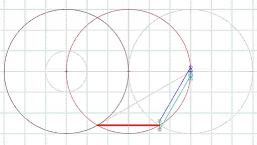

Found this: follows the Thales circle, moves parallel, is feasible. For now seems completely useless for our goals, but who knows...

I know they are at top, Niffy, but the plastic 3D TOY is completely another tale. Add that the cantilever is 2.5 times the height, so the torsion is relevant: maybe better to rely to the spherical joint of a ball pen nib, than to an improper side friction.

new?? - 2
Well, not completely useless (attachments)

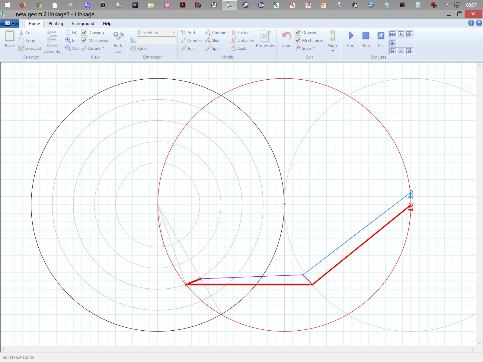

After the Syrinx fail i never gave up with the "extensible arm" Thales solution: this is very far from a real working tonearm (3 pivots+string link are beyond my taste), needs more geometric refinement, but maybe deserve to be further investigated.

On the extending arm idea. I'm not entirely happy with a design that relies on stylus drag to power the extension of the arm to keeps the cartridge aligned.
With a modestly eccentric record, where the cartridge has to move the back and forth by half a millimetre, the arm will spend only about 54% of the time moving to the left and 46% moving to the right. When moving to the right to arm has to shorten against the pull of the stylus. The only other force acting is the side force on the stylus due to the movement of the groove, the same side force that moves the arm in a conventional pivoted arm. This side force will have to now both move the arm to the right and shorten the arm against the pull of the stylus. This will of course require a greater side force.
Ideally the side force required to move the arm should be equal for movement both to the left and to the right. The magnitude of the side force, of course, needs to be as low as possible hence the search for ultra low friction bearings.

Thanks, Niffy, for pointing out the eccentricity issues. Maybe there are much greater problems around: all those joints - a nightmare - the points of application of the forces, far from ideal.
Don't know if it can work, but I was so pleased to finally find an extensible arm without linear bearings that I could not resist to post it.
Only geometry, for now

* no. not parallel: it took a lot of work of Doug, 2wice and me to find the best levers ratio (measures on the linkage file)
