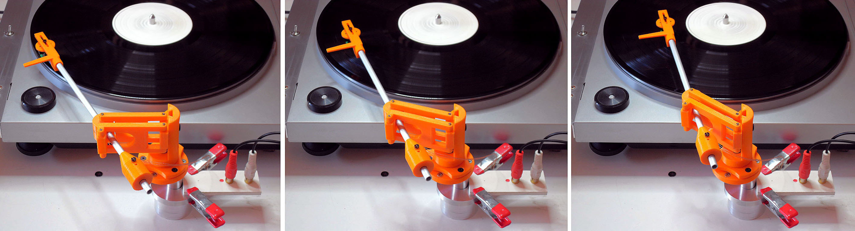

Hello nocdplz, working means you intalled it on a turntable, and played LPs with it?
Of course, otherwise i'would not post - i've done this design hoping someone will replicate with little effort - Photos in action not yet done (TT must be moved in another room)
All bearings are made with ball pen tips rotating against a brass concave grain You'll find lots of examples in this and other's threads (epsecially used for unipivots)
Skating force, as you and others have taught us, will be there. Refer to graphic made for the Rabbit which has similar geometry.

Sorry, Billshury: here we are diyers, not buyers. (nor sellers!)
So, first study carefully the project, take those STL files and get them properly printed.
Back home do all the rest of the work, refinishing the parts, mod the grains for the articulations, drill the shaft and so on. Finally assemble it all . & have fun!
carlo
advice: absolutelely avoid electric tools, or you'll have to reprint many parts
carlo

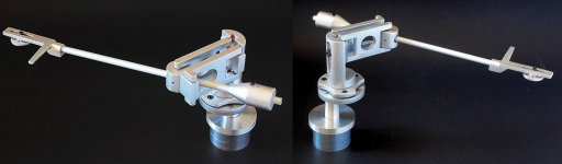

Sorry, Andy - I'm not able to answer, I can not understand the reasoning.
Patent (US2522997). looks like a polygon type, ancestor of the Garrard zero = zero offset, but variable overhang error, greater than the traditional arms.
Dynavector is an arm with traditional (Baerwald and others) offset, but with separate hor. and vert. pivots. It has some innovative merits, but not a different geometry.
You mention the "lowest-frequency disturbance" due to the RIAA eccentricity (0.050" - 1,27 mm) tolerance, and say that the Rabbit and the Birch would have one of 20mm. Related to what?
As you know the Thales circle determines the condition of orthogonality of the cantilever to the radius of the disk = 0 offset, 0 tracking error. If also the guiding could be aligned to the Hor. pivot there would be 0 skating force too. But since a true Thales with extensible arm (cathetus) seems really hard to build (I know something, with my wrong Syrinx PLT), the Birch geometry tries to follow that Thales circle, aligning the cantilever to the (now virtual) Thales pivot. With some tolerances, well discussed in the past.
Where lays the "disturbance" you are talking about? Really, without a graph I do not understand
ciao - Carlo
PS - I confess: do not like Birch type TA, because the driving force is completely off-axis. But with the small tracking forces available maybe they are the only ones able to move without an active servo.

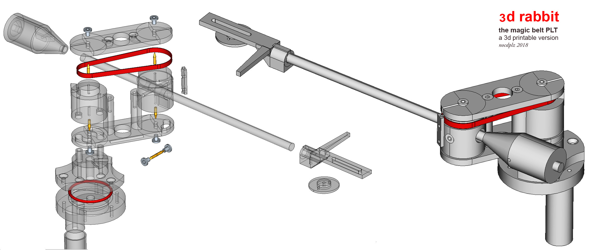

The rabbit owes much to the Dynavector and Birch arms.
The Rabbit is my variant of a Birch, driven by the relationship between angles at the two real pivots (belt + pulleys). For the Dynavector, I do not see anything to do with: tha Rabbit has no offset, no split pivots, no damping etc.
The new 3DTOY uses, in a compact design that avoids ball bearings, the double-arms Birch variant invented by Doug years ago.
The reason to design a 3D printable version is not altruism (thanks Walter), nor even the love for the Birch types with all their faults: is that after 1850 posts to count the real arms built in this thread with just one hand is really sad.
It would be time for many to put the hands on their ideas and show us the results. Science needs theories, but theories need experimentation - even for the small problems of our beloved tonearms
carlo

Me too, Doug- it's cute, but not serious: just to say "expensive? yes, only a bit cheaper than the famous golf-ball arm"
A trial to understand at what point the finish could be improved: unfortunately the acrylic coating weakens the PLA.
Here something more serious, (hope so): a 3d Rabbit in progress - with ballpen tips, that worked very well. (note your belt-stoppers - any advice?)
carlo

hi Doug - Ball pen tips bearings work beautifully on 3DTOY, with a friction similar to an honest traditional pivoted: the elasticity of plastic gives them the proper contact, with no chattering. Here we have 4 bearings instead of 8, but putting the belt on top will hopefully reduce the cantilever effect.
As i said, the honeycomb structure of printed parts reduces surprisingly the resonances, so 3d prints seems much better than could be thought - think something like a very rigid balsa (or samba) wood.
Hope that these printed arms will increase the number of experimenters (only 2, always the same, are boring). Designing a real, really working and right sounding PLT is not a joke, and not the joke that can be imagined in theory
carlo

Quote all you say, Niffy - which is one of the reasons to draw these arms: experience led me to think that arms and ball bearings hate working together.
The jewels are fascinating, but even if the 3DTOY of a toy has only the color, I do not think they are suitable. First because jewels are high precision mechanisms and here instead loads are not in axis, and second because when the arm is handled the stresses can be harsh.
In this new arm I use a threaded rivet as seat of the cup grain, and this because threaded plastic can not withstand continuous adjustments (normally unuseful, just set up the grain and brake it with a drop of loctite)
Hollow infill is introduced by the "slicer" program (eg CURA or SLIC3R) for printing - different shapes and densities can be set - Maybe the effect is to split resonances in thousands different frequencies.
carlo
