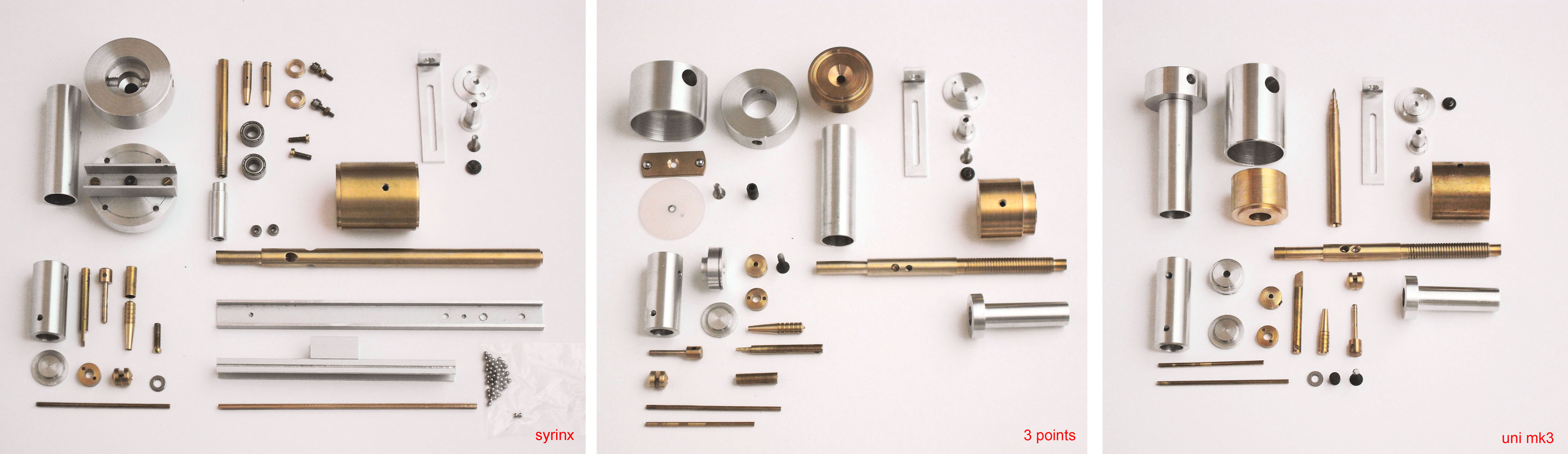

During WE, I've started turning the first parts of Syrinx (and of 3point, and of a "improved unipivot": the cleaning of the garage from chips takes more time than making parts ...), hope in a month or two to post the real arm (finally)

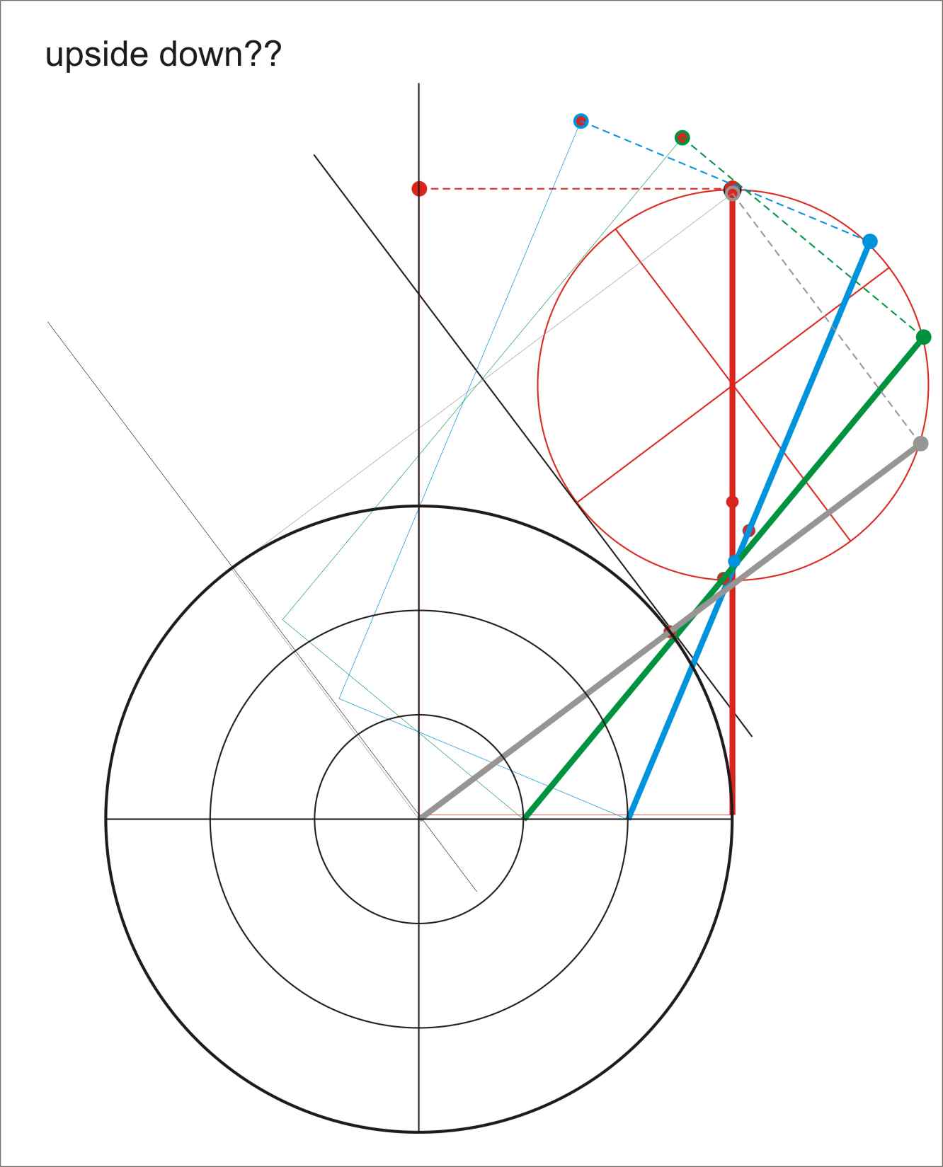

Walter. I turned it upside down - maybe too much, what a mess!

Dd : But a string can only pull but not push and when encountering eccentric record, will the string go slack? And when it gets to end of record will the horizontal rocking be dangerous to the stylus? Will a magnetic damping a la Dynavector style help?
I know almost nothing about Birch tonearms, could it work?

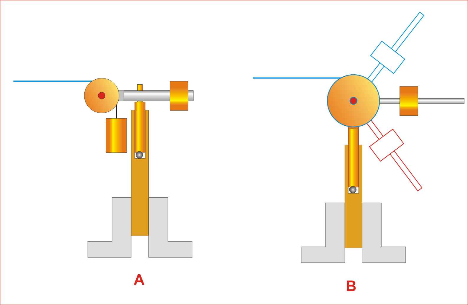

Solution A works like those of stringed Thales - a (swiveling) pulley and a small counterweight
Solution B works like micro seiki proportional antiskating: pulling of the string it can increase (or decrease) the action
This way the string would'nt slack, and the cartrige gets a bit of protection from damage

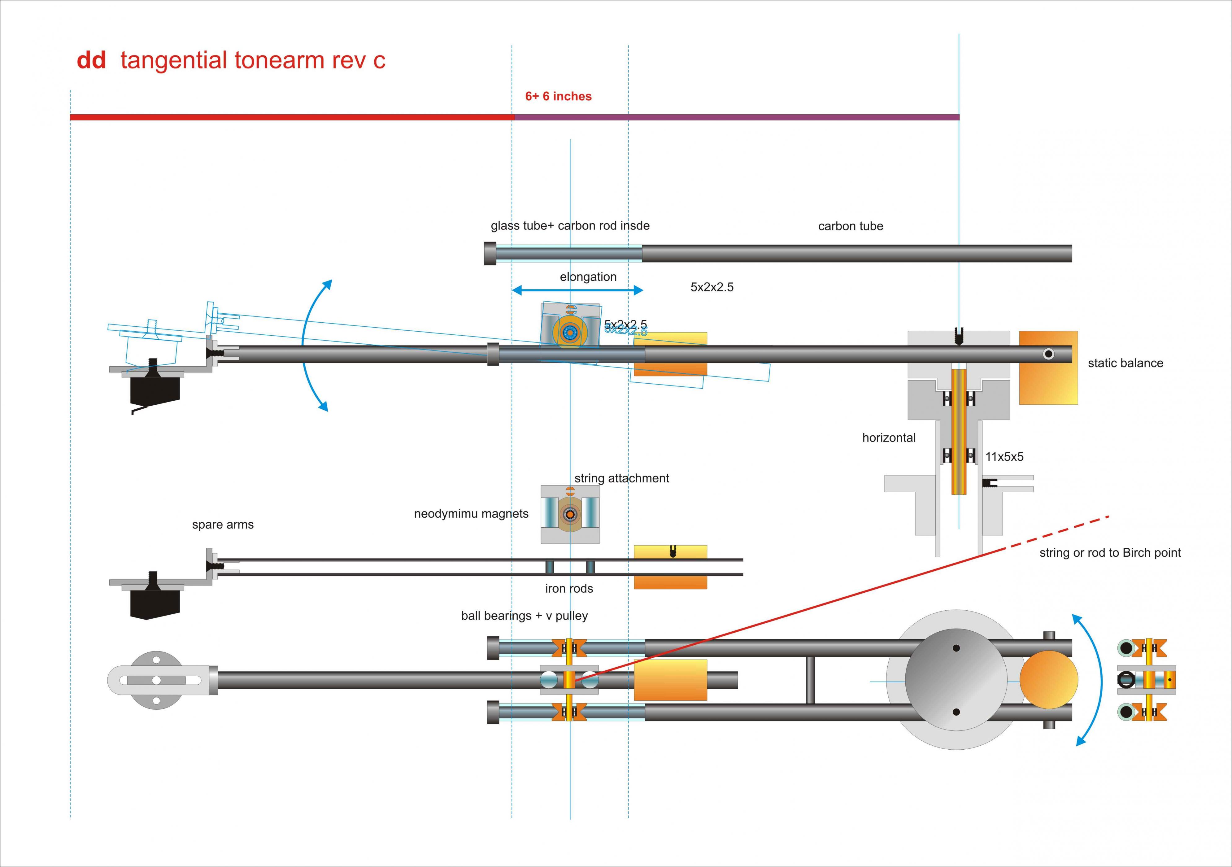

some mods on your last posts - What do you think?
Nice drawing, Carlo! I like the slim style design. The detachable vertical arm from the magnets is a nice touch. However, the string needs to be attached to the midpoint (center of rotation) of the axle, the back magnet gets in the way. I would use three spherical magnets, one front, two back, so the string can be tied to the axle. And the three magnets allows for azimuth adjustment for the vertical arm. The front end of the rods need to be connected so you won't ring like a tuning fork and perhaps we can implement an arm holder there. Keep tweaking!

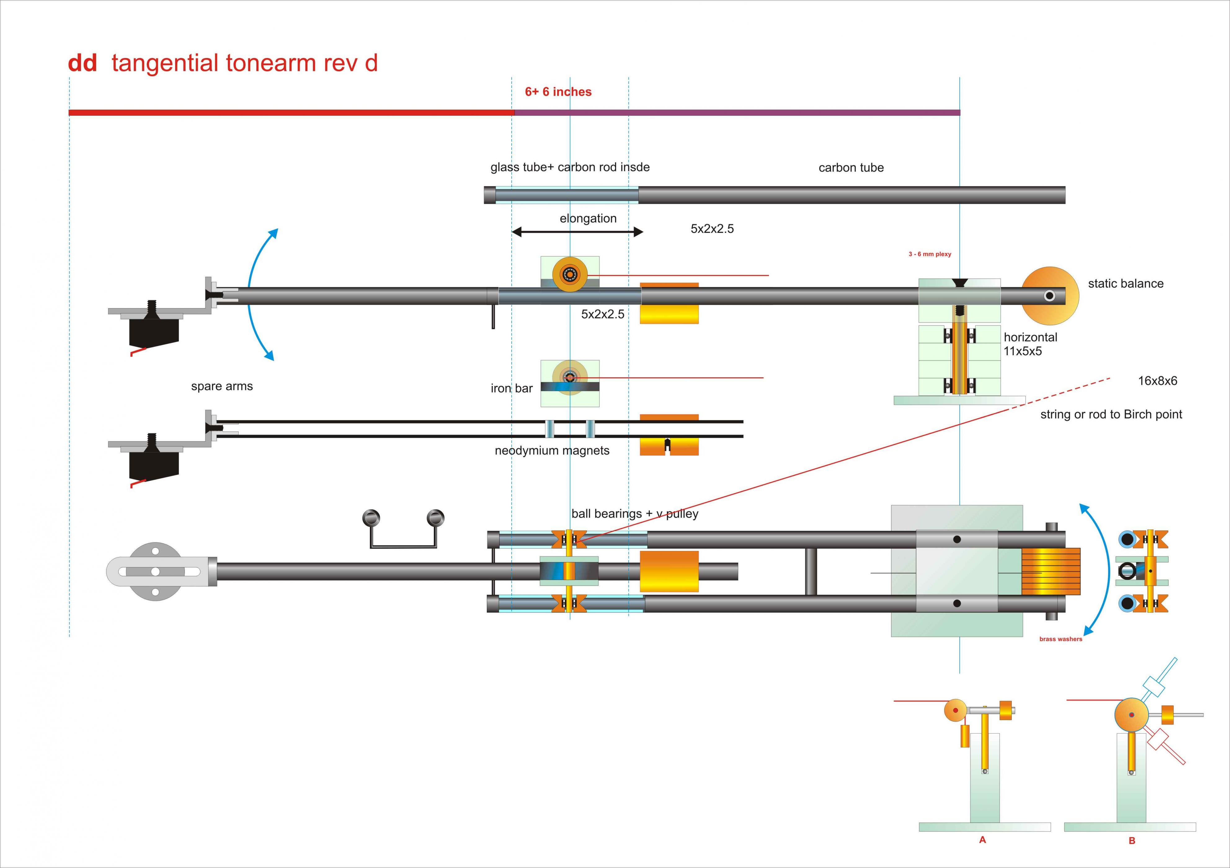

Carlo, I think I like how you have the magnets but have to drop the entire veryical arm assembly just an inch lower from the horizontal bars so the back magnet is clear from the string tie point. My previous arrangement of 3 magnets makes changing arm requiring azimuth readjustment every time, not convenient. The front of the rods should still be connected.
Easy mods, Dd - sorry, the wrong string point was a bad mistake!
yes, if you use spherical magnets the sub-arm is allowed to roll (not so good! the azimuth can be regulated once, and for that cartridge, with the headshell - shaft screw ) - this new solution (magnets on sub arm) for clearing the string hooking may work without lowering more the arm from it's pivot (not so good!)
Added the front connection too, but maybe you under evaluate how the carbon is strong (and dull adds someone, not me)
I've designed this easier plexy version: tools needed just a small circular saw and a drill press (+ some skill)
doubt - near magnets may alter low current signals? i don' think so, but will ask my son..
The string has to be the midpoint of the axle, vertically and horizontally. See picture below.
Maybe we have to be careful about the magnets affecting the tiny signal wires, especially threading through magnet holes.
If I dispense the idea of removable armwand, I would simply implement something like this clamping system that allows for azimuth adjustment.
The front connection between the rods should be above the vertical arm and can be used as arm holder. Maybe some flip-able magnet?
Happy tweaking!

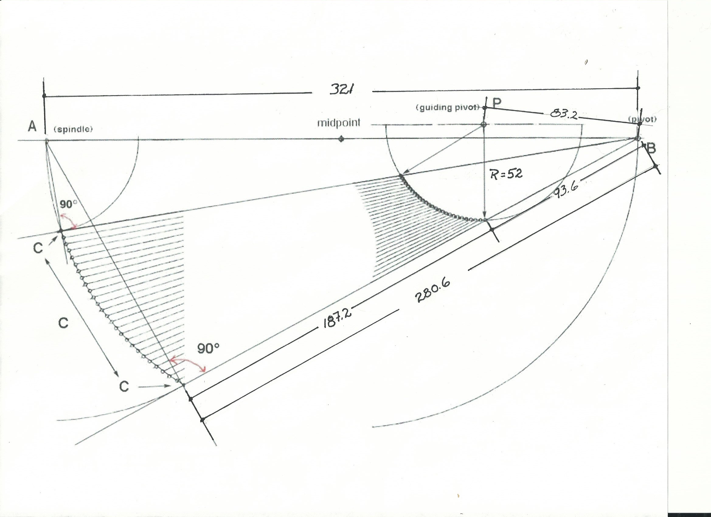

Can anyone tell distance involved in Birch geometry ? That is...
(A) Spindal to (P) Guiding Pivot
(P) to (B) Pivot
(D) Thread fix pivot on Wand to (C) Stylus Point.
Thanks.

string - yes of course Dd - Damn, i've moved down the arm in drawing, but not the string toghether; It's a mistake not a mod, difficult to tie it to a rolling bearing!
But what happens at the other end of the string, at guiding point? info needed
magnets - a permanent field influences electrons in a gas, not in a copper connector (they must move only from one atom of copper to another). So the only concern is to fix the wires, because - in theory - the variable field generated by the signal could make them vibrate (attraction - repulsion towards the magnet).
azimuth - that system seems heavy, if made in the position where we have to put it (> hor. eff. mass)
connection - good idea, that can be made also from that position (eg. with an eccentric clip) but same perplexities as above. My idea, since there is no lifter, was to prevent the stylus from plunging on the plinth

Hi DD,
I fear that your current design is going to suffer from lateral instability where the vertical arm rests on the two round rails. I think that the contact points in the grooves in the bearings are not going to be sufficiently rigid to prevent any lateral rotation at this point. (The groove will allow a little rotation before rolling) Any play in the bearings will also allow a small amount of lateral rotation. I would also recommend against ball race bearings if at all possible due to the aforementioned chatter.

Hiten,
Since the spindle to platter rim distance is 152.4 MM, I found the scale of the drawing to an actual platter is 1-1.3 and got the other numbers from that. I think the measurements are accurate or close.
With a smaller Thales A - B diameter , the arm B - C could possibly be as short as 200 MM before the guiding pivot P is too close to the platter. 280 mm is a good tonearm length, but if you want a longer one, just make the A - B diameter larger. A birch design much larger than 280 mm will need a large plinth. Once the Thales circle size and guide pivot position are chosen, the rest is determined by the geometry.

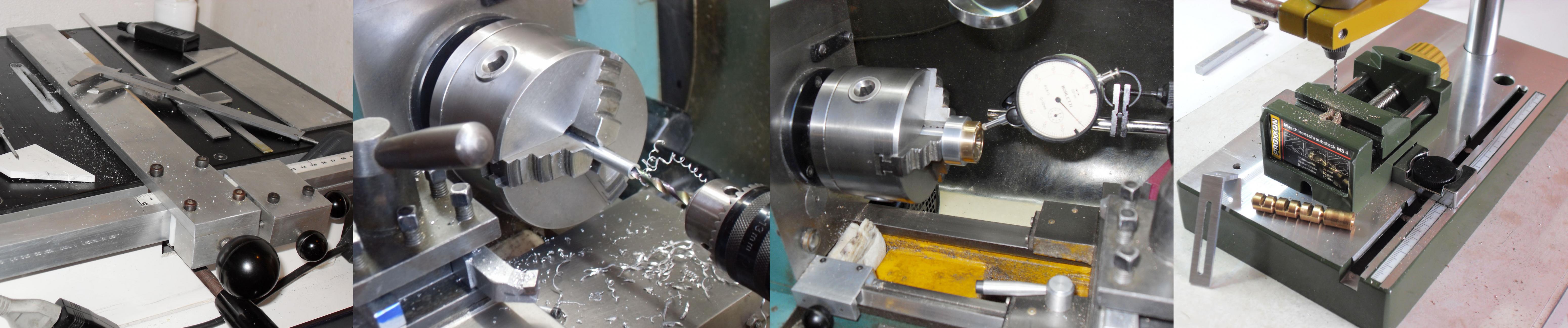

measuring & cutting, measuring & turning, measuring & drilling, measuring & threading, measuring & measuring ...
Just two or three (hundreds?) parts prior finishing. polishing, assembling, cabling ...(and testing!). I'll let you know.

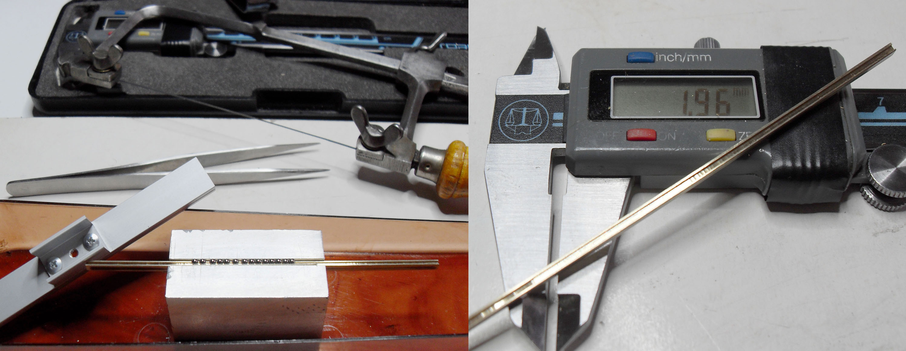

Carlo,
You made those channels with a table saw? I don't think I have the nerve to try that. Do the balls ride on the inner edge of the channel walls?

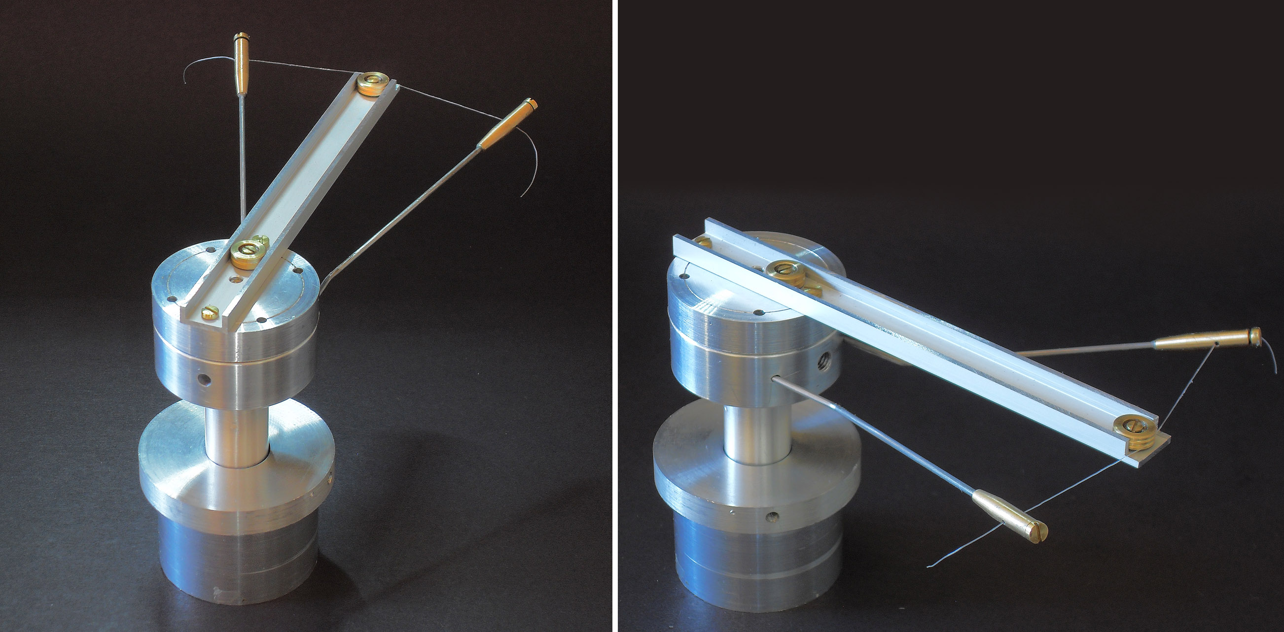

Yes, that in the picture: a small table saw built many years ago, very precise - then there was nothing like that to buy, and maybe not even now. A friend has the Proxxon, but it is designed for wood, not for metals.
Better using friends than their machines, to learn quicklier!
There is some progress, but as you know, this is the stage where all the errors or inaccuracies occur: the string gadget works really fine, in fact the friction is just that of the two (thanks!) ball bearings, because the string has no movement.
Problems maybe will come from the linear bearing: the balls flow very well into the grooves, but the tolerances are tight, and the register screws will be crucial.
Now, having no mill (and no intention of buying one) I have to wait the 15x15 bar to end the Syrinx: in the meantime I'm fighting with "3 Points".
