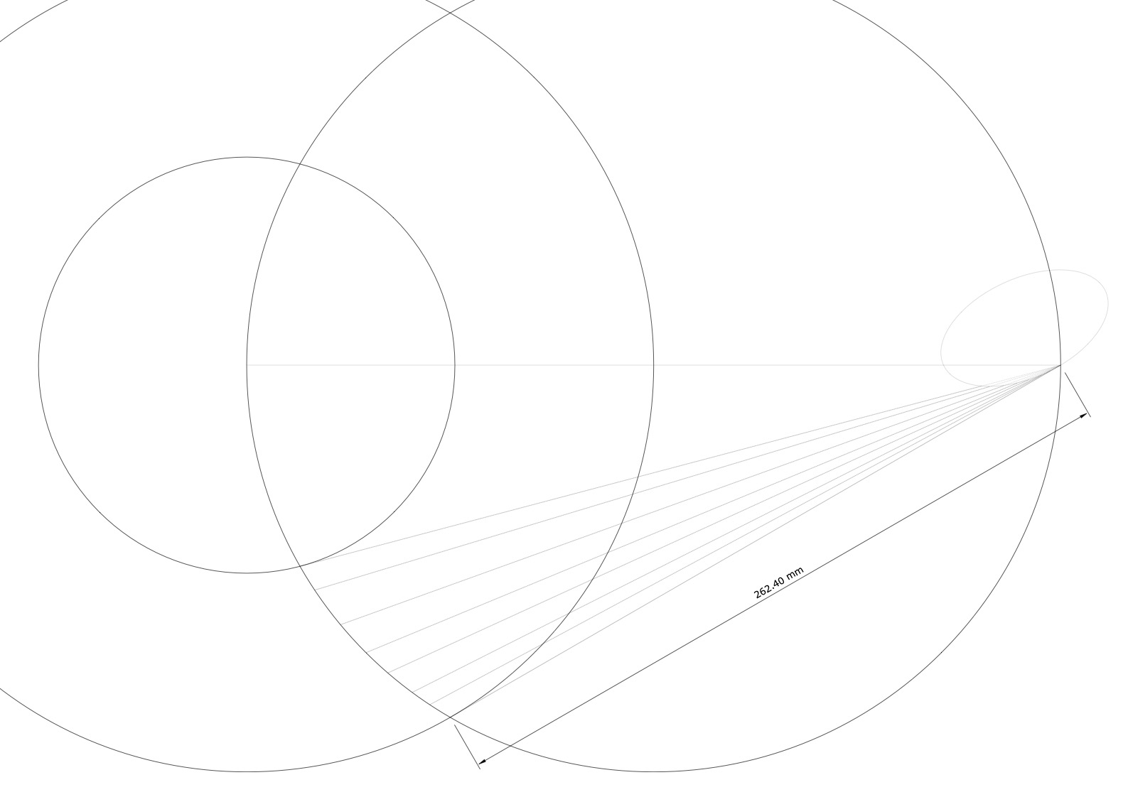

I constructed some geometry from a recent thread with a 250mm "arm" length as below.
Fitting a circle can only be done using 3 point constraints and results in the known tangency errors.
An ellipse can be fit to all the point constraints, and can be expressed as a simple function.
Below the construction geometry for the ellipse, it is orange because the centre, minor and major axis are not defined and are only constrained to the endpoints of the tangent lines of equal lengths.
In fact, no matter where, or what size I draw the Thales circle, it results in a perfect ellipse that can be expressed as a simple function, every time.
Same Thales constructiuon.
Now this does seem to make my first statement false, because if there is an ellipse on all Thales/LP geometry and there is one in my geometry, mine is based on the Thales/LP geometry also.
I feel fairly confident to say that any Thales circle related to another circle by tangent lines of equal length, will result in an ellipse that lies coincident on all end points of the tangent lines of equal length, and I think I know why.
I'm willing to bet that if you place the foci of an ellipse on the centres of the Thales and LP circle with a relation to the diameters of the circles, you might get a scaled ellipse, will have to think on this a bit more though.

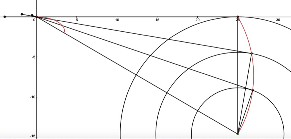

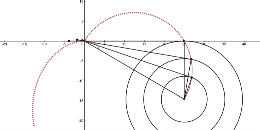

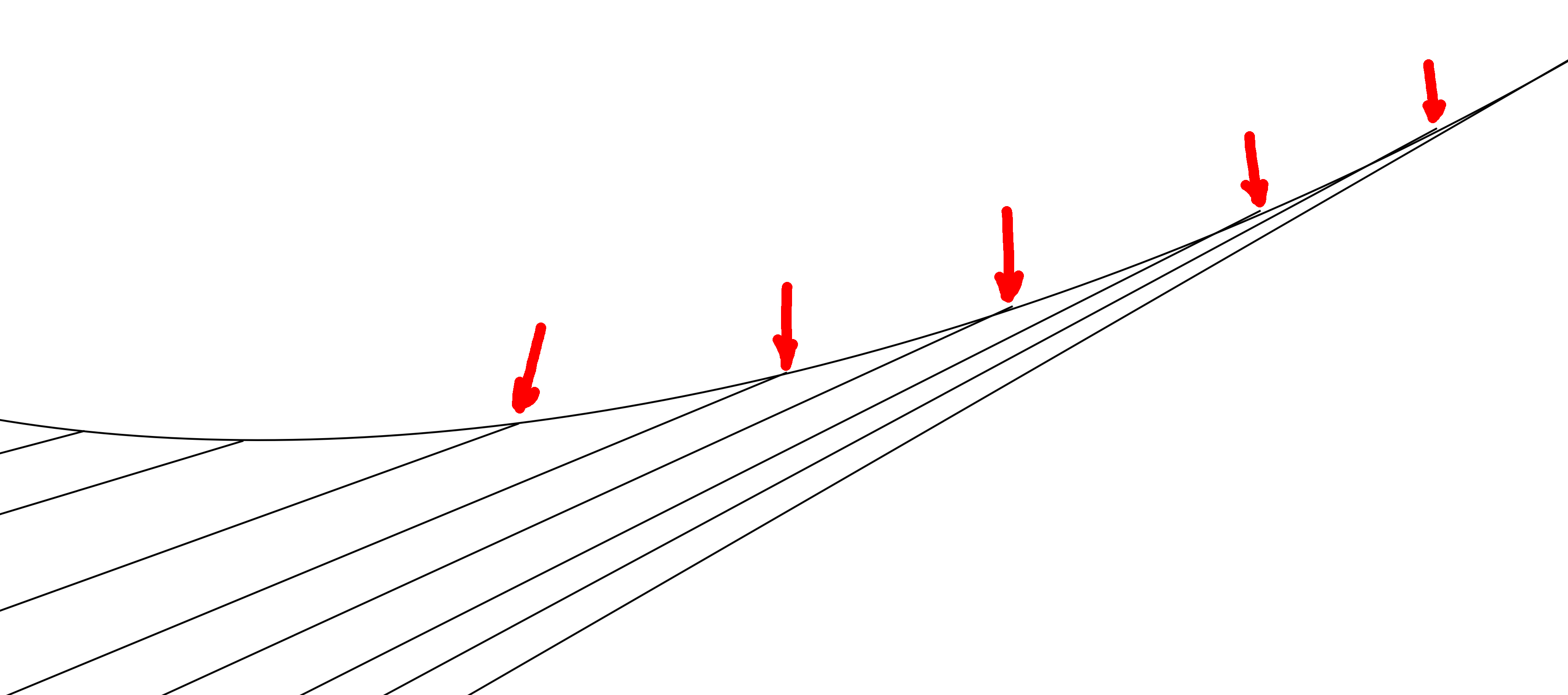

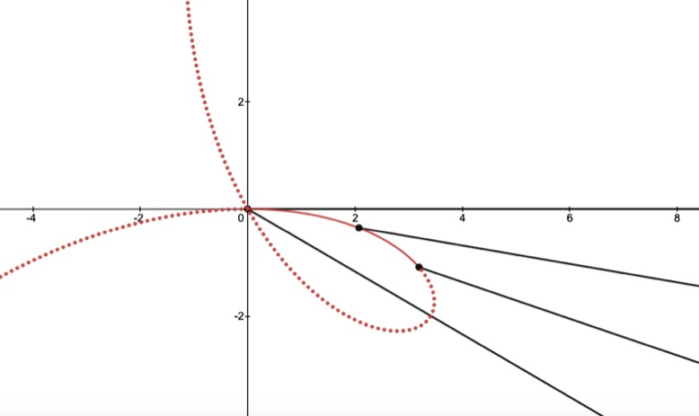

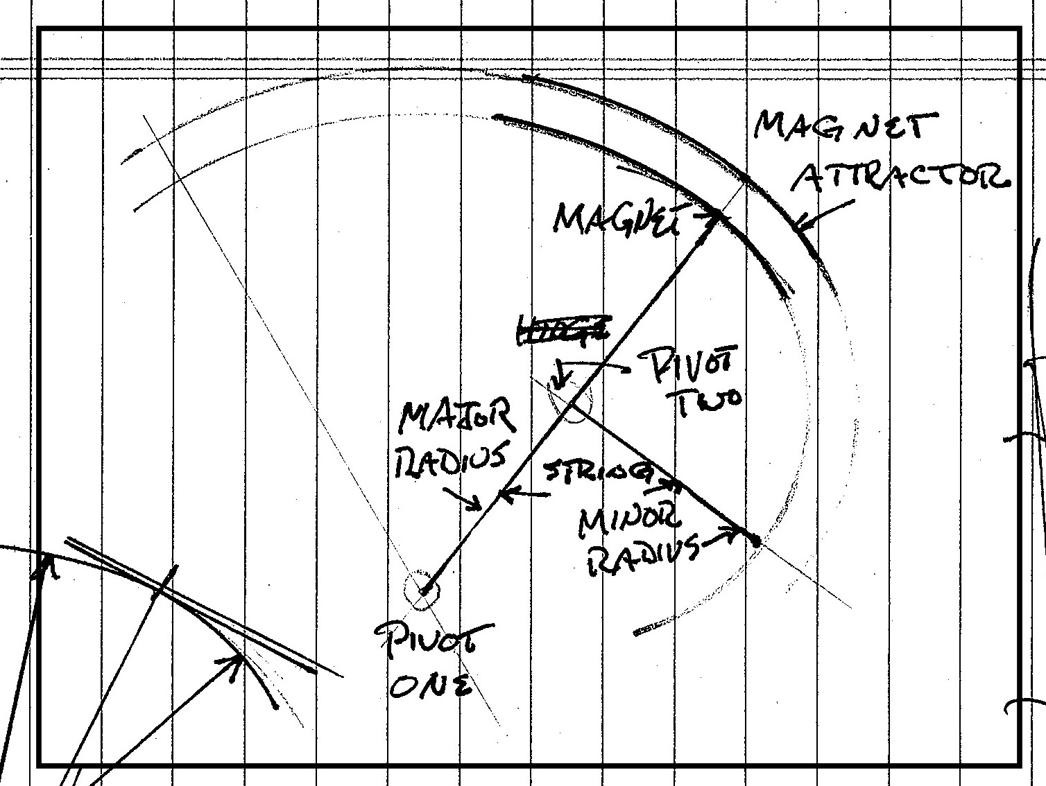

I was messing around with ellipses last week and came up with this drawing. Frank Schroeder hinted at the possibility of a way to replace the control arm in the two arm design, and it's bearings, with a string and magnet. He also said it might be possible to achieve an ellipse.
The attached drawing of an arbitrary ellipse shows how that might be built.

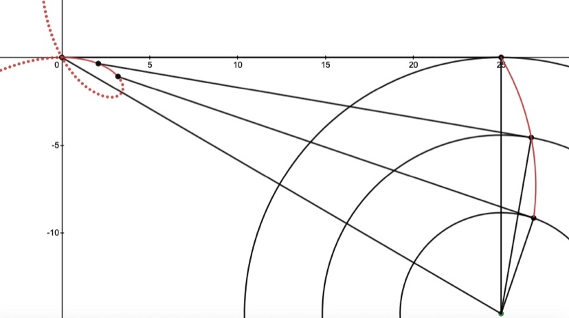

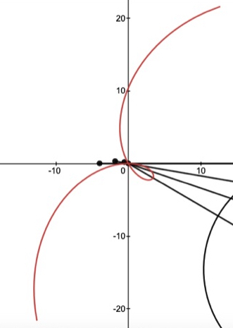

The tonearm has effective length 25 cm at the outer groove, stylus follows the Thales circle (solid red). The pivot point initially at the origin follows a prescribed path (solid red). Extending the plots to the complete Thales semi-circle (dotted red) we get the pivot path (dotted red).
I don’t see any ellipses for the pivot path. Am I missing something here?
Extending the pivot path for stylus on the Thales circle off the LP area, produces something much more exotic.
I have been trying to get the ellipse, but no success. I can say that it is very close to an ellipse just as it is very close to a circle. In other words, if an ellipse works, so is a circle. I didn't use 250 mm effective length since I think it makes no difference.
I don't know why it is not working for you, but I do notice that all the points not coincident are on one side of your ellipse, so it seems your ellipse is not scaling correctly to fit?
Please see OP, perhaps you missed that I'm only concerned with the end points of equal lengths that lie between the 1st and last groove.
Those points consistently fit an ellipse.

The diagrams below show the actual Thales pivot path with tonearm length 25 cm between pivot and stylus locations.
Now that it can be seen that the path concerned is a portion of the of the actual pivot path which is very different from an ellipse, maybe there is little justification for using an ellipse apart from maybe ease of calculation. It is impossible for EVERY line of length 25 cm from the Thales circle towards the pivot to lie on an ellipse. It is only possible for every line to lie on the actual pivot path. I guess it all hinges on the meaning of "consistently fit"
I don't understand what is meant by this.Those circle/crosses are coincident constraints in the real sense of the word.
EVERY line of length 25 cm from the Thales circle towards the pivot BETWEEN THE FIRST AND LAST GROOVE lie on an ellipse.
FTFY
Consistently fit = always fits
Every single line of length on a 250mm arm that I tried, lies on the curve. If you would like me to plot the lines for any another radius, I'll do that for you.

Every single end point is coincident to the ellipse, it lies on the curve, exactly. The ellipse is constrained by those points.
I only use those points between the first and last groove, and care nothing for any other points. You can plot the curve outside that, but it has no purpose for me.

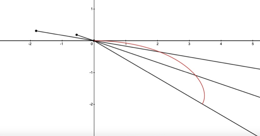

I am still suspicious that it is not an ellipse, so, I tried it again. Please see the diagram. This time I used 250 mm as effective length.
Here is the diagram to show you the detail.
You can see that there are errors. I connected all the endpoints of the tonearm and got the lt. blue area. The solid black line around the blue area is the ellipse. Clearly, not all the endpoints are located on the ellipse.
In the analysis above, I didn’t consider the playable area of a record. Now, let me introduce that factor. So, I will choose the endpoints within the playable area of record only.
Here is the detailed diagram. You may see the endpoints of the arm fit the ellipse much better now.
However, it is still not perfect. There are still some errors. For practical purposes, I would agree that the path of the endpoints fits roughly A SECTION OF AN ELLIPSE. In reality, the direction and the position of such an ellipse are important since an ellipse is directional. I wouldn't agree that the path of the endpoints IS an ellipse.
