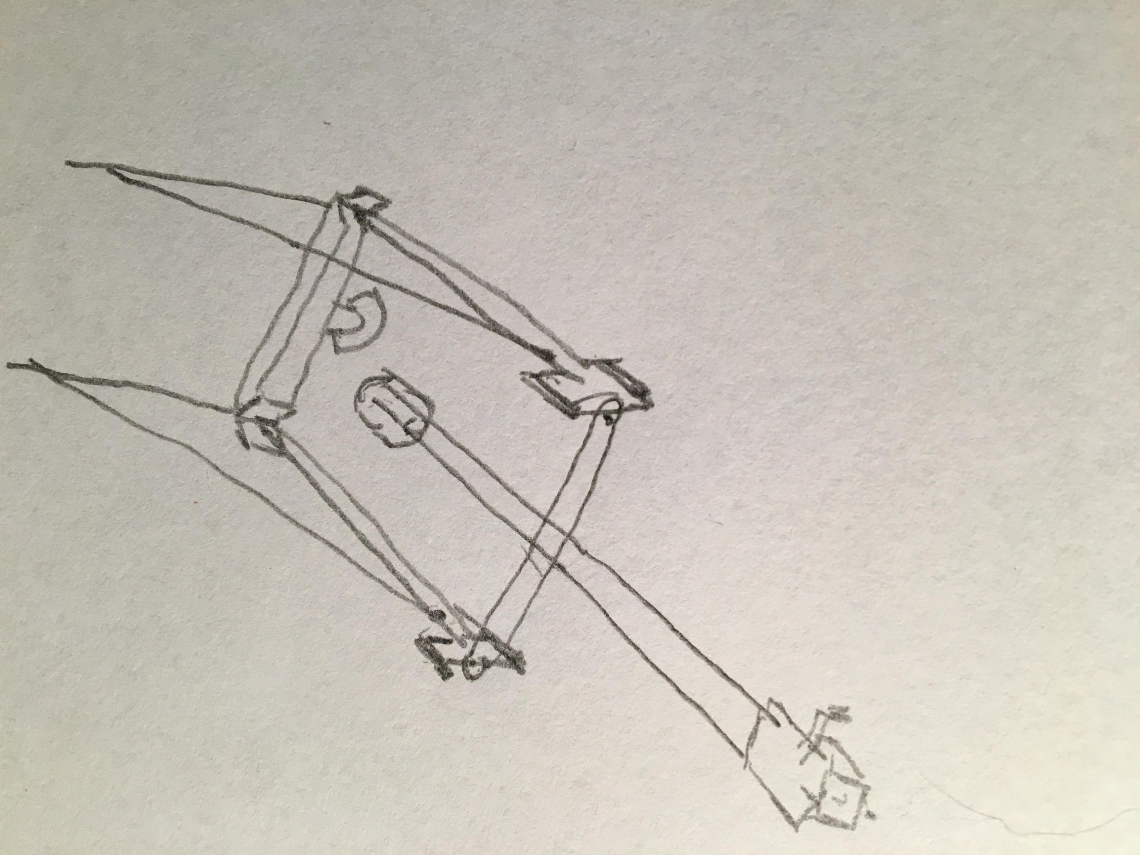

Hi Dampdau,
I Like you propositive approach, but I am not able to provide technical suggestions for your two proposal as for my limited skill the technical question is too complex to have well tuned in a steady way so many strings.
Perhaps some more technical skilled guys here can provide suggestions.
Sorry.
Rgds
Adelmo
