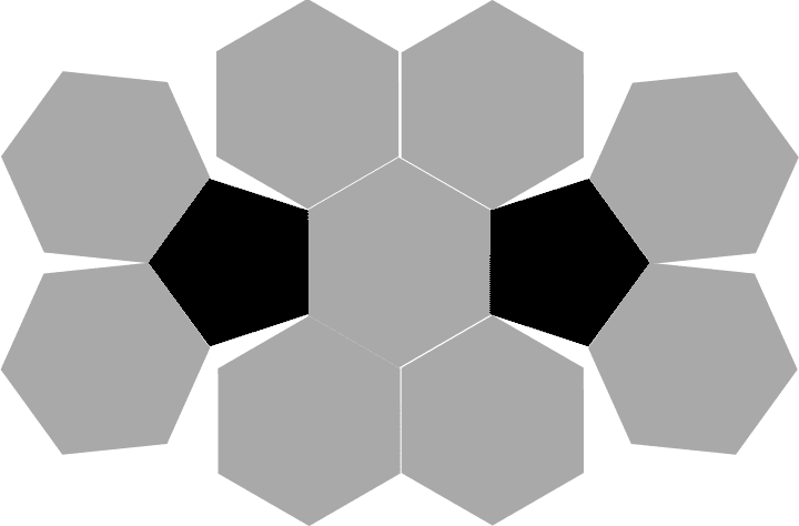

:hohoho: Stepping into the middle of this conversation here are a few of my thoughts, Determining the length and final mouth size should be the easiest part of this equation. Whether it is a single cell horn or a 16-cell multicell the mathematics will be the same. As long as you are following the model of the equal cells you just divide the cross-sectional area at any point by the number of cells.
Where is it written in stone that the cell need to be rectangular or squared in shape? Remember that when they made the original Altec Multi-cell horns that there was a limit to what materials they had to work with. This also limited what they did with the cross-sectional shape changes. There are many other ways that the shape change can happen and inner and outer cells can be different in cross-sectional change while the overall expansion rate of combined cell area is identical for the final cutoff frequency.
Nowhere. I've often thought about hex cells, like a honey comb, or a combination of shapes, like the skin of a football. (soccer).

Absolutely! Back in the '60s I designed slot car parts for awhile and we had this huge, old plastic molding machine, but for all its size it couldn't make parts much bigger than a motor end bell, but I had audio wet dreams about a house size one that could mold massive multi-cells made from Delrin with 64 or more cells starting with ~0.2" diameter throats.

1005:
  • Axial length =15.5"
  • Mouth = 6.25" wide, 4 sides
  • Throat = unknown, but between 0.75" and 1"
x = axial length distance from throat where area doubles.
0.75" square throat:
length 15.496
multiplier 6.117
length (x) 2.533
k 0.274
Am 39.063
At 0.563
Fc 295.00
SoS 13,548.00
1" square throat:
length 15.498
multiplier 5.288
length (x) 2.931
k 0.237
Am 39.063
At 1.000
Fc 255.00
SoS 13,548.00
I just found out that converting/inputting the areas and length into HR displays Fc in the F12 window [though insignificantly different due to conversion, different SoS than the one Altec listed] and allows one to choose axial length 'x' when exporting the design data, saving one from oddball fractions, so seems the easiest way overall to get all the layout particulars.
