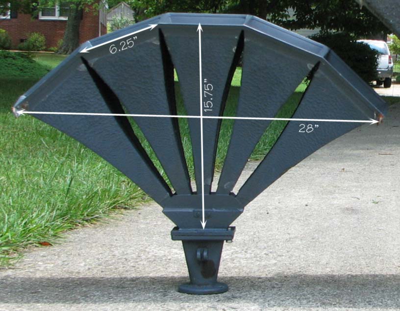

1005 = 10 cells in 2 rows of 5?
6.25" is 15.875 cm so that would be 79.3...cm wide. According to this (http://www.voiceofthetheatre.com/images/multicell.3.jpg) width is 30"/5 = cells should be 6" :confused:
Correct!
6.25" is 15.875 cm so that would be 79.3...cm wide. According to this (http://www.voiceofthetheatre.com/images/multicell.3.jpg) width is 30"/5 = cells should be 6" :confused:[/QUOTE]
The front is curved. Add an extra 1/4" to each cell and you'll see the curve. From mounting tab to tab it's 28". But along the curved face between the 2 rows it's closer to 34".

Yeah I meant anont the front edge.
Ah ok. The other photo must have been taken around noon with the sun shining down on them (the shadow on the ground confirms) It cast a shadow from what is a very fine difference in height according to the 2nd photo.
An genuine trick of the light!

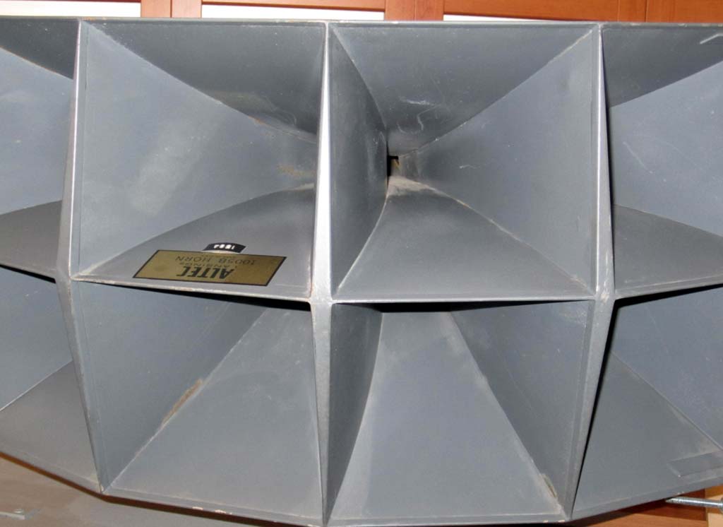

If you look closely at the photo in post #650, you can see that the cells were joined by a metal strip that follows the edge. That's how they are held together across the width. I suppose you could use tape.
There is one top and bottom and another in the center. The center one may be easier to see.
I can confirm the measurements of the 1803 against the literature. The mouth openings are the same but I didn't realize the horn sections were longer than the 1505. I thought it was just 1 more row. Learned something today. :)
Also, Michael your width measure doesn't take into account the extra width at the center of the horn which according to the Altec lit., is an inch more either side. Mine measures 42" at the tabs and 44" at the center

Correct, but what about the horn expansion itself? IOW, are they all ~perfectly symmetrical sighting down the center-line or do they bend with at least one side being straighter?
Another thing I just thought of is that back when Steve and I were discussing these, we were talking about the old tar filled horns. I've no experience with the Aquaplas coated units, so wonder if Altec over time did a bit more cost cutting and began using just one cell shape.
