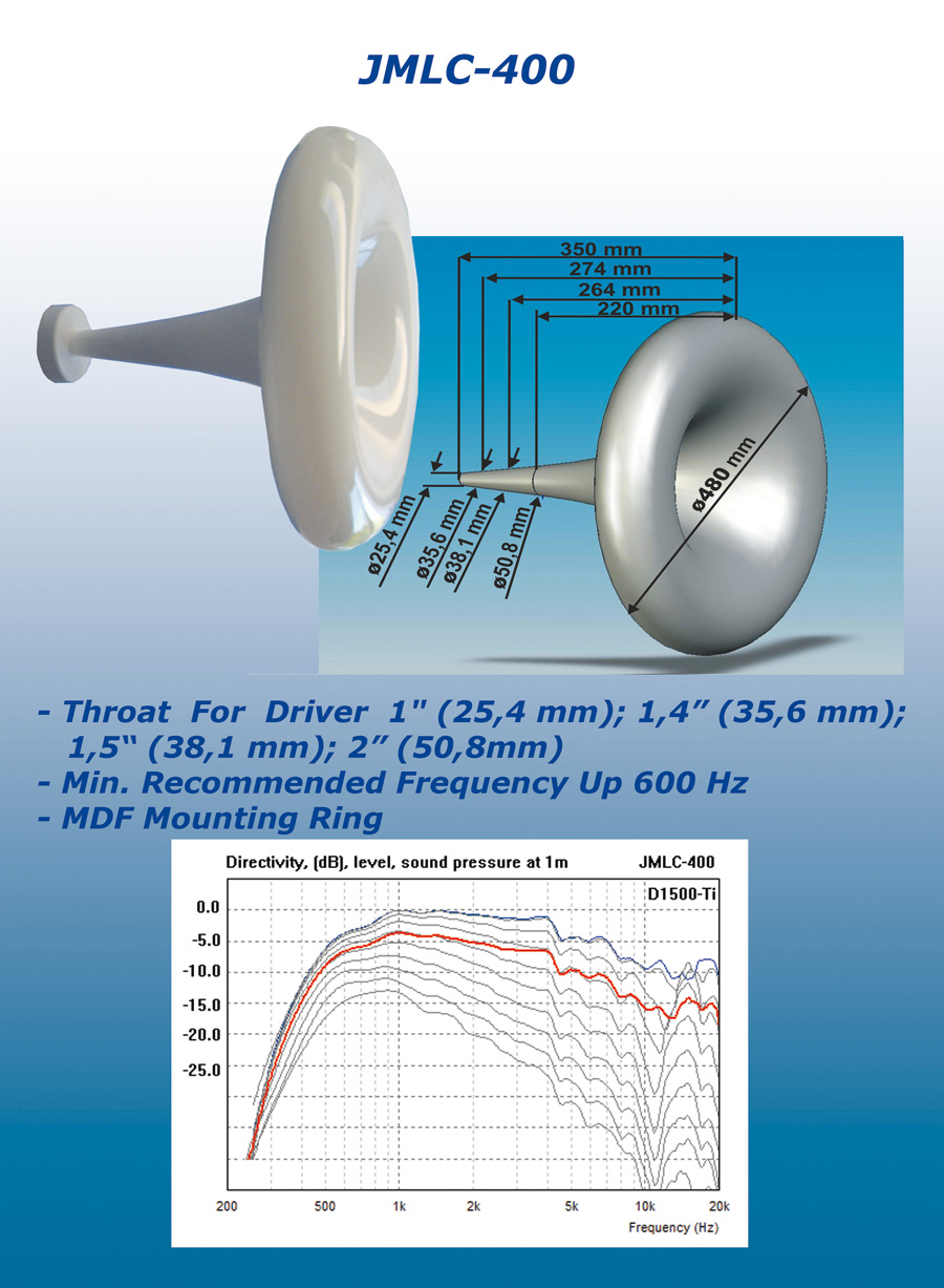

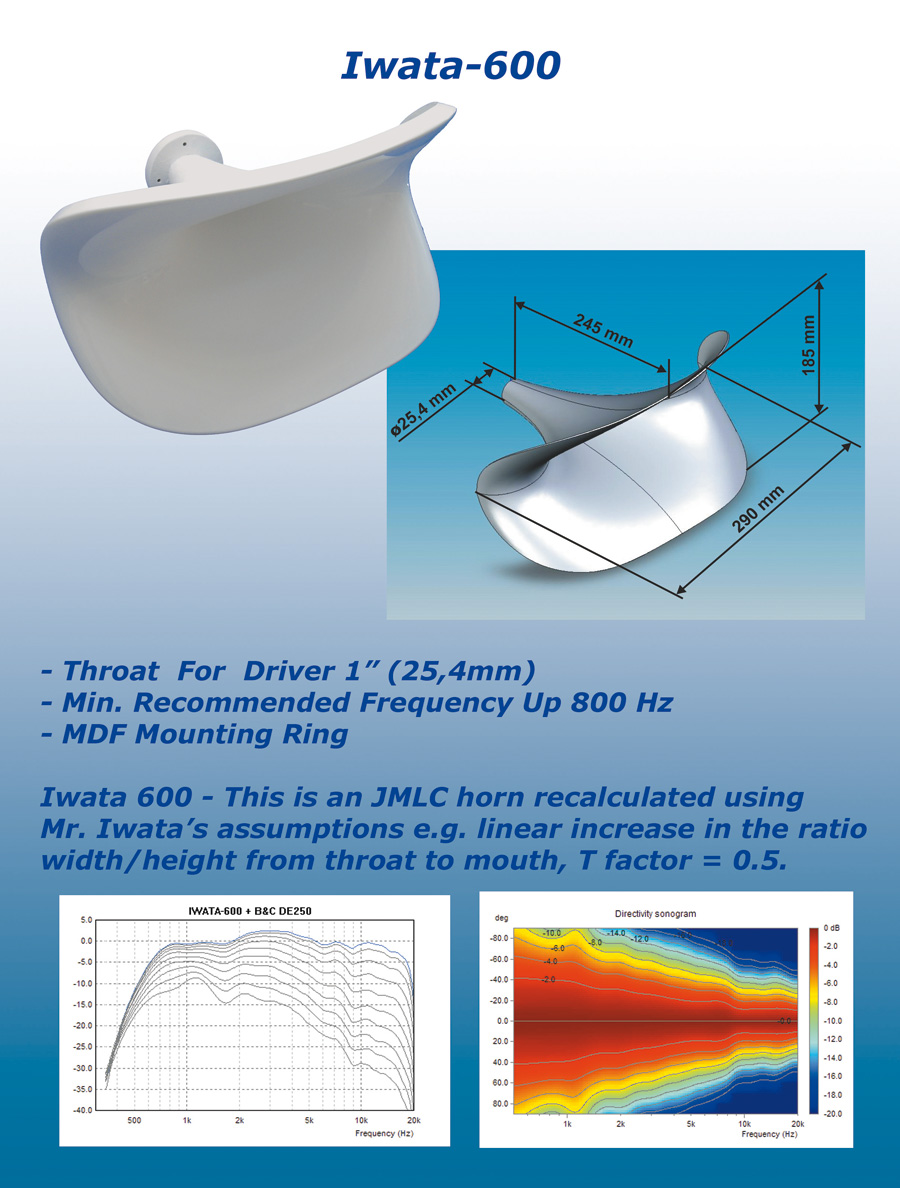

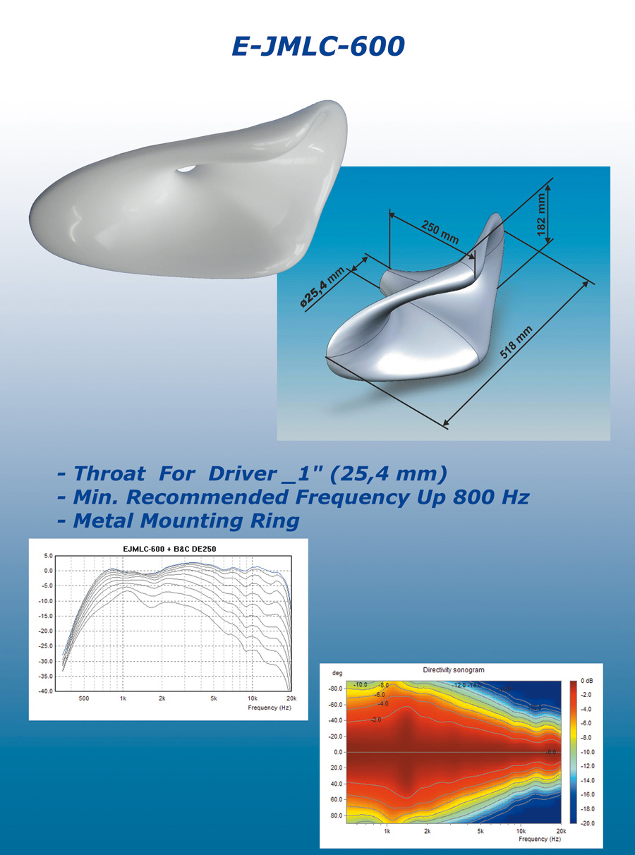

Quick but of research on the horns. Here are the data sheets for a selection. This is to help me out a bit.
The respnse curves I assume that smoother is better and the ones that drop off at higher freq will need some form of lift or another UHF driver?

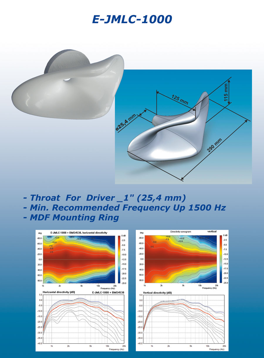

To me the little Iwata 600 or the big ol' E-JMLC 600 look to be the best? Am i reading this right?

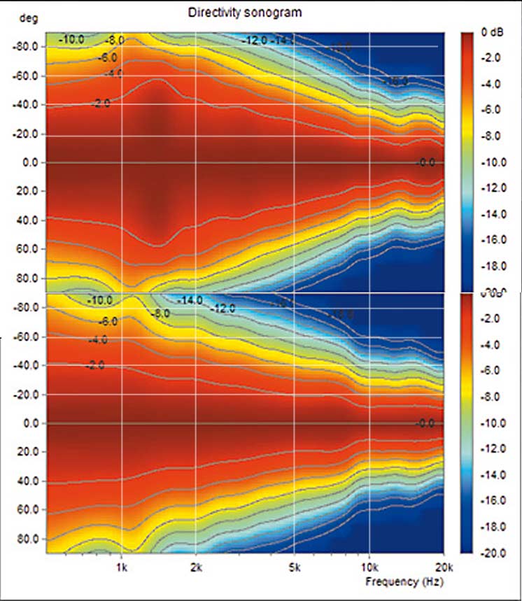

Oh, and can someone explain how the read the pretty coloured ones
Okay

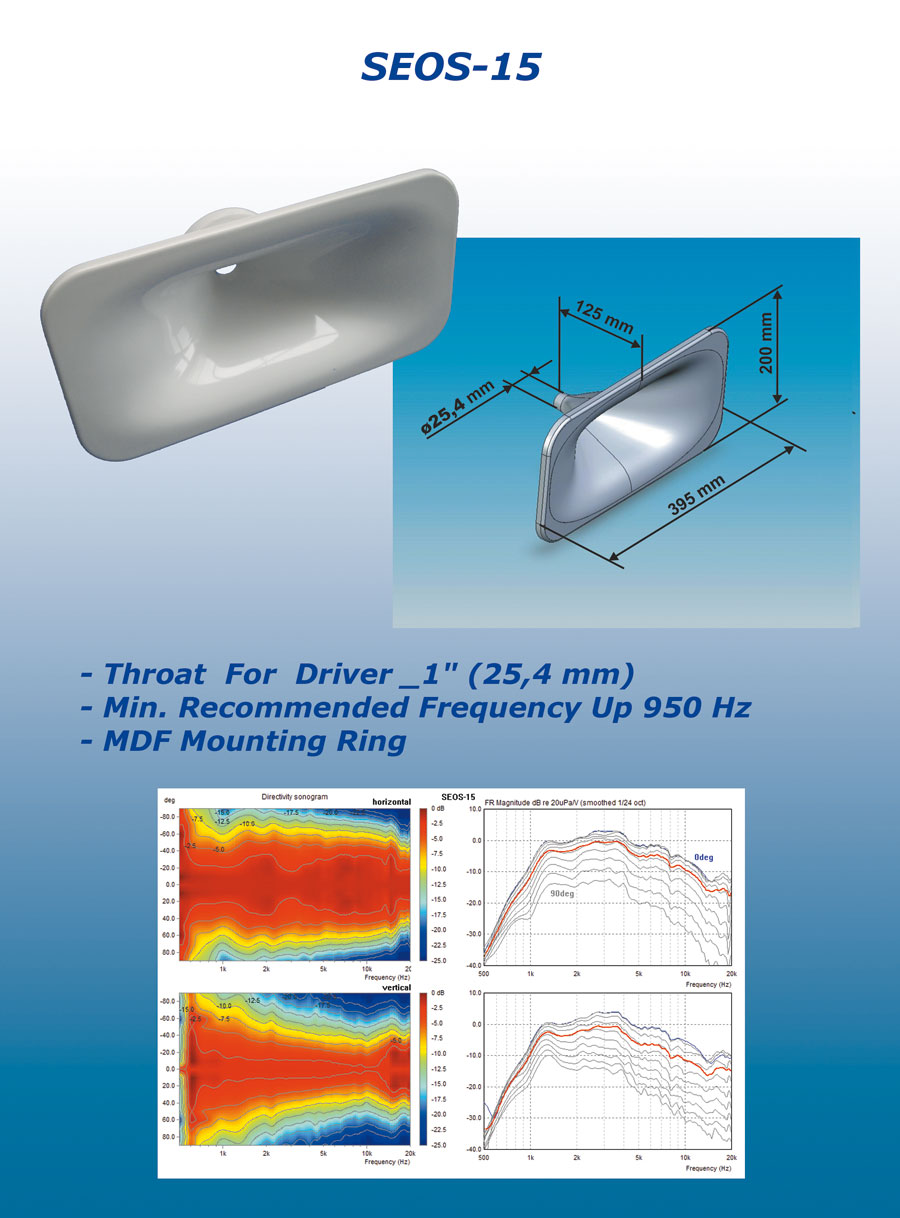

For the response graphs, the many traces, consecutively reduced in level, represent the response at many points away from directly in front of the horn; varying degrees off axis. A horn with a response that stays the same shape but falls in magnitude as you move off-axis has controlled directivity. It means that the sound doesn't change in tone as you move away from directly in front, it simply gets quieter. The horns don't have control over their entire range however, as it's related to their dimensions. As you get lower in frequency they will tend to lose control and the pattern widens.
The pretty, colourful graphs are 'polar', and are showing much the same information but in more detail.
Instead of, say, 0, 5, 10, 15, 20 degrees off axis, etc, as in the response graphs, they show a continuum. Bass frequencies are at the left end, treble at the right. 90 degrees to one side of the horn is at the top, and 90 to the other is at the bottom, and the colours represent intensity.
Take the Seos-15 polar graphs; the horizontal shows the the sound is projected over a beam of constant width between about 1.5kHz and 16kHz. It's slightly narrower at 1k, which means that when you're 50 degrees off axis, 1kHz will sound quieter than other frequencies. Above 16k, again the horn loses control and there will be little 18k+ past around 30 degrees off axis.
The vertical plot can be read exactly the same way but it represents above/below the directly-in-front point rather than side-to-side. You can see that the horn has little directivity control vertcally; as you stand up and sit down in front of it, the mid-highs will fall off and then come back in but the high treble won't.

Thanks for the effort in manipulating the images Pano. I think I'm getting it now
Okay. So as long as the charted response traces maintain the pattern of the 0deg trace it is simply getting quieter the farther off axis you go?

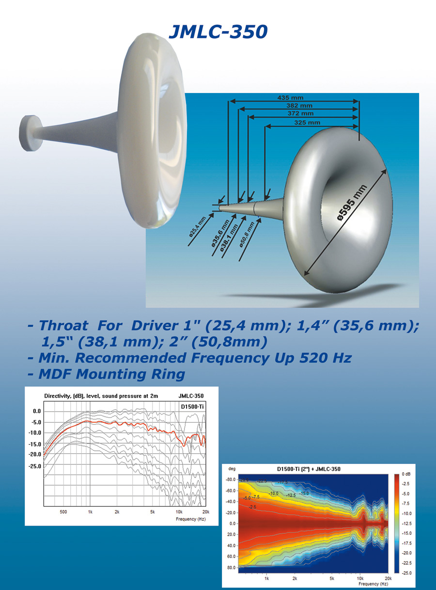

Does the shape of the trace in the first place have any bearing? For example JMLC-350 has a dropout around 10k (seen on both types of plot) - Iwata-600 seems to have a smooth, level trace on both the response and the polar plots - E-JMLC-1000 has a falling response at 0deg but the off centre traces show controlled directivity. Of the 3 does the Iwata have the most ideal response?
Thanks for taking the time derwhalfisch. If my thoughts above are correct I think I my have a basic grasp.........
Yes. And the spacing between each successive trace shows how attenuated it is compared to the last. An ideal situation has flat lines, each an equal distance below the one above.
You're right there, they show the output of the horn for a given constant input. (Usually 2.83volts, or 1 watt). Smoother is better, flatter seems best at first but there are other variables to consider with regards to your ideals and the brightness of your room, etc.
Which has the best response? It depends on what you're going to do with them. The SEOS-15 has the best directivity control, but not the cleanest response.... response, however, can be fixed with EQ and directivity cannot. If you were to flatten its on-axis response with EQ or filters then the off-axis would clean up as well, however electronics cannot fix the fact that the Iwata horns drop off more rapidly at higher frequences. That's an acoustic issue related to the shape. You need to make some decisions regarding the usage of these horns before you choose one ;P

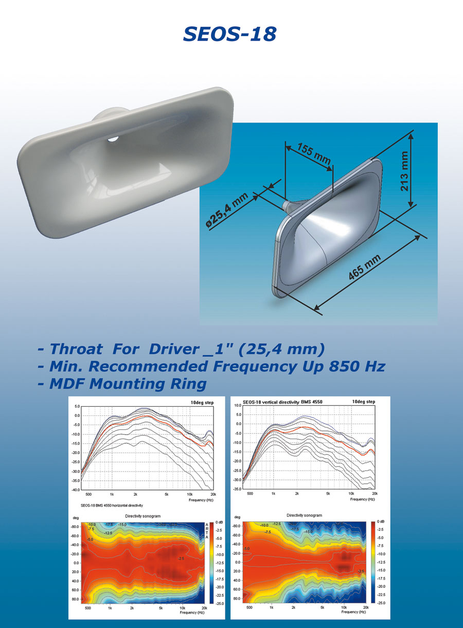

... however electronics cannot fix the fact that the Iwata horns drop off more rapidly at higher frequences.
I suppose its a 'picture' of changes in the directivity
but when listening on axis or just 30 degr off axis, then there would be no 'attenuation'/roll-off
One is slightly wider in the lower end then the other, that's all.
would that indicate there is more 'horn-effect'
and that you might expect a 'lift' when listening on axis

Ejmlc has twice as wide HF dispersion. Use it with DE500 or similar. Disadvantage? Carefully measure power reponse and equalize otherwise at some angles and higher loudnesses you can hear some midrange tonal abberrations. Much like waveguides. Iwata is easier to work with.

I assume (insert appropriate saying) the JMLC-400 would have a similar polar response to the JMLC-350 as no polar measurement is given for the 400? TBH the Iwata looks to have the better response, but the big kid in me loves the idea of a 48cm diameter horn in the livingroom!! (When people ask if we have kids I answer, 'yes me')
