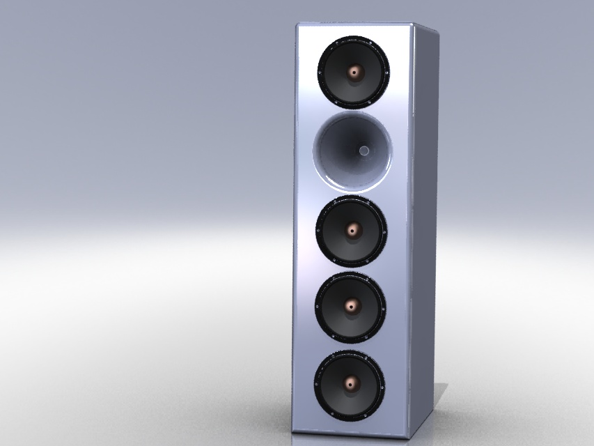

This is my conceptualization of the ultimate end all large speaker.
A kind of hybrid between the Elsinore the Gedlee and the Beyond the Arial.
Using 4 12 high efficiency woofer drivers and a integrated type of 1.4 large format horn. The system would probably need a tweeter also (not shown in the picture). All four woofers cover the bottom octaves and the upper two cover the mid/bass region. Not extremely big at about 20 inches wide by 68 inches tall and 28 inches deep. But very good sized.
The goal here is to have a total system sensitivity at or above 100 db.
