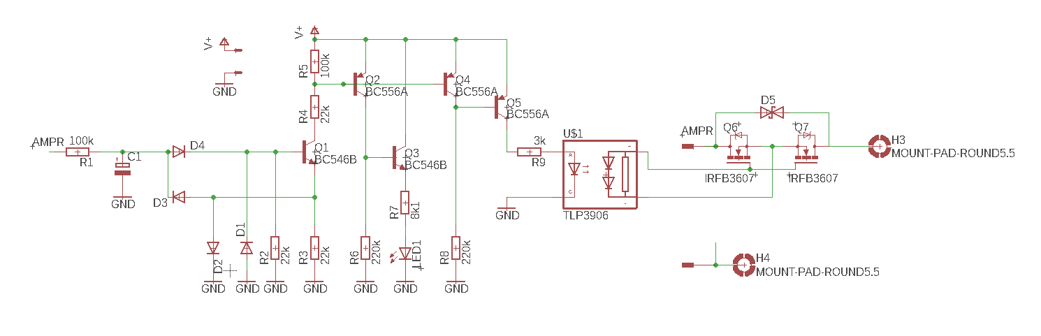

@quadfan66: sorry. As the dc protect really isn't that necessary on a lm3886, I've been putting it to the waiting list for too long indeed.
This schematic pretty much tells everything, it's a very simple board. It's a simplified version of the esp 33 board in many ways.
Some comments:
- C1 has to be a bipolar cap, voltage rating can be quite low since it never sees more than about 2V. A 10uF gives decent response.
- Q2-Q3, R6, R7, led1 is just a fault indicator. Not really needed. To be installed or not depending on what you want.
- all diodes are 1n4148. All resistors can be 1/2W.
- the optocoupler can also be the APV1121S
- D5 is a big TVS. Its working voltage must be a bit higher than your PS rails.
- with the version posted earlier, you have to be extra careful no to short the output lead to the binding post. Distances are a bit too small. I attach a new version of the board fixing that.

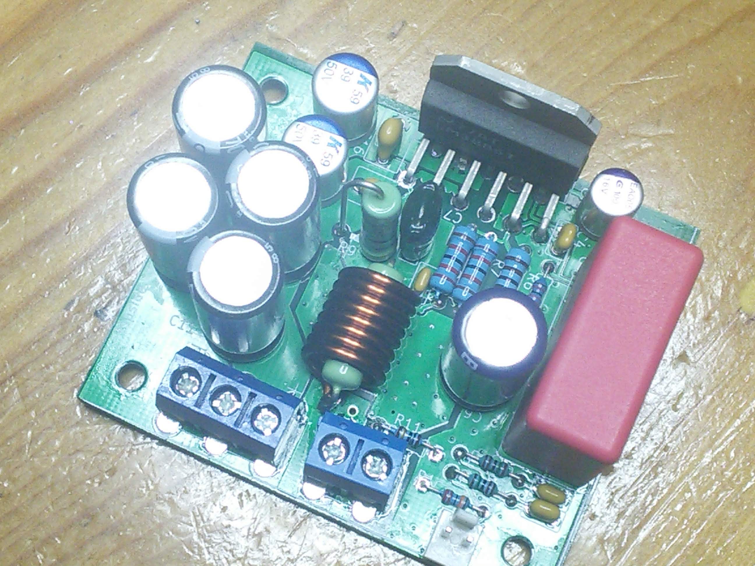

Hello 00940,
thanks for your work and the gerbers and a happy new year! Even if the ripple comes from the amp itself and not from your test assembly - it's 105 db under signal and I would not bother too much with this.
I just ordered some pcbs from JLCPCP. Could you please post a high resolution picture of an assembled board here? (would make the rebuild much easier, espacially concerning the mounting of the R/L Thiele combination).
Thanks in advance
Rüdiger
Not 00940, guessing he might be away, but here's mine (if the attachment works OK).
My inductor was calculated, not measured. It is 8 turns of 1.2mm wire on an 8mm former. The wire was too fat for the drill hole, so I soldered directly onto the resistor legs. My 2w resistors were slightly too long, so some careful forming of the leads was required.

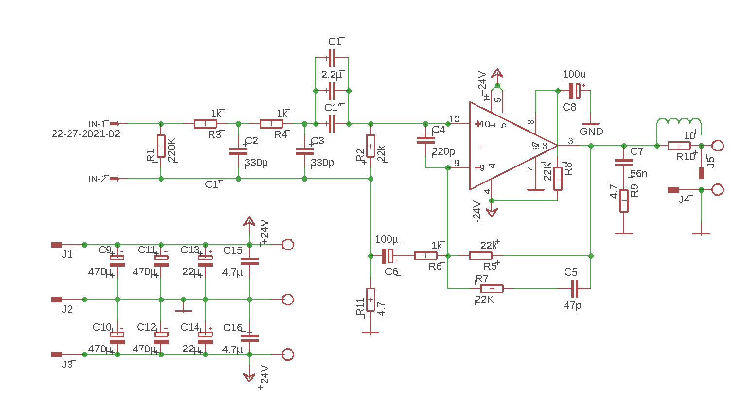

Ok, here's the schematic. A BOM from Mouser is attached somewhere earlier but here is a generic one.
C1 - 2.2µ - various footprint available - mkp or at least mks
C2/C3 - 330p/50V - 2.5mm spacing - C0G
C4 - 220p/50V - 2.5mm spacing - C0G
C5 - 47p/50V - 2.5mm spacing - C0G
C6 - 100µ/50V - 5mm spacing, 10mm diam - bipolar
C7 - 56n/100V - 5mm spacing - mks
C8 - 100u/16V - 2mm spacing, 5mm diam - cheap electro
C9/10/11/12 - 470µ/50V - 5mm spacing, 10mm diam - decent electro
C13/14 - 22µ/50V - 3.5mm spacing, 8mm diam - polymer cap
C15/16 - 4.7µ/100V - 5mm spacing - X7R
R1 - 220K - 1/8W
R2 - 22k - 1/8W
R3 - 1k - 1/8W
R4 - 1k - 1/8W
R5 - 22k - 1/2W
R6 - 1k - 1/2W
R7 - 22K - 1/2W
R8 - 22K - 1206 smd
R9 - 4.7 - 2W
R10 - 10 - 2W
R11 - 4.7 - 1/8W
U$1 - LM3886
Input connector is 2.5mm spacing, power and output connectors are either 6.3mm faston or 5.08mm spacing screw terminals
