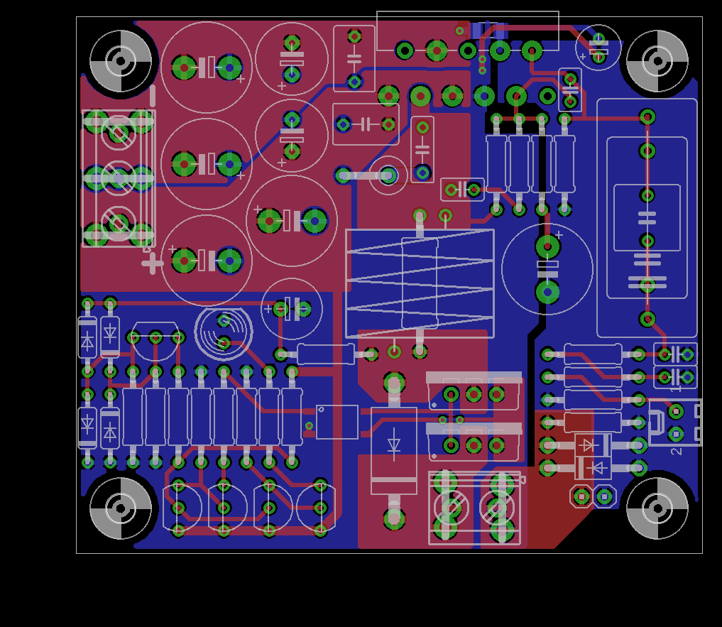

Something I've been toying with. Marginal improvements.
- Now the DC protection is onboard.
- All resistors are 10mm spacing (so no need to order small 1/8w resistors).
- Reverse parallel diodes can be fitted in // with the hum breaking resistor.
- That network can be jumpered.
- The board grew a bit to 60*70mm (from 50*65mm).

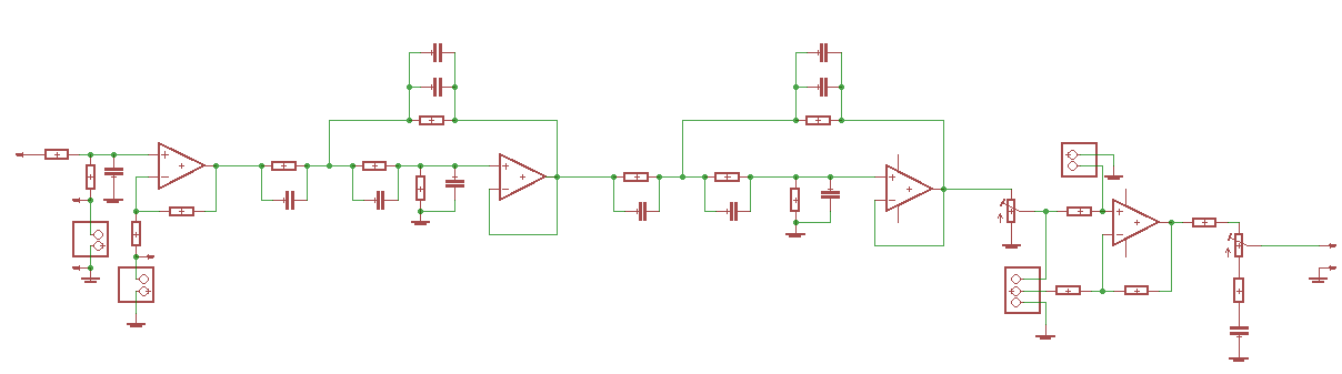

I should probably start a new thread but... what I'm working on currently is adding an opamp stage before the lm3886 on the same pcb, that could be used as either HPF or LPF LR4 filter to create a simple analog crossover and baffle step compensation. Something like 1/4 of the esp09. I think I can fit that in a 7*10cm pcb.
That's gonna be hard without using smd... 7*12cm seems more reasonable. Here is a first draft.
4 opamps sections, with quite a bit of flexibility. The board could be used for bridging, sub summing and filtering, an analog crossover, etc. My aim was to develop something I could easily stick into an active monitor.
- First one can be configured either as a simple buffer/gain stage, as a non inverting summing amp or as a balanced line receiver.
- The sections 2 and 3 (top opamp) can be configured as either hpf or lpf Sallen-Key filters, with 2.54 or 5.08mm spacing caps.
- The last section is a simple gain/buffer. It can be either inverting or non inverting.
Between 3 and 4, there is a level control and after 4 a BSC control.
For power, the idea is to tap the power lines, with a 24V to +/-12V dc-dc converter. 1W ones are quite cheap and sufficient here.

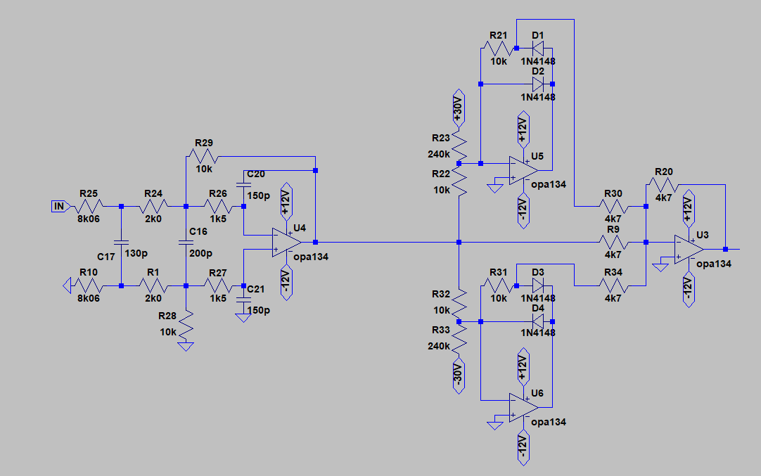

The designer wrote somewhere that it wouldn't be a big hit indeed but that he wanted to extract as much performance as he could out of his amp. That's why he also included the output relay inside the feedback loop and didn't include a clipping circuit. He also used a 4 layers board and designed the amp as a monoblock from the start.
This board is more modest, with 2 layers only, unregulated supplies, the protection mosfets outside the feedback and a clipping circuit at the input. Rather than the klever klipper from Cordell, I used the feedforward clipping circuit from D. Self. Alternative layouts can already be found on the Russian forum where the ZD50 was initially posted but they didn't exactly have what I wanted.

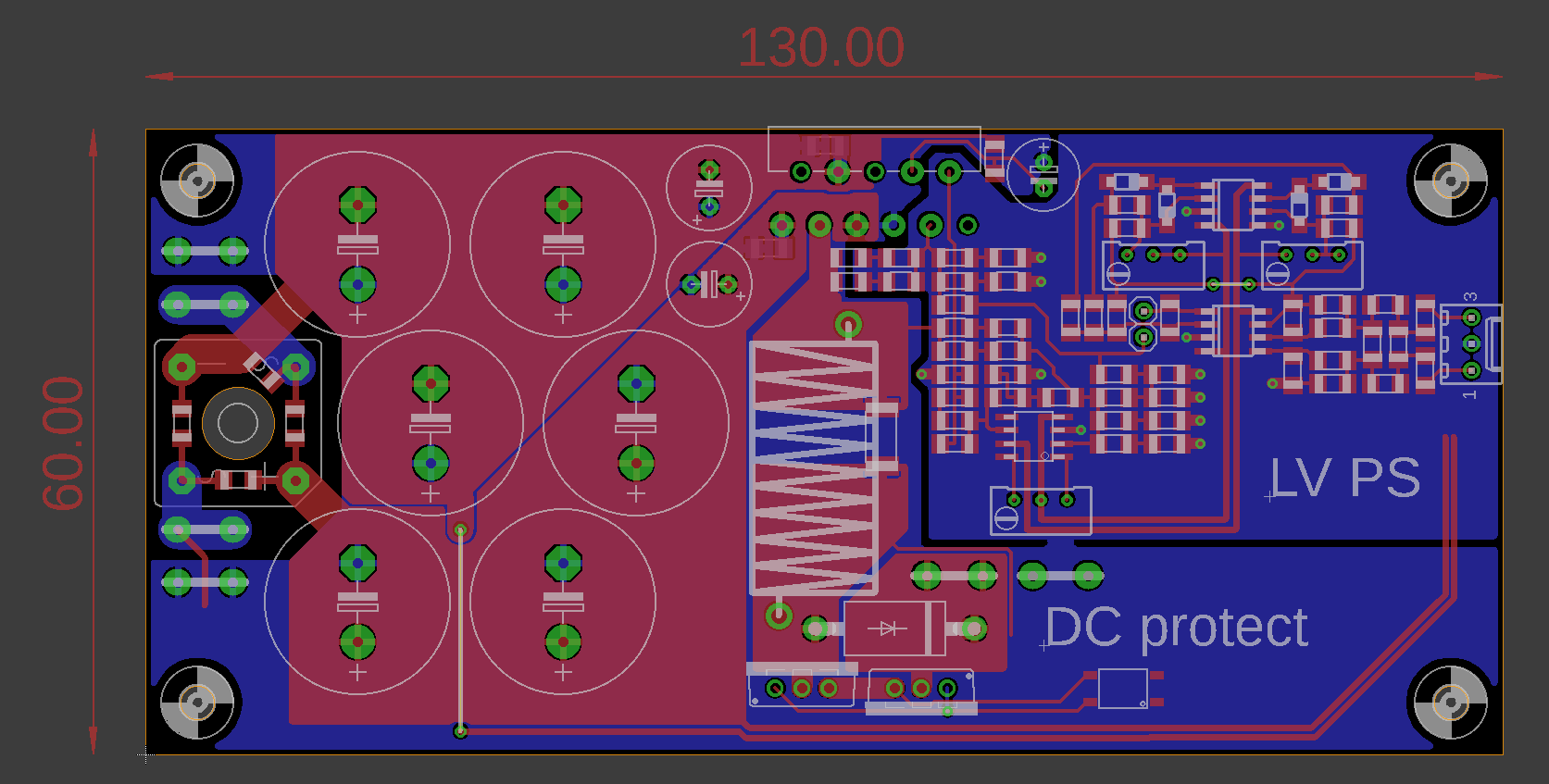

Joined 2018
I've sent the lm3886 files to smart proto. I should have the pcb on hand in one month or so...
Meanwhile, I redid the dc-protect board. I didn't like the format. This pcb is made to be directly mounted on standard 19mm pitch speaker posts. It's also mono. Having one detector for stereo only saves a few resistors and cheap transistors, not really a big deal.

In the zd50 I'm working on, I've included an external clipping circuitry. It is taken from D. Self and goes like attached. It has the great advantage of kicking in very precisely and being out of the way the rest of the time.
