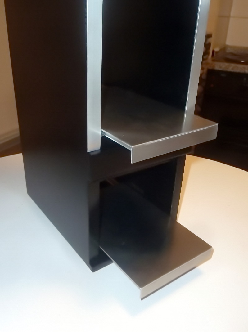

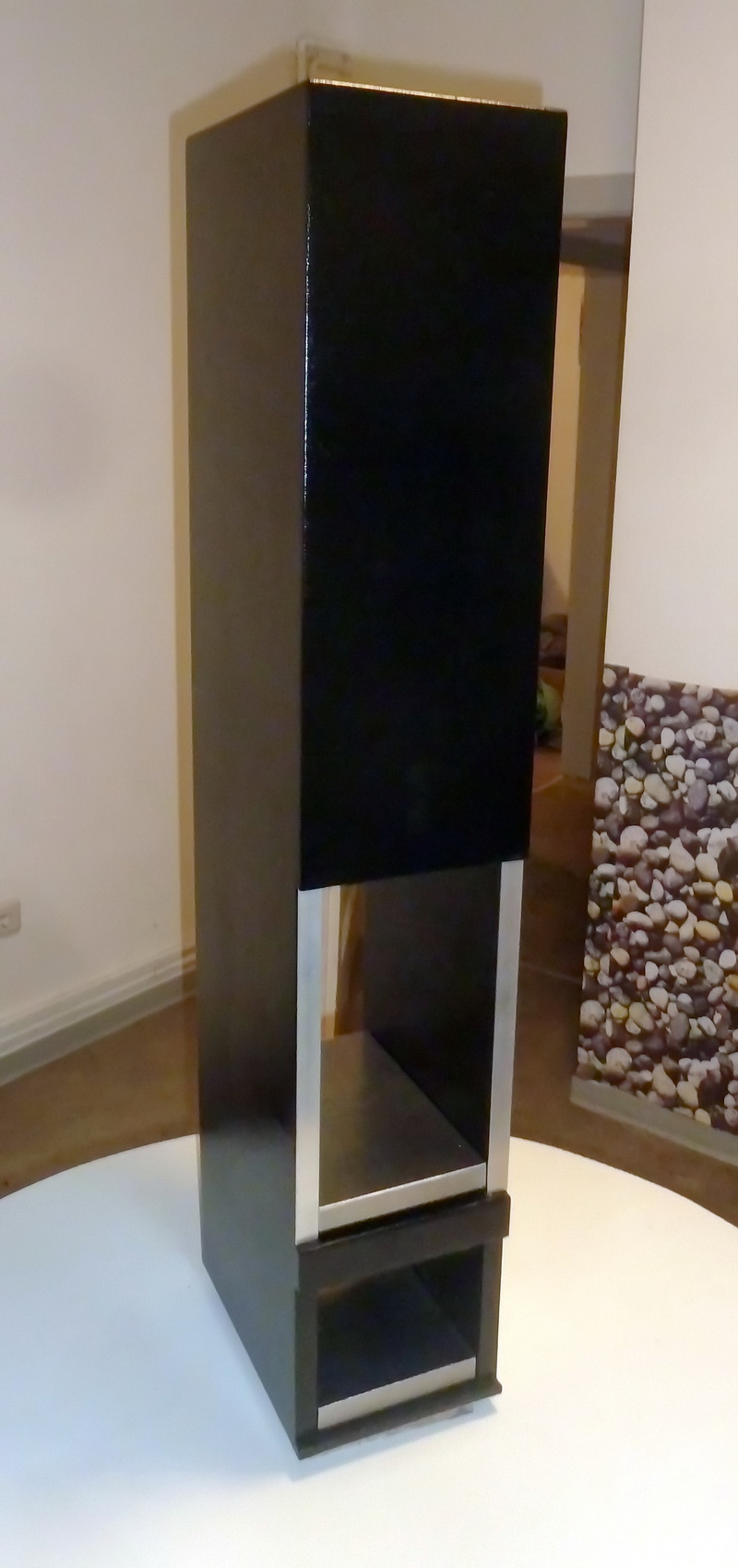

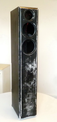

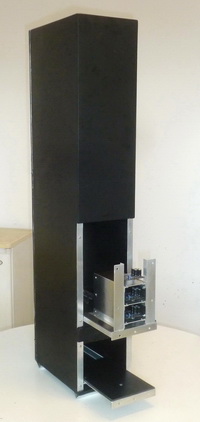

Hey People,
this will be the Home for three O.S. LM3886. The Problem atm is the lack of a Router for the Chassis-Seatings (what is the right Word?) in the Frontplate.
The PSU will be placed in the lower Compartment, the Amps in the upper One. All Electronics will be mounted on Aluminium Plates which will be screwed on Drawer-Rails for easy Access. Both Compartments get thick 8mm Aluminium Backplates, of which the upper One will be cooling the Amps.

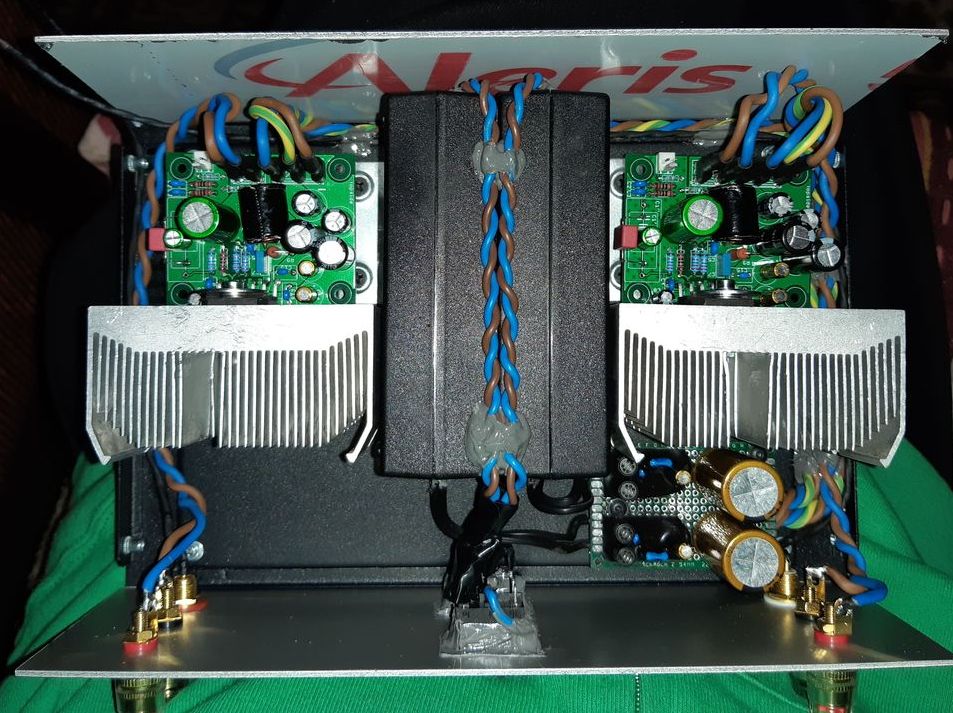

The smps are 2x24V (in series) and the linear one is 2x21V.
The hottest temp after running 2 hours, as measured by a Caterpillar Flir cam, was around 45 deg. Celsius.

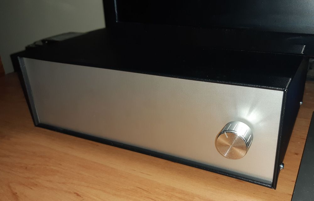

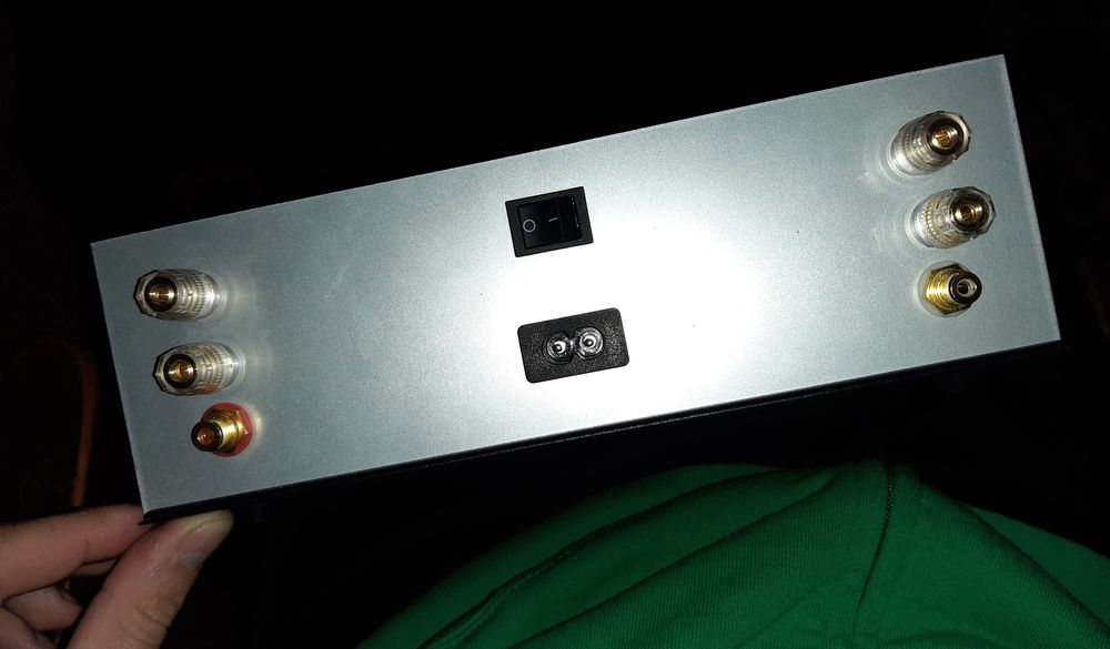

I decided it's worthy to put together a compact stereo and a 10K pot (conductive plastic) will be installed in the end. Hopefully, I' ll put some nice pictures one day
Here's my compact build using 2x24 SMPS in series with some extra filtering and 2x4700uF reservoirs. With the pot on input the amp performs good, I can't hear that hiss anymore. There is absolutely no noticeable noise at low levels. By now I've conected it only to a low sensytivity speakers and I'm happy with it.

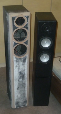

Hi Folks,
no Tools, no Room, no Brain, no Budget,
it goes on slowly ... .
Just small pics of Front & Back because of limited Bandwidth.
The Amps are about 20% done, more Parts will arrive in a few Days.
The Cover for the Amp Compartment will be 190 x 300 x 8mm Aluminium Plate and will also be cooling the Amps.
Many Thanks @ All who made this possible!

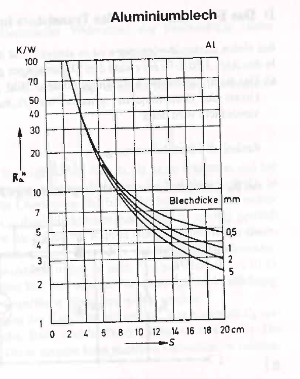

Attached you will find a graph for the thermal resistance of aluminium sheets (upper right graph).The Cover for the Amp Compartment will be 190 x 300 x 8mm Aluminium Plate and will also be cooling the Amps.
x-axis is length&width of the aluminium square in [cm].
Rth on the y-axis.
"Blechdicke" is the thickness of the sheet in [mm].
When used in a horizontal orientation multiply Rth with factor 1.2.
That said I guess we don´t have to be that scientific about it and you´ll be more than alright if there is a path for the hot air.
