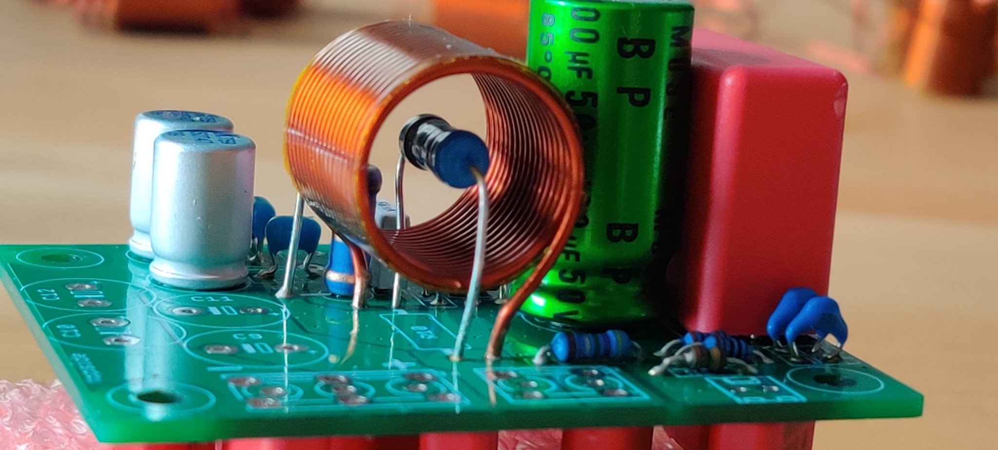

thanks for the explanation. I looked at a few other amplifier schematics and you are correct, they seem to all use a bi-polar cap, what confused me is most use a film capacitor, which by nature is bi-polar. I think in this design, the electrolytic is used strictly because of space restrictions. Luckily I had a bi-polar sitting around, so I installed that in place of the one I ordered. I will start with some testing on the protection board, before placing it into full-time use.

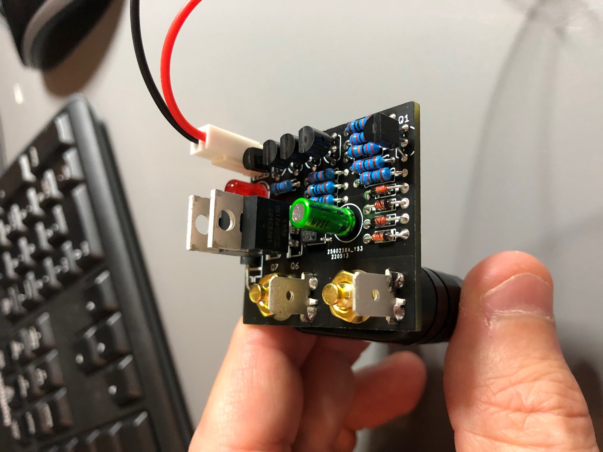

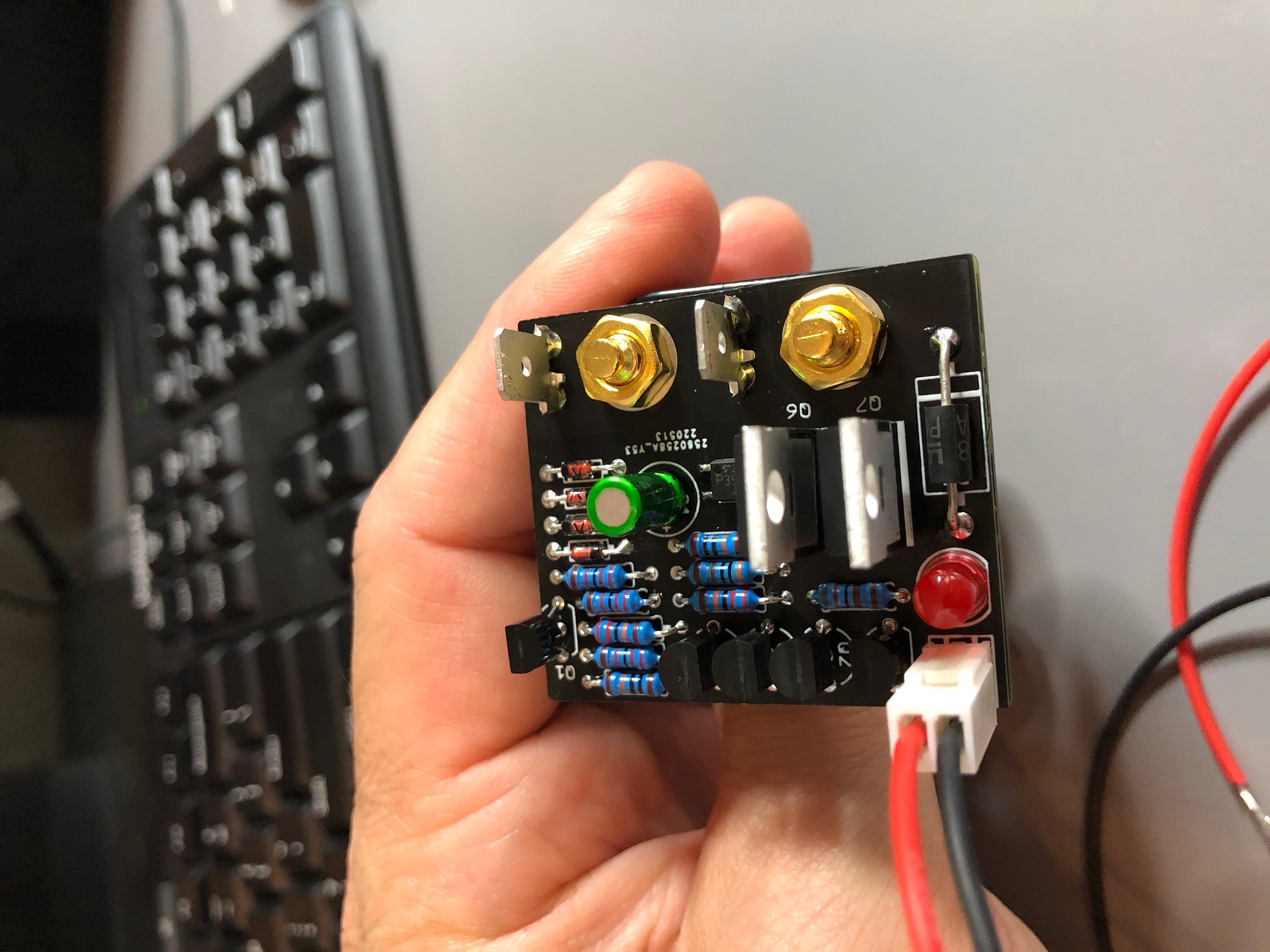

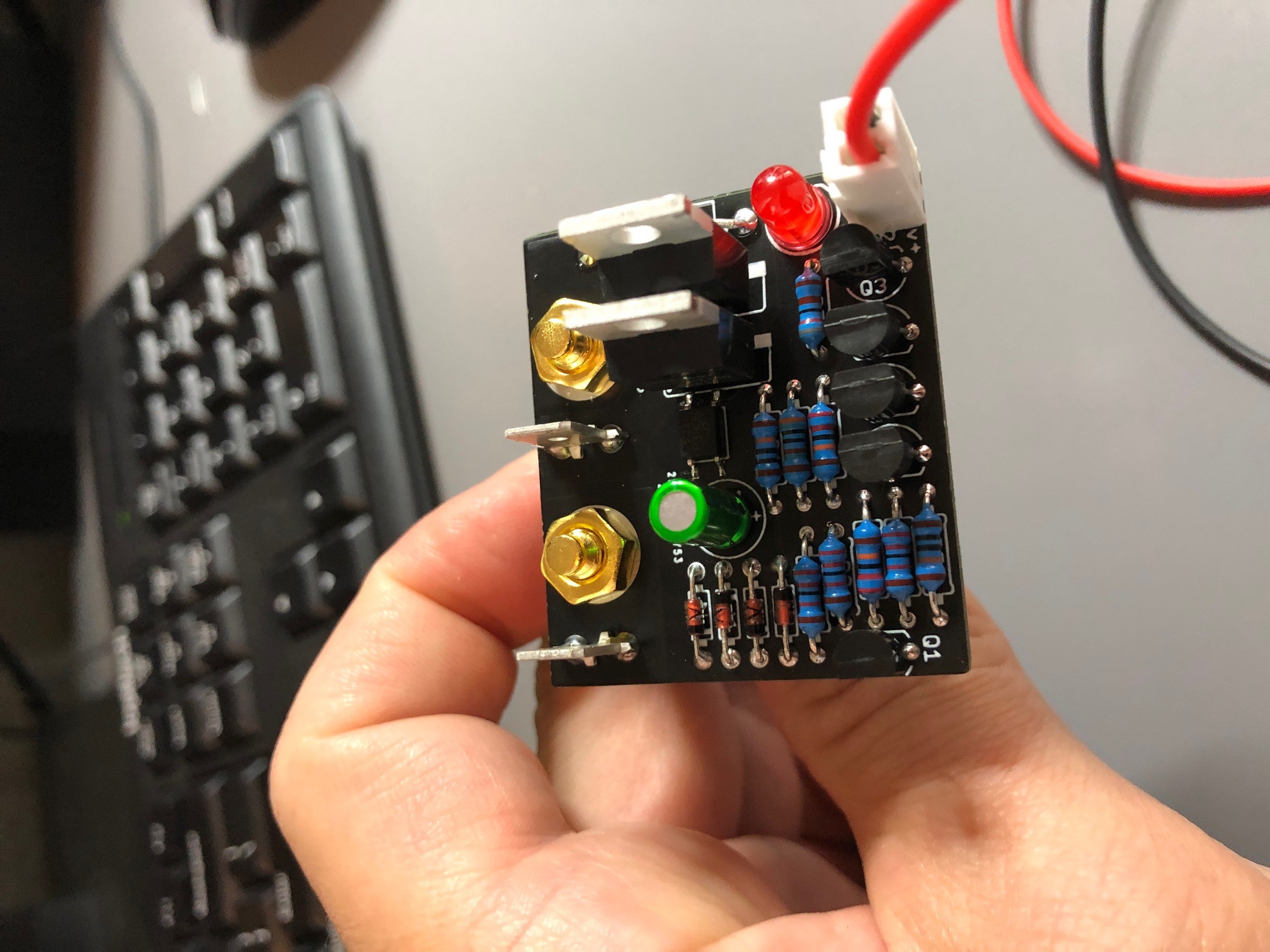

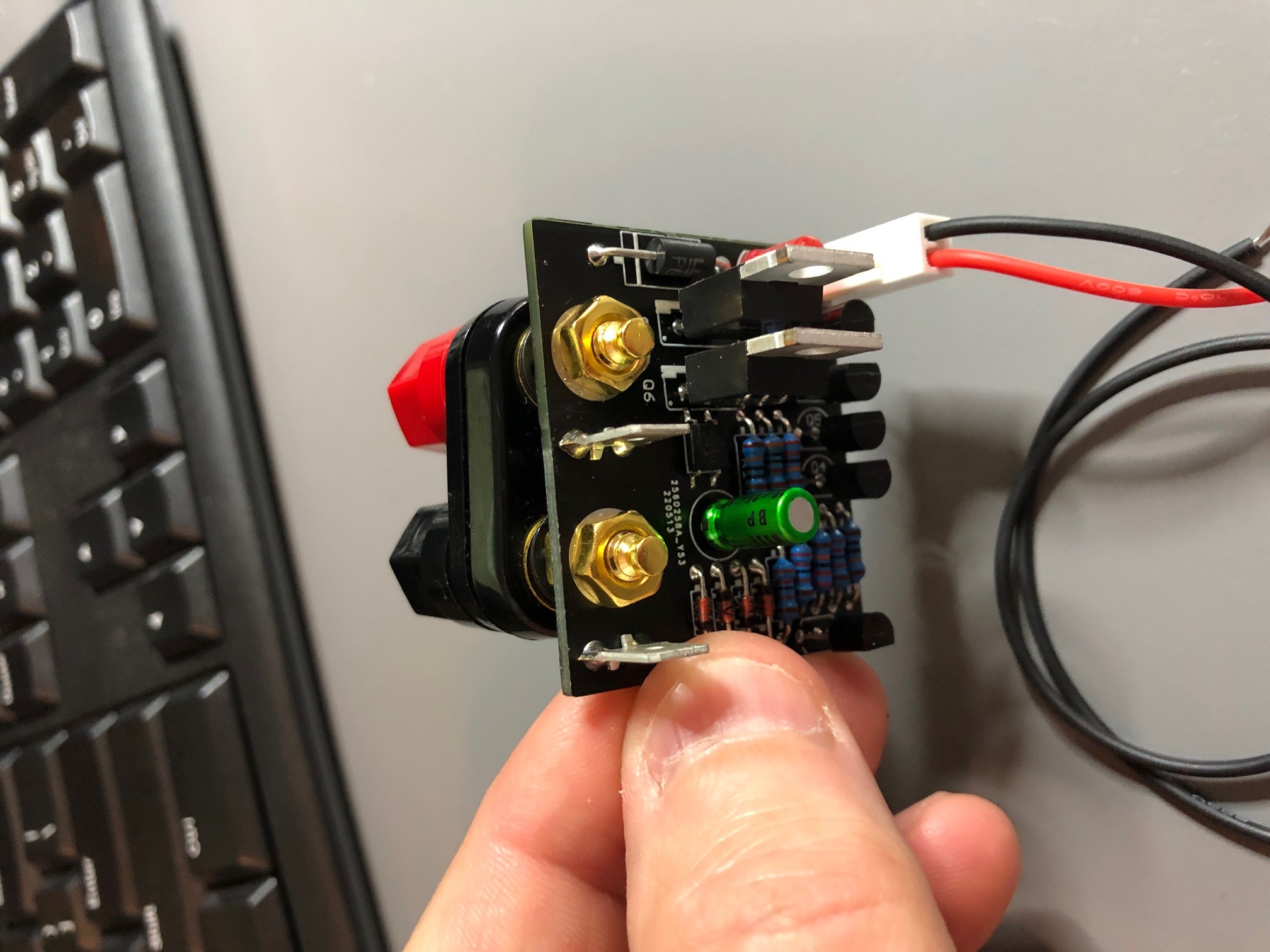

Has anyone built and used this protection circuit in a build? I build one (only substitution on BOM is MPS42/92 for the BC546/556 - reversed orientation on board), but when I power up it seems to be working in the opposite of what I think should be normal operation - no delay coming on and about a 2-3 second delay turning off. The other issue is I've tried to induce a DC to create a fault condition - nothing happens??? I have tried with DC power voltage to the board of 12-30V and inducing DC on the output from 1.5-9.5Vdc. I get no disconnect from the input to outputs on the board and no fault indicator LED lights.

So I guess this means no one has made this protection board and got it working? I replaced the substituted A42/A92 for the spec'd 546/5556 and continues to come on immediately, delayed shut off and has not trigger to disconnect either connection to the speaker and the LED does not light. Would appreciate some assistance, anything to try, since I went to the trouble of ordering boards and have a build I was planning these speaker protection. for.

Unsure if I had a bad solder joint, or if it was all from a faulty LED, but after re-working the solder connections on most of the board and replacing the LED - the protection board is working on my test bench. I have tested with supply voltage of 12-31vDC, while introducing DC on the outputs of 1.5-9.5vDC and it works without any issues. Will take some time to re-work the wiring in my amplifier I had these planned for, I put in other protection boards while I was working through these issues.
