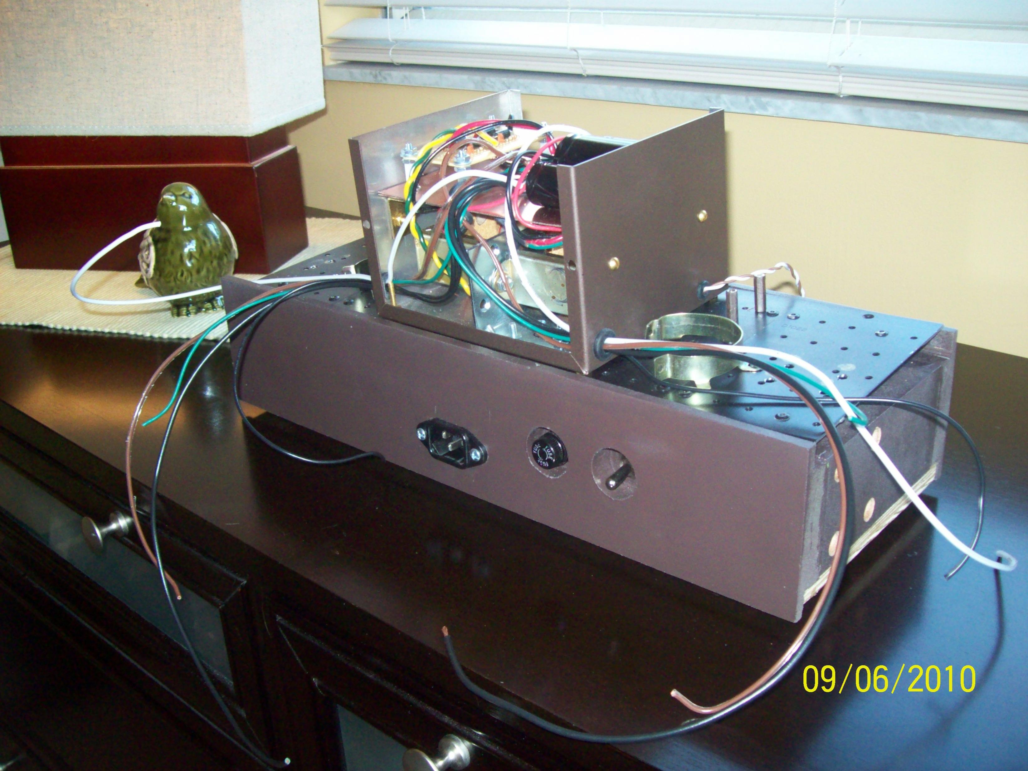

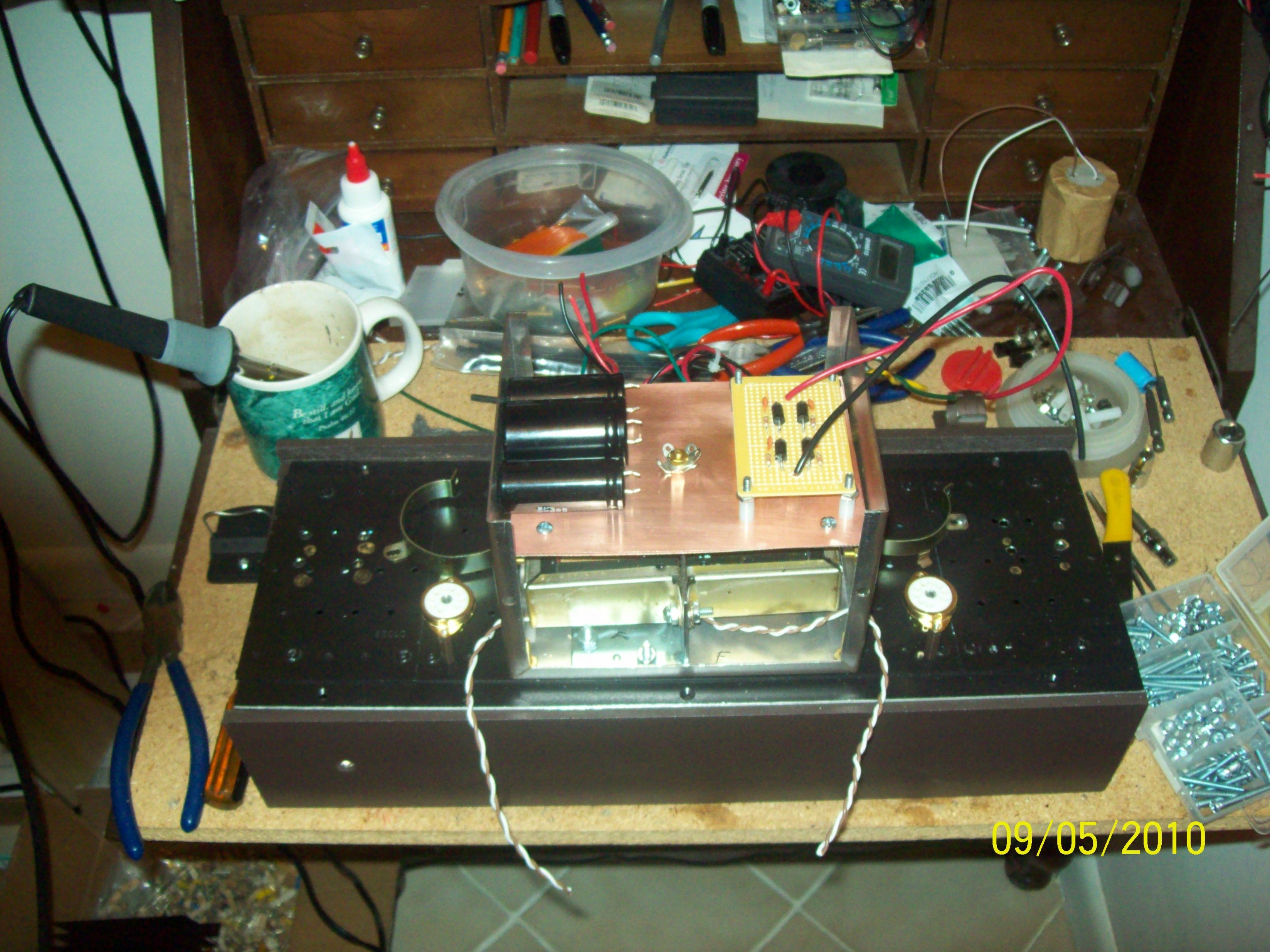

Good evening. This amplifier it seems, is taking forever. Working long hours leaves not much fun time..........but what are you gonna do?
PS is almost done, need to fabricate the back panel, match the transistors, build the amps on the heatsinks then maybe give it a listen. After all that I hope she don't blow both literally and figuratively

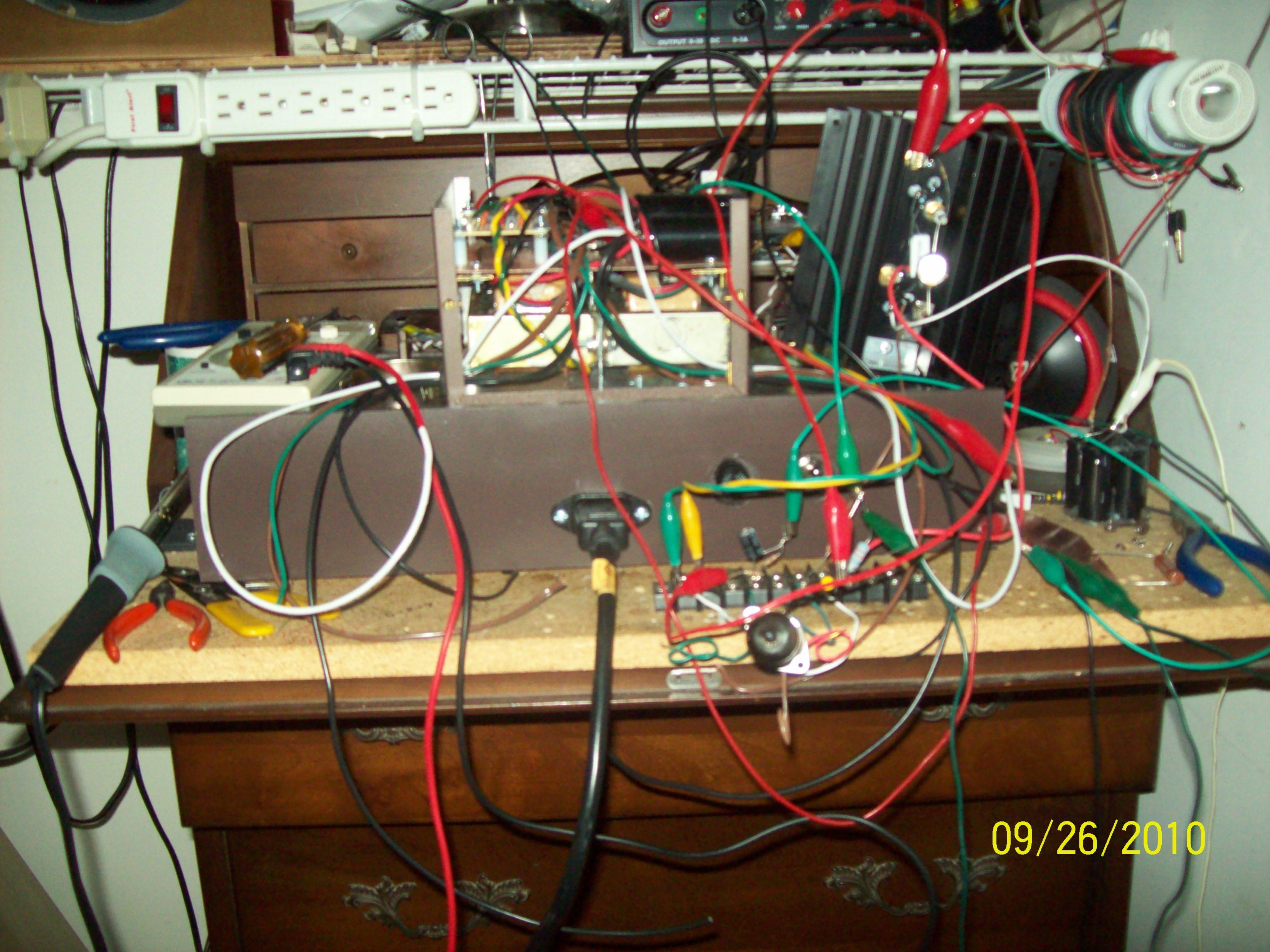

One clip lead short........

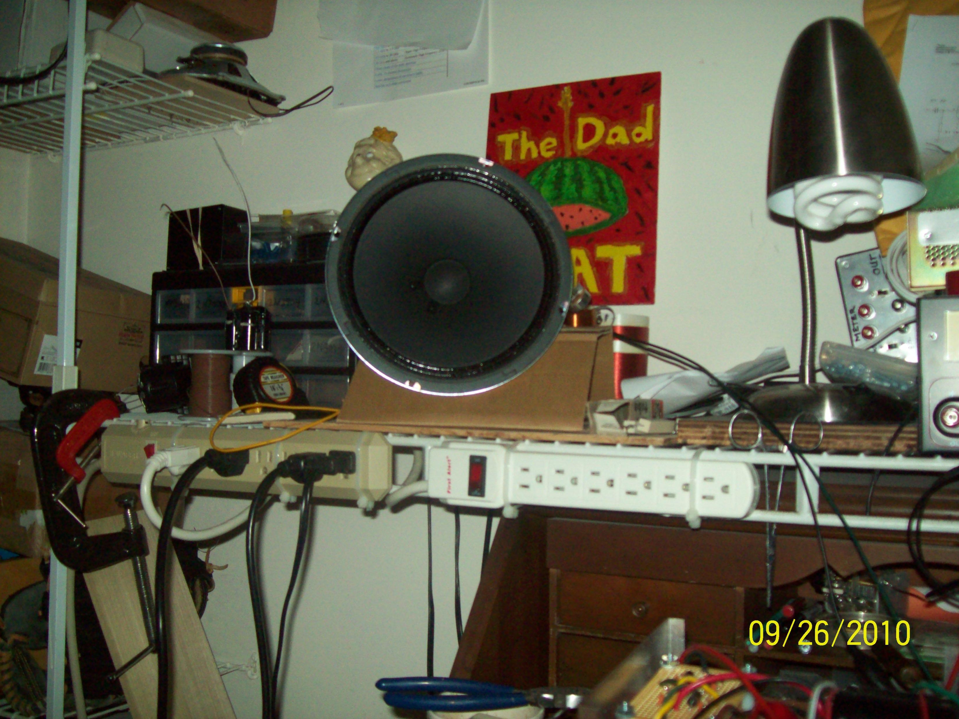

Hello,
The rats nest is the final tweaking before finally assembling the amp. One amp is assembled on the heatsink with the driving tube lashed up and swinging in the breeze. I have all of my sources connected in the living room, so used a Grundig radio as a music source. There is a Bogen S86 hooked up. It has an LCR filter in series, to tame the middle. I could rattle on about the sound, but all I can say is it delivers the type of sound I like. Whether or not that is hi or fi or hifi I can't really say. It is very clear sound, even with this type of input and the bass is there, in spite of the Bogen. I expect it will be even better with better sources. I have spent the weekend studying the active load part of the circuit, and must confess, still don't understand it, but what the hey, it works. I had to trim the 4.75K resistor to 2.2K, to bring the midpoint to 26 volts (VCC is 49VDC). I may be able to procure the scope I need in a couple of weeks, so if I do will look at waveforms and post.
Have a good week,
Terry

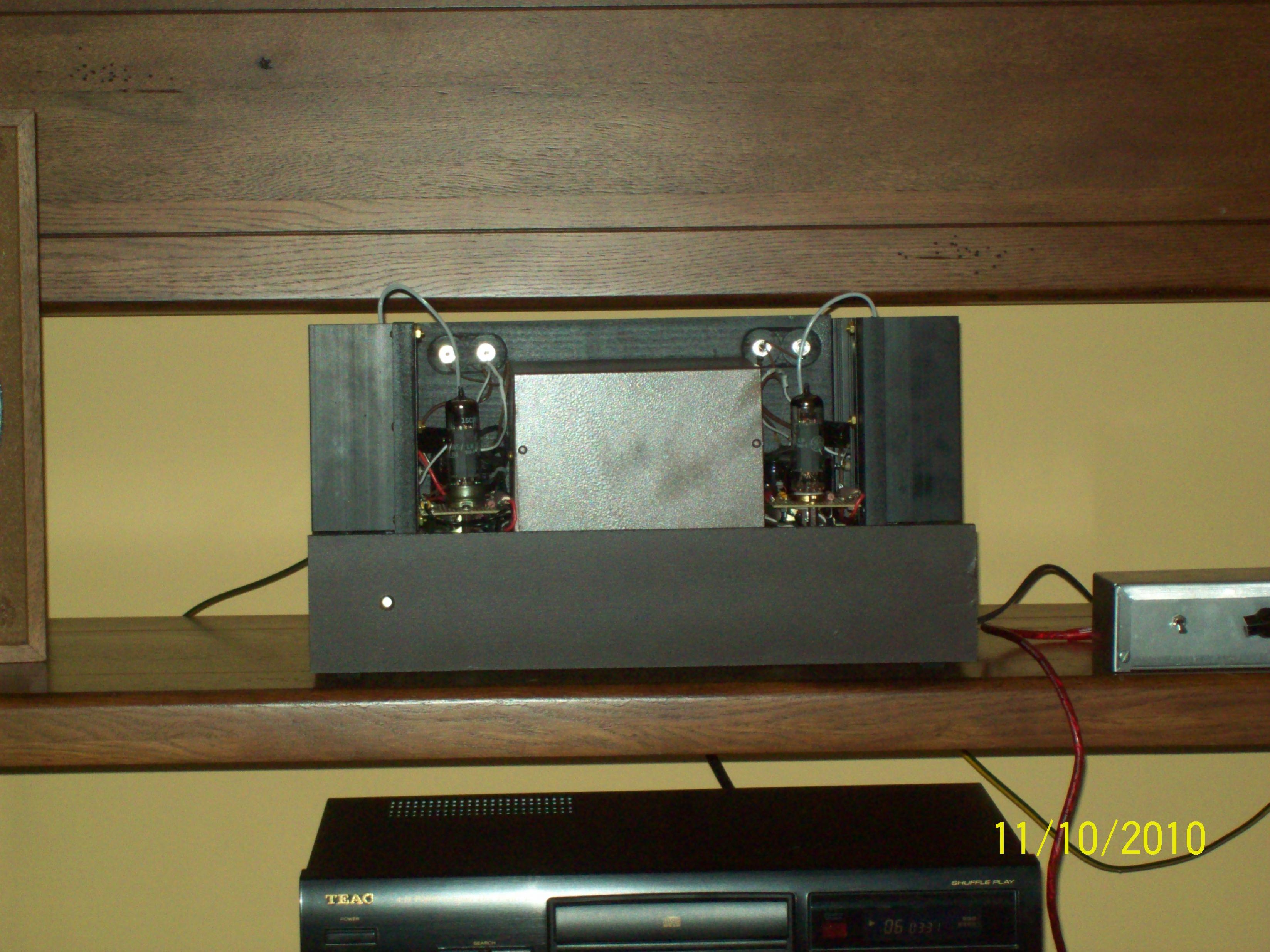

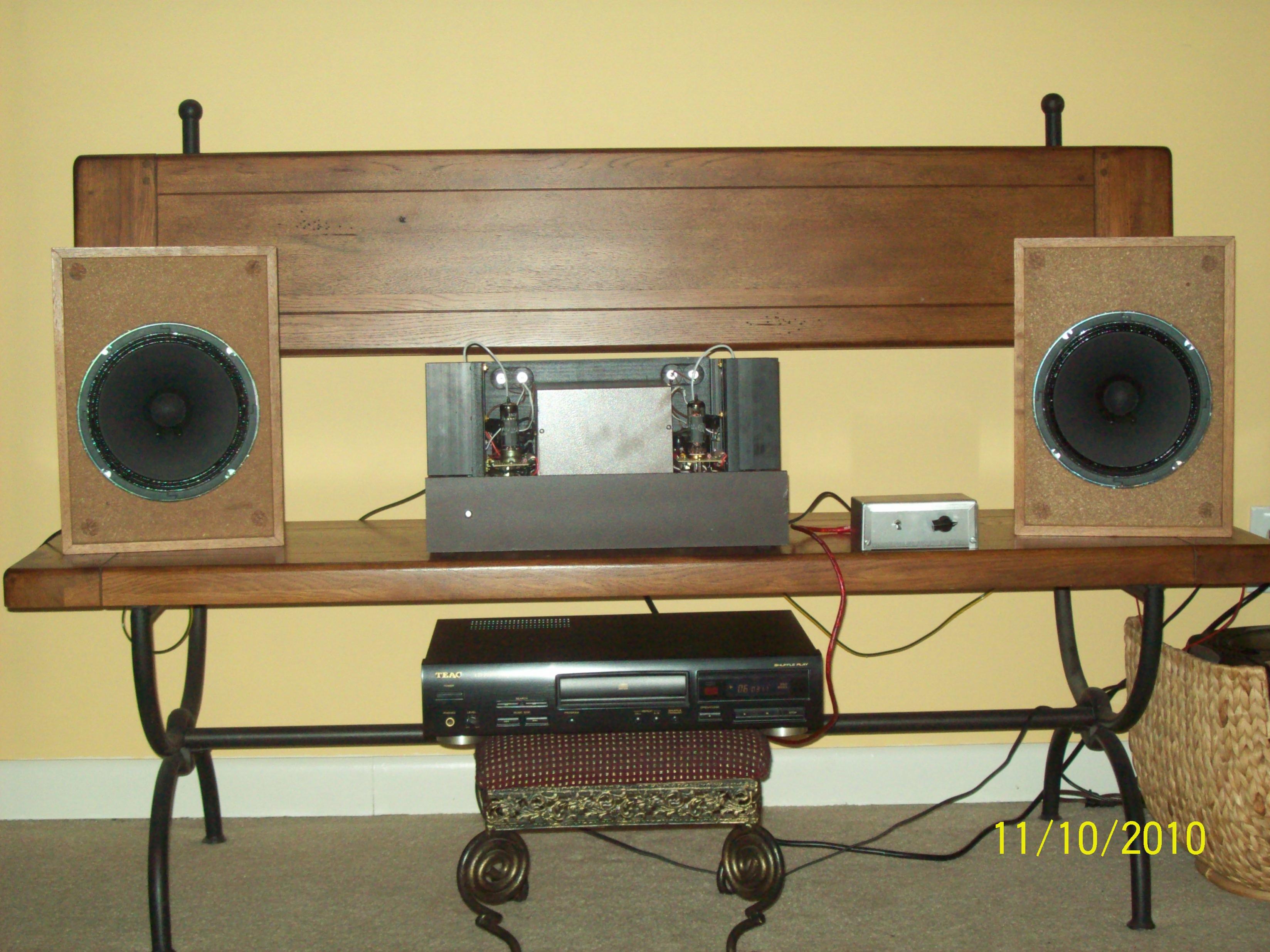

Good evening,
This amplifier is up and working. It is sounding wonderful with no hum or anything at all. The oscilloscope deal fell through, so sorry, no scope pics of waveforms, but after having enjoyed this amp for a couple of days, I honestly can't see the point in looking at waveforms, my ears say "who cares!". Dave Brubeck-Time Further Out is playing, and it is a joy.
Have to say this is a tribute to the late Sir Douglas Hall. If he was living I'd invite him over for a listen. Nelson Pass also has to be acknowledged for the design of the Aleph current sources. I will pat myself on the back for persistence
The amp is playing through a pair of Bogen S-86, which have some plumber's putty around the basket and some rubber plus Gorilla tape back there. One coat of Damar on dustcap and a little beyond, operating open baffle........they will get me by. This amp actually has WAF.....wow that's never happened before....and she is willing to allow me to purchase some Visiton B200s.....now that's progress.
I am working on the schematic which has some small revisions, and will post soon. Tonight the lights will go low and I will listen to Apocalypse-Mahavishnu Orchestra.............
