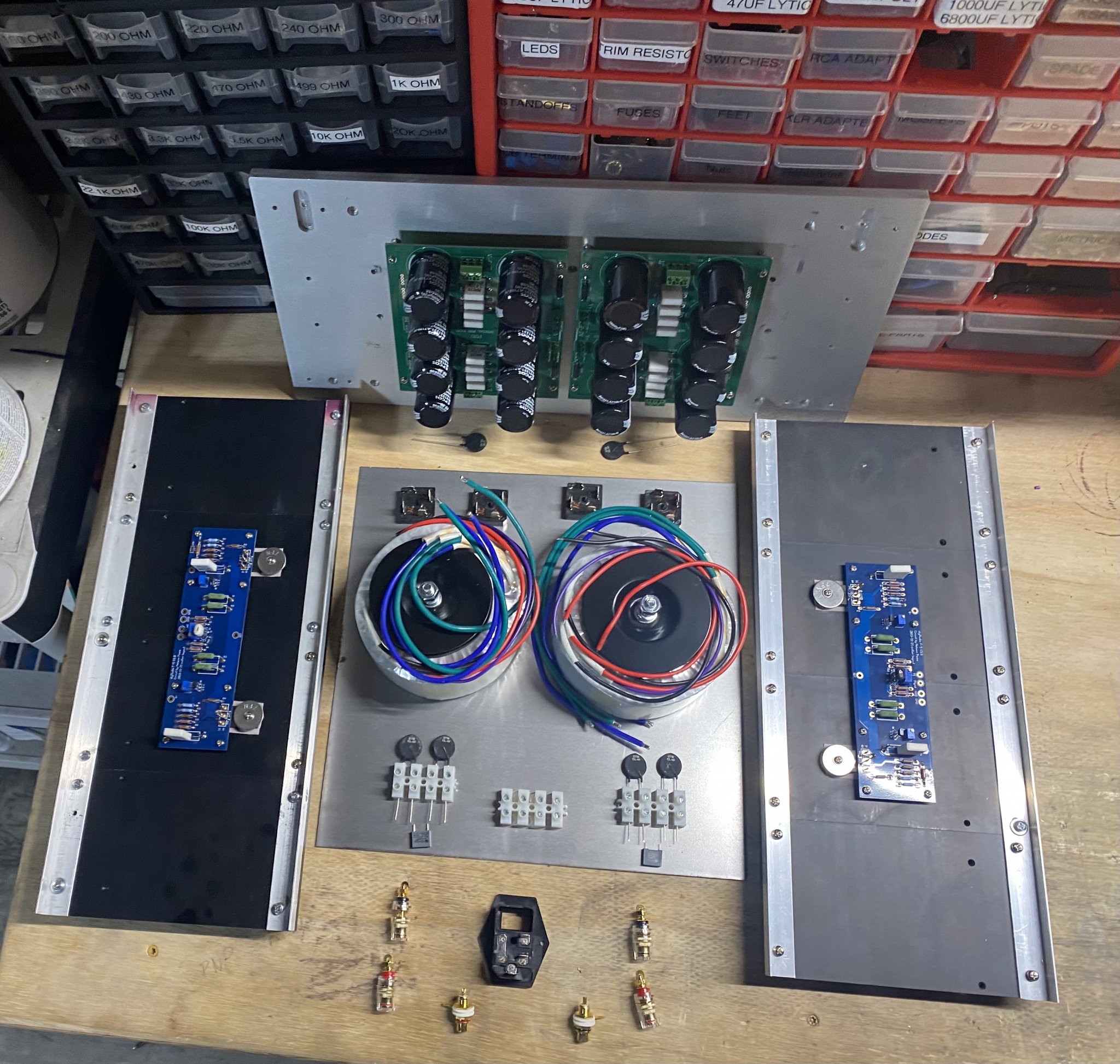

About to tackle an F5 dual mono amplifier. I did some research but wanted to clarify I will have the unit wired correctly:
  • 1 IEC
  • 2 fuses (one per transformer)
  • 2 Transformers (200VA or higher)
  • 2 PSU boards with 60,000uf filter caps @ 35V
  • 2 F5 boards
- RCA wires will be floating.
The question I have is the amount of CL-60's I will need. I understand I should double everything (above).
  • I know I should have one CL-60 per PSU board from ground then attached to the chassis.
  • Do I have just one on the hot and one on the neutral? Or do I need a pair of CL-60 per transformer?
  • The Safety capacitor, just one across the hot/neutral?
So, 4 CL-60 required or 6 CL-60 required?
Thanks!

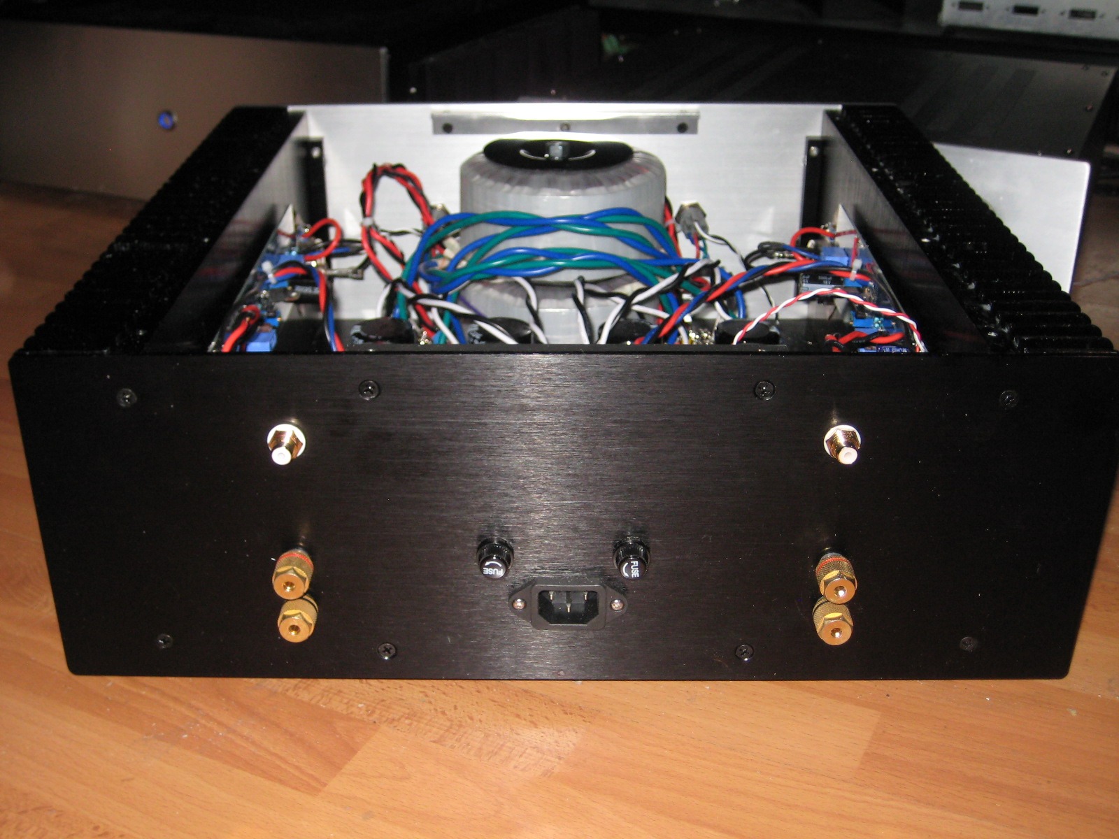

Joined 2012
I did that with one of my amplifiers (not a F5). I went full dual mono, with each channel fully independent. Only the IEC connector and AC cord were shared. Each channel had its own fuse, switch, and complete power supply, including each channel having its own thermistor ground lift.
This is diy, so excess is best! 🤡 :D
6L6
Moderator
Joined 2010
PSU boards on the faceplate makes the entire wiring looped around the transformers... making things much more susceptible to hum. I’d put the transformers up front.
You have one power cord going to the amp, so use one fuse. On the live, before the switch. As electrical safety requires.
Keep in mind that for some European countries (eg, Germany), you can plug the power cable into the wall socket in two ways, rotated by 180 degrees, so you can not tell which connection is live and which is neutral.
This is how I have the amp laid out and unfortunately I already had the boards mounted to faceplate. It’s a 5U faceplate but the amp is going to be 16 inches deep so I can have the transformers close to the front.
The bottom plate is 12 inches but I’m going to add some perforated sheet metal strips to fill out the bottom for more airflow.
can I get by with this layout? Or move things around?
