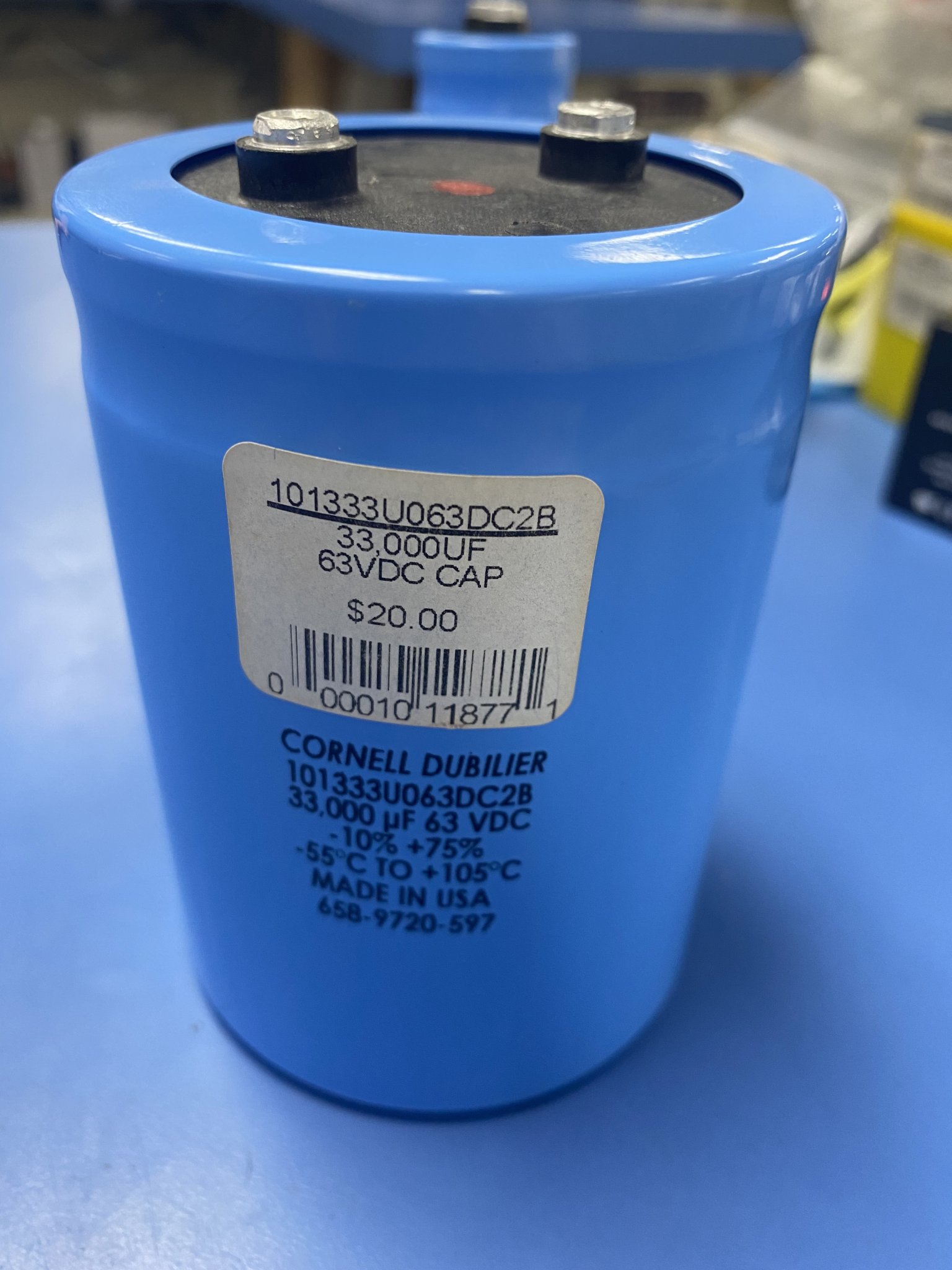

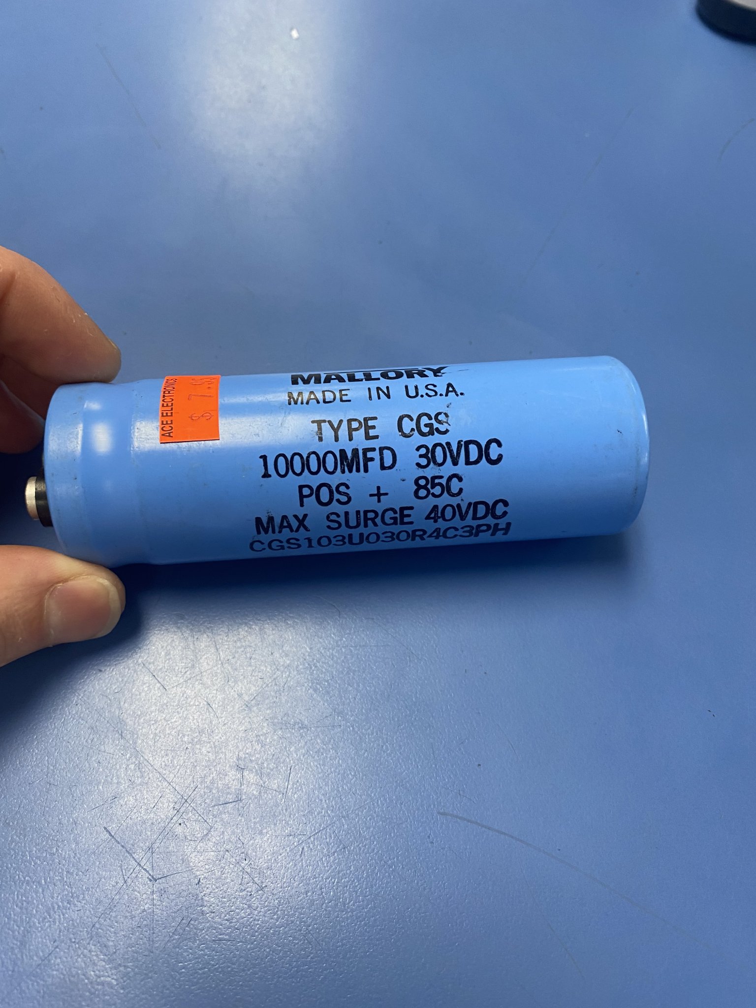

Wanted to get some feedback if these capacitors could work on a pass build.
A local electronics store has them listed at $20 each (for the large ones) but said I could have them for $12 and I could take 4 home for free to try out first. The smaller 10k uf ones are $7 and I’m sure I could get them for $4.
any idea of these would work without me needing to test/charge them first?
they have a lot of each of them… I was thinking of trying the 33,000uf caps first (4 total).
