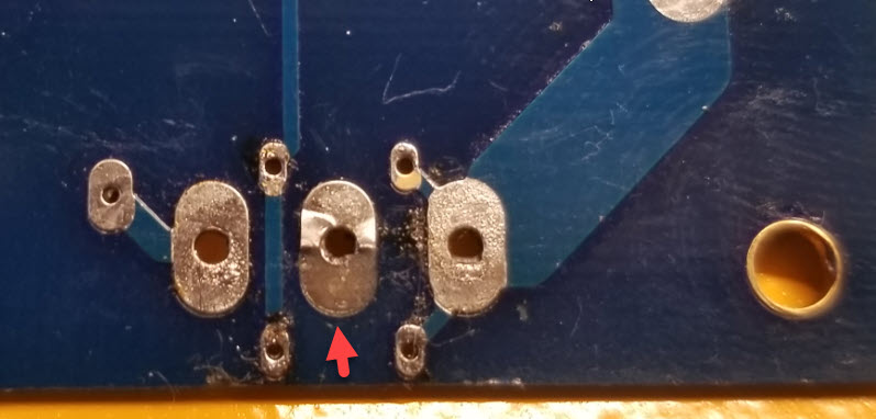

I removed all the parts from the circuit board, but as this was the third time for the mosfets see photo for damage done. I assume this means the board is toast?

That board will still work. Just check that the center pin has continuity with speaker out/other mosfet center pin after you solder it in. Or you could jumper between center pin and "Out" with wire.
But is it a good idea to use? I don't know. A lot of current flows through there. Also, I think what you need is the least amount of potential problem variables. If you know what I mean.
Also, when removing mosfets it's better to cut the pins and then desolder them one by one if you are not going to use the mosfets again, if you didn't do that. It helps avoid situations like this.

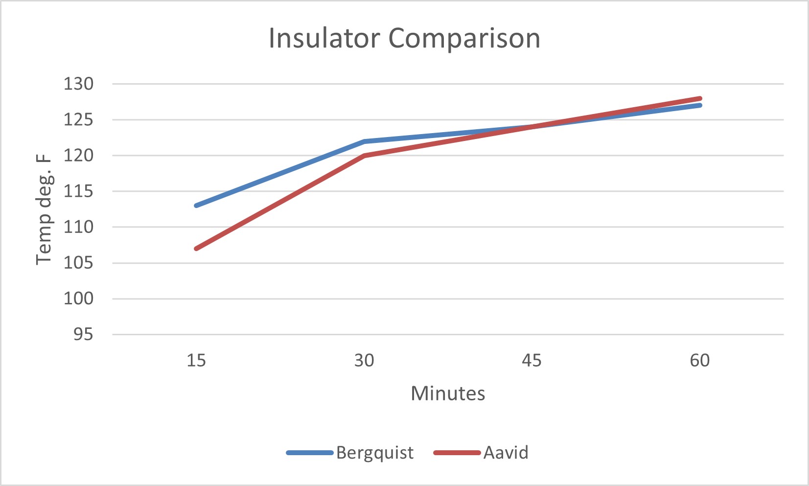

Hey Eric, I installed these pads yesterday using Chemtronics CW7250 grease and took heatsink temp readings every 15 minutes from startup. This is what I found when comparing to the Bergquist - the result was the opposite of what I expected. I wonder why heat transfer would be slower at startup?

It's a guess and only a guess, but it could simply be the time that it takes for the actual pad / insulator to reach its equilibrium and transfer heat from the output device to the heatsink. Root cause / explanation could potentially be the characteristics of the insulator itself and/or the contact between the output device and the Aavid insulator and to the heatsink. Did you use thermal paste between both the output device and the insulator along with between the insulator and the heatsink? I don't know the thermal characteristics of a thin layer of paste, but in some applications, if it's too thick or too thin it can affect thermals.
It would be very interesting (not that I'm suggesting that you take the additional time) to see the output device temps overlaid on that graph.

Yes a thin layer of paste on both sides of the insulator. I may just re-do the test and check the MOSFET temps.

This is a curious result, Mark. When I did my original comparison of thermal interface materials, I didn't bother with interim time period measurements. I just waited for a full hour and took my readings.
Like ItsAllInMyHead, I'm wondering if this is a function of the thickness of the materials and the time required to heat them up before they begin passing the heat along. Dunno? The Aavid ceramic pads from Mouser are thick - something like 2mm. You can get cheaper ones from China on ebay, these seem to be 1mm thick. I never compared the two thicknesses.

Yes, so thick I had to loosen the lower mounting screws on the boards or they would have bent them at the corners. Perhaps more heat is going out the top? I don't know.
