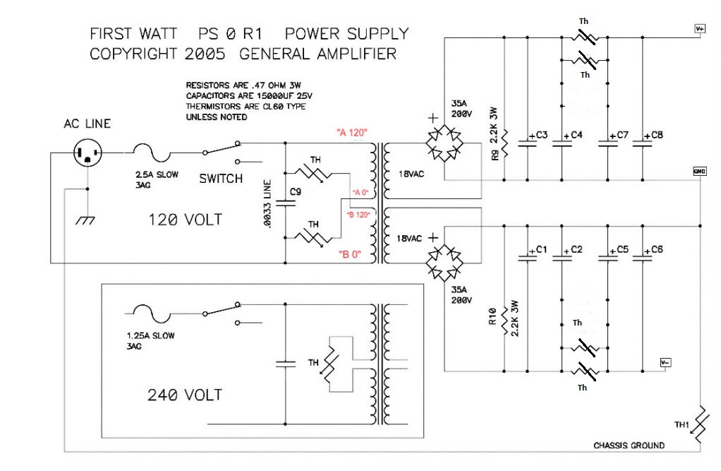

Speaking about power supplies...in order to prevent inrush current of charging the caps, would the thermistor between two banks of caps be better? Perhaps CL-60 has too high resistance, may be CL-11? Would this work?
