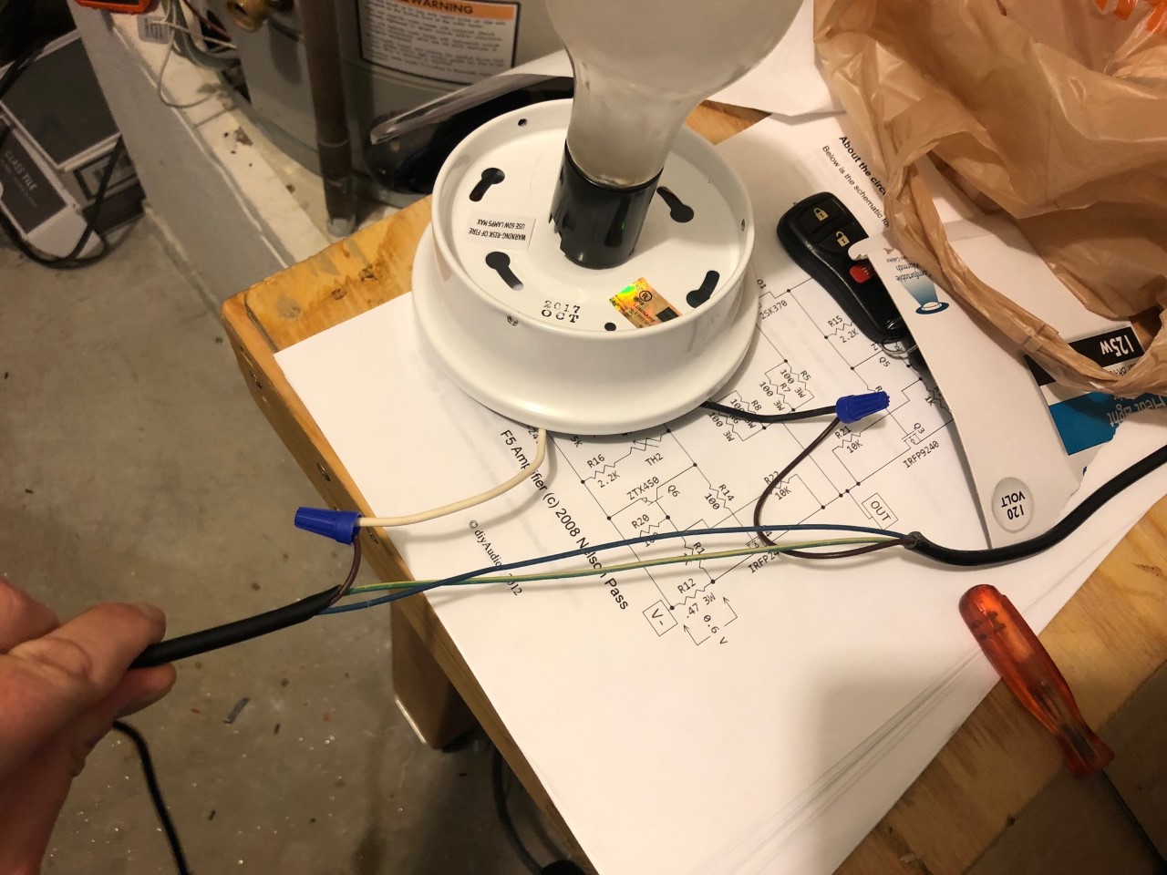

I put together a bulb limiter using the diagram in the beginning of the post. Here is a picture. I tested it on low power devices and it worked fine but the bulb didn't light up. I tested it on my computer which draws a ton of power and the computer would fail to post and the bulb would just flash on and off while the computer repeatedly failed to post, so i have no idea if it's working properly.
When I used it on the amp with one channel connected, the bulb lights up and stays the exact same brightness which is unlike either video previously posted. It looks exactly like a fully lit bulb. I tried both channels and they both do the same thing.
Here is a video - YouTube
The video makes it appear to be a flash but it's just the camera adjusting the exposure. If I keep it on for a minute it stays exactly the same.
Is the bulb limiter working right and do I have a short?

Are you sure the amp is not biased up? You sure your trimpots are set to minimum? If the amp is biased up it will draw current even if there is no short.
Your response helped me figure it out. I fell for the “turn the pots counter-clockwise” trick in the manual despite a previous post mentioning to ignore it.
I measured R7 and R8 on both channels and they were pulling current. I turned them clockwise until they all went back to zero and the bulb turned off.
I guess that’s a good sign that it’s working like it’s supposd to and I’ve regained a bit of confidence.

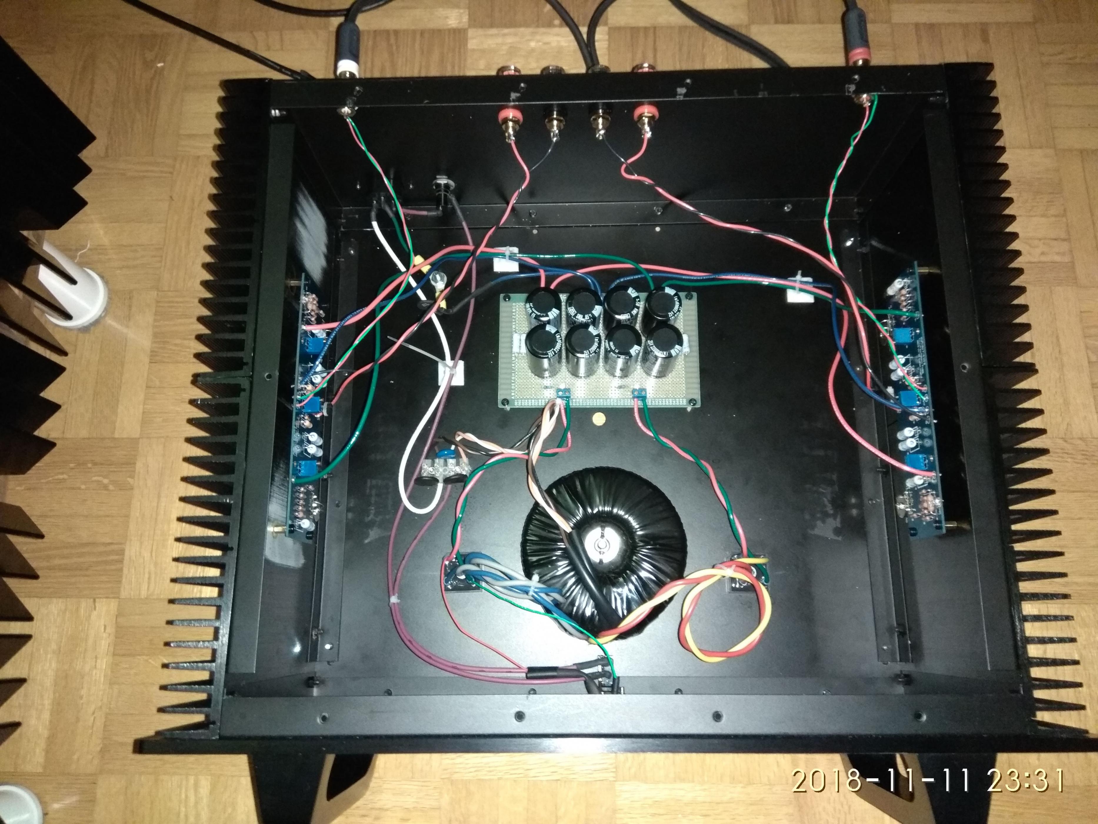

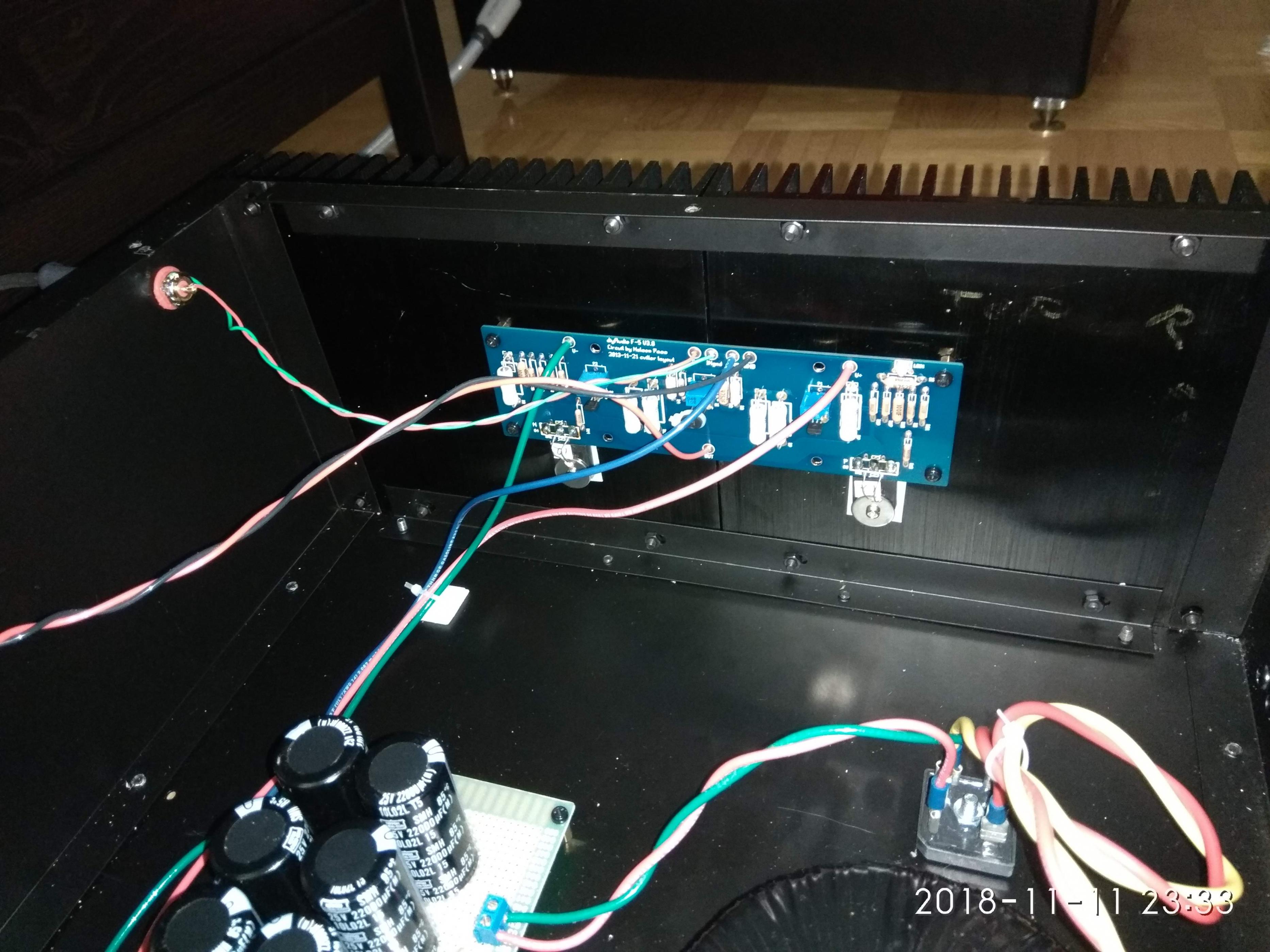

Hey Dennis, you should know better! We need pictures of the insides!
Congratulations! Are you planning on working your way back down? F4 next?
Hi Twitchie,
Just took a couple pics to show it's not an empty box.
I did an F4 a couple of years ago: https://www.diyaudio.com/forums/pass-labs/166784-pictures-diy-pass-amplifier-377.html#post4906362
The transformer in the F5 is a Plitron from your GB a number of years ago.
Dennis

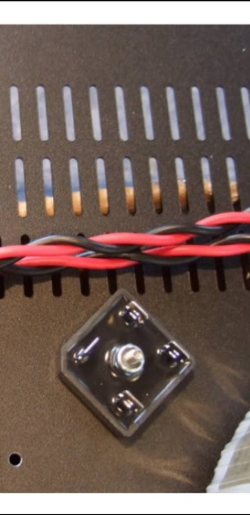

What is the proper name for this terminal block joiner connector thingo with the male spades?
It's a Bridge Rectifier.
Diode bridge - Wikipedia
So it's like a Non Return Valve in plumbing. Current can only go one way through.
