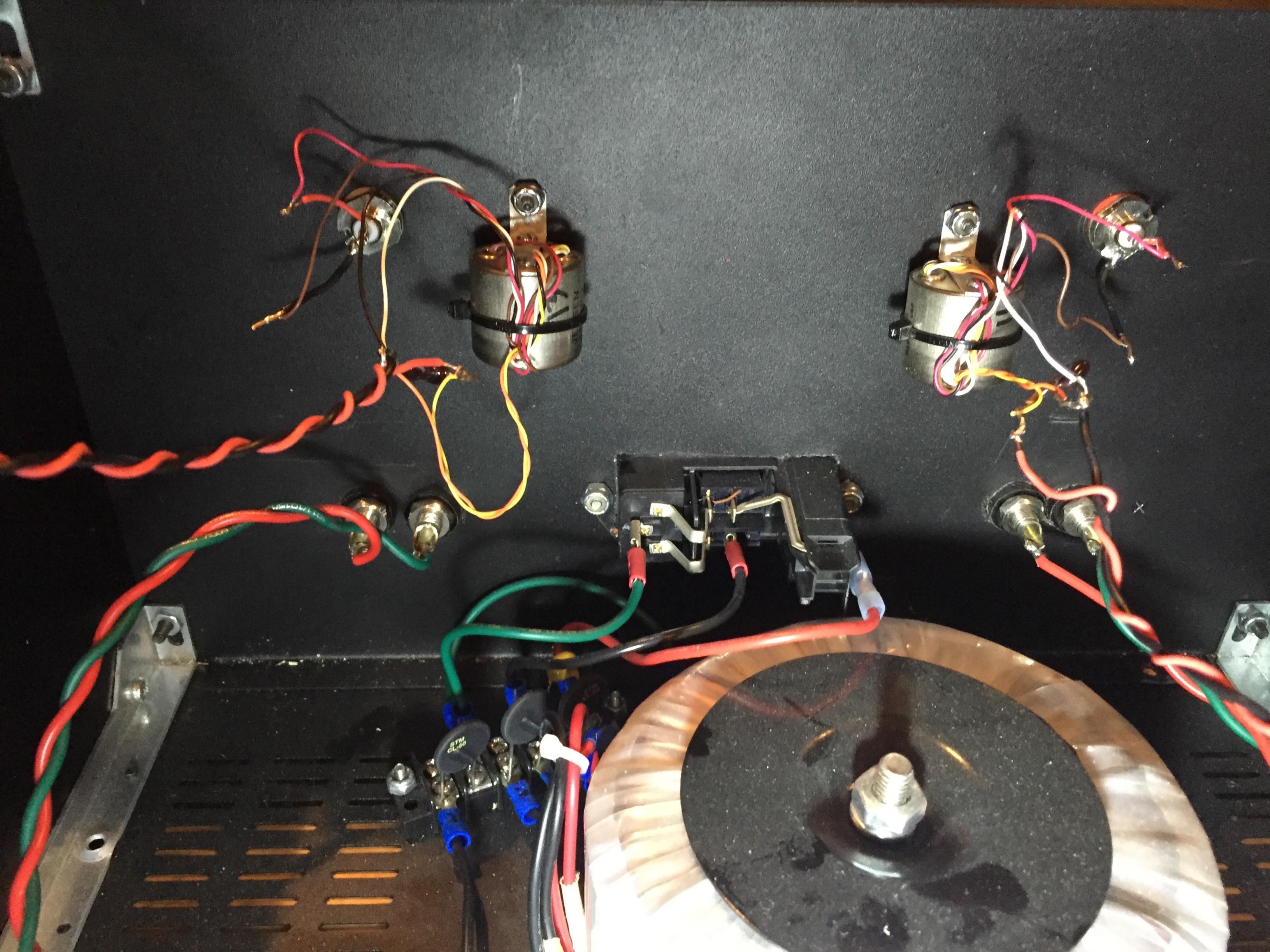

Isolation Transformer
I've been trying to solve a problem with my F5 (no inputs connected) having a slight hum with my ear a few inches away from the speaker. Also a louder hum with the BA-3FE and Pearl II connected (ground loop), which can be heard from the listening position. I've tried different ways of grounding with no success.
I installed two Jensen JT-11P-1 isolation transformers (Thanks vdi_nenna) on the inputs of the F5 and the system is quite as a church mouse. The F5 still has a slight hum with no input connected but when the inputs are connected it's silent.
No downside so far, I've only listened to a few songs but I can't tell any difference from before other than the dead quite background.
As you can see one transformer is higher than the other. I let my 7 year old son drill the holes in the chassis. It got away from him a little. Hey anything to get the kids involved, right?
